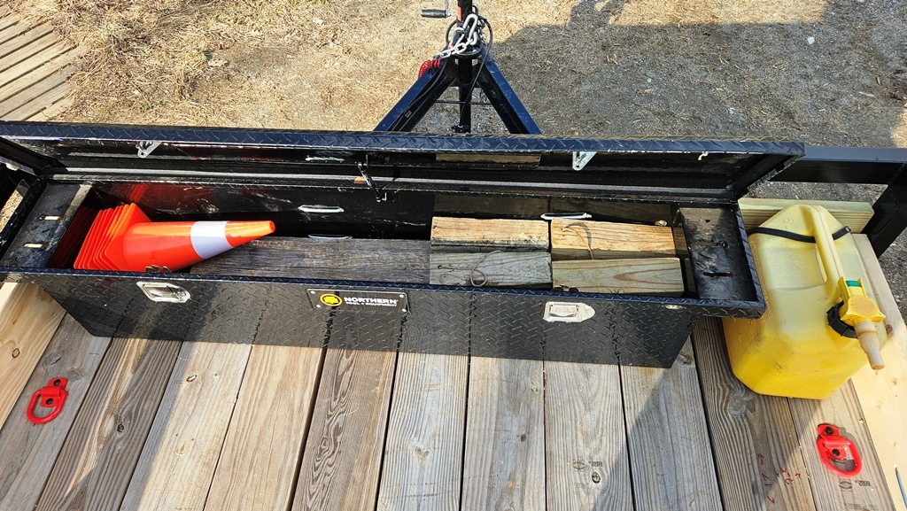

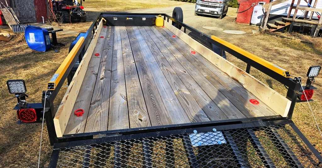

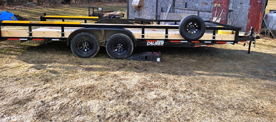

more trailer work.
2x8x10 (2 per side) on sides (leaves 4" from wood to rail for strap access if needed) and 2x10x8 on front for toolbox to bolt to.
need clearance between box back and mount location for lid opening, board need to be approx 1 inch lower than lid due to lid tilt when opening. thats why I didn't just bolt to the front uprights. plus the wood blocked stuff from flying out there under hard brake and gave me fuel can mount.
sides use 3" square ubolts, 24 of them....got crapload of M8x1.25 nylon lock nuts on the way to install to lock that stuff then will trim excess bolt length off.
tiedown rated 12k but would never put that much on them. they are well built but are only a 2 bolt hold down. so 8 installed.
toolbox (thin style) carry 8 15" safety cones, 2 4x4x12 chock sets, 2 2x6x4ft to stop gate scrub when load/unload (place under gate in line with tires) and 2 56" 2x8pt with bolts on end to hook into gate grate in case of sharp ramp angles causing attachment bind.
and fuel can attached with bungee cord to eyebolts.
fwd facing ambers at rear added and working, 1 set of led for reverse light added on rear not wired yet.
tomorrow will add middle and front reverse led lights and wire them and the rear rev leds up in month or 2 when stuff is dry.
but now trailer is all set to haul whatever and stuff won't fly out between open rails.
edit: clarified box mount stuff.
oh yeah, trailer is FOR the GC2400 and the GC2400 did move this a little bit today for access. so yeah, it fits topic :)
