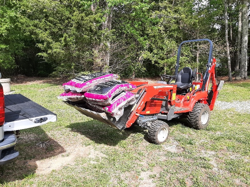

Worthy tip. Man, I'm hurting today because of those FEL connects (and I gotta go mow today, fargg)! I hurt my back a few days back, but was finally doing ok yesterday, so decided to clean up/dethatch my lawn. I took the loader off, hooked up the dethatcher, everything was going great. All done, so I was hooking the loader back on, struggling with those quick connects while bending over and all contorted...bam, re-injured my back.
I don't dismount my loader too often, but am strongly considering redoing that setup there. It would be easier to connect the lines if they were loose like for the backhoe, as opposed to connected to the bracket there.

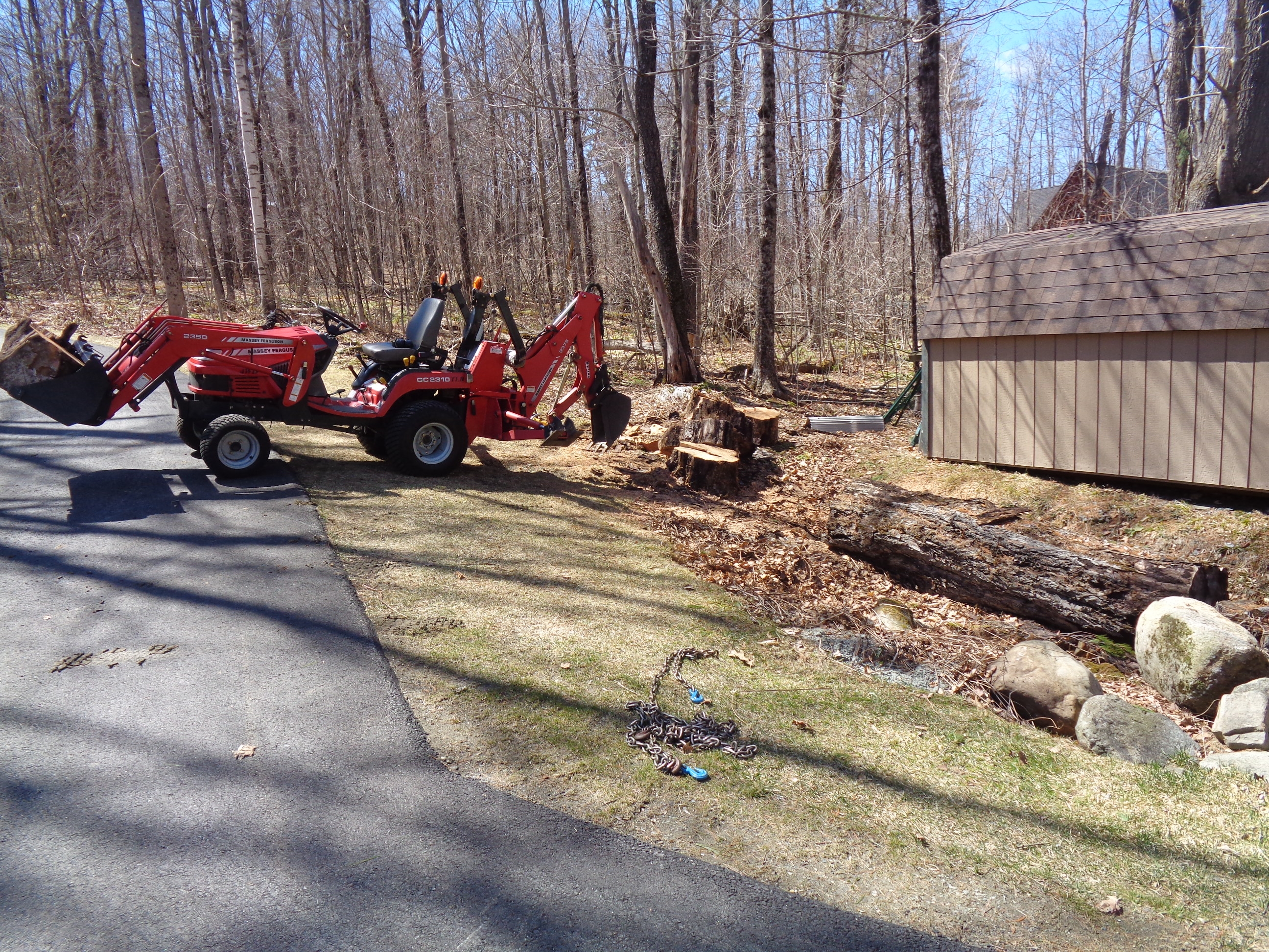

Speaking of which... My 2310 has completed its transformation from snow-blowing duty (finally!) to TLB set-up. Trying to get rid of a butternut log that's been sitting for 4 years. Man, that thing is HEAVY!! I'm having to cut from both sides with a chainsaw as much as I can, then use the tractor & a chain to roll it a bit so I can get to the other side to complete the cuts (about 14" thick). The log is about 30" in diameter.
Then use the BH to lift those cuts ("rounds" I think they're called) --about 150 lbs each-- to transport to a bank and roll 'em down. Hate to create my own "stump dump" like that, but there's already quite a few downed trees (quite old) there and our local landfill wants $110 EACH LOAD to dispose of them that way and I figure I'd have five loads in my little trailer before getting it all. No, thanks. Using a splitter to process for firewood? Good idea and that's what I wanted to do, but there's no way I can handle rounds that big.

PS: note the two rounds in the FEL.... found I needed that to keep the front wheels on the ground when lifting those cut-offs!
   / What have you done with/to your GC Series 2300, 2400, 1700 Tractor TODAY #2,718
We get that.
The burning question we are all wondering is, why are those chain hooks blue?
They haven't been used in a long time.:love:
   / What have you done with/to your GC Series 2300, 2400, 1700 Tractor TODAY #2,720
He'll I like it. Easy to find the hook. I paint stuff safety yellow all the time for this reason.
Meanwhile, had to talk myself into using my 2 month old GC for this purpose. Then I thought, why TF wouldn't I? 🤪 Saved my back!
