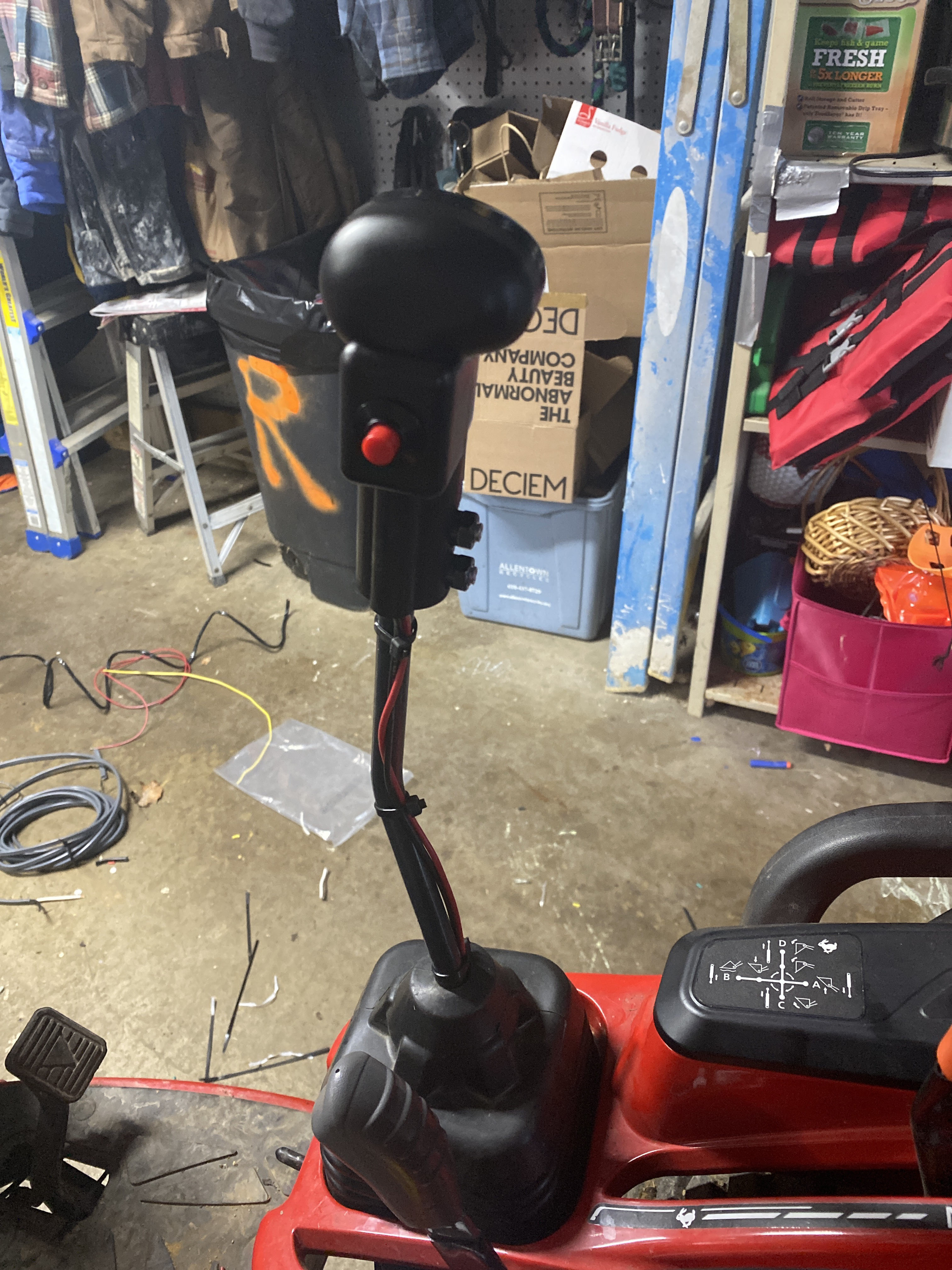

A funny,
I spent about 3 minutes turning the factory loader control knob, figuring it was threaded...
It’s friction fit...lol
You're not alone lol. Spent 20 seconds spinning that bad boy myself before I thought maybe just pull?!

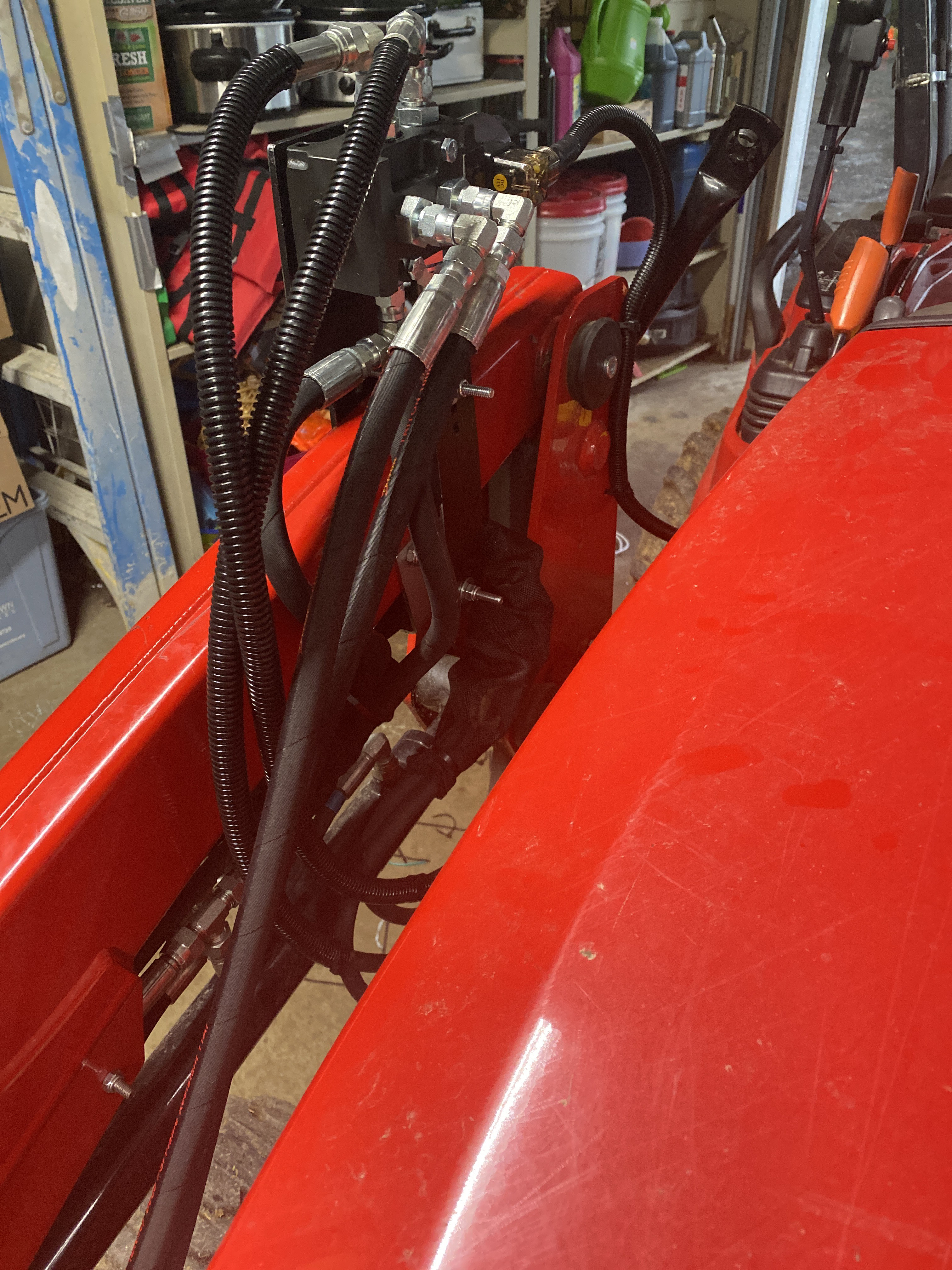

That should be a great tool addition to your tractor.

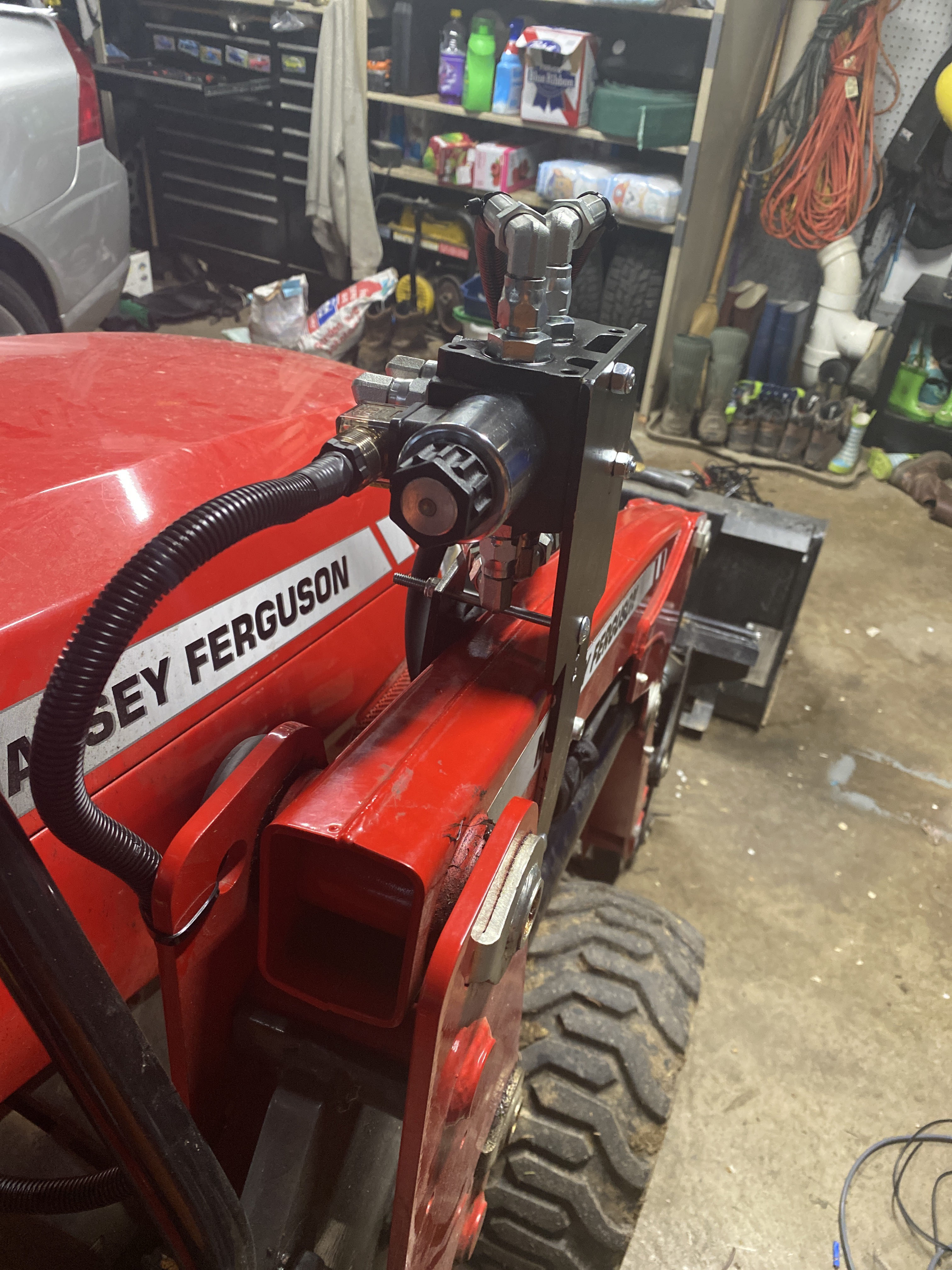

Which valve kit did you get from WRLong, and did you fill out their FEL dimensions form to have them supply everything with the kit to do the install.
KC

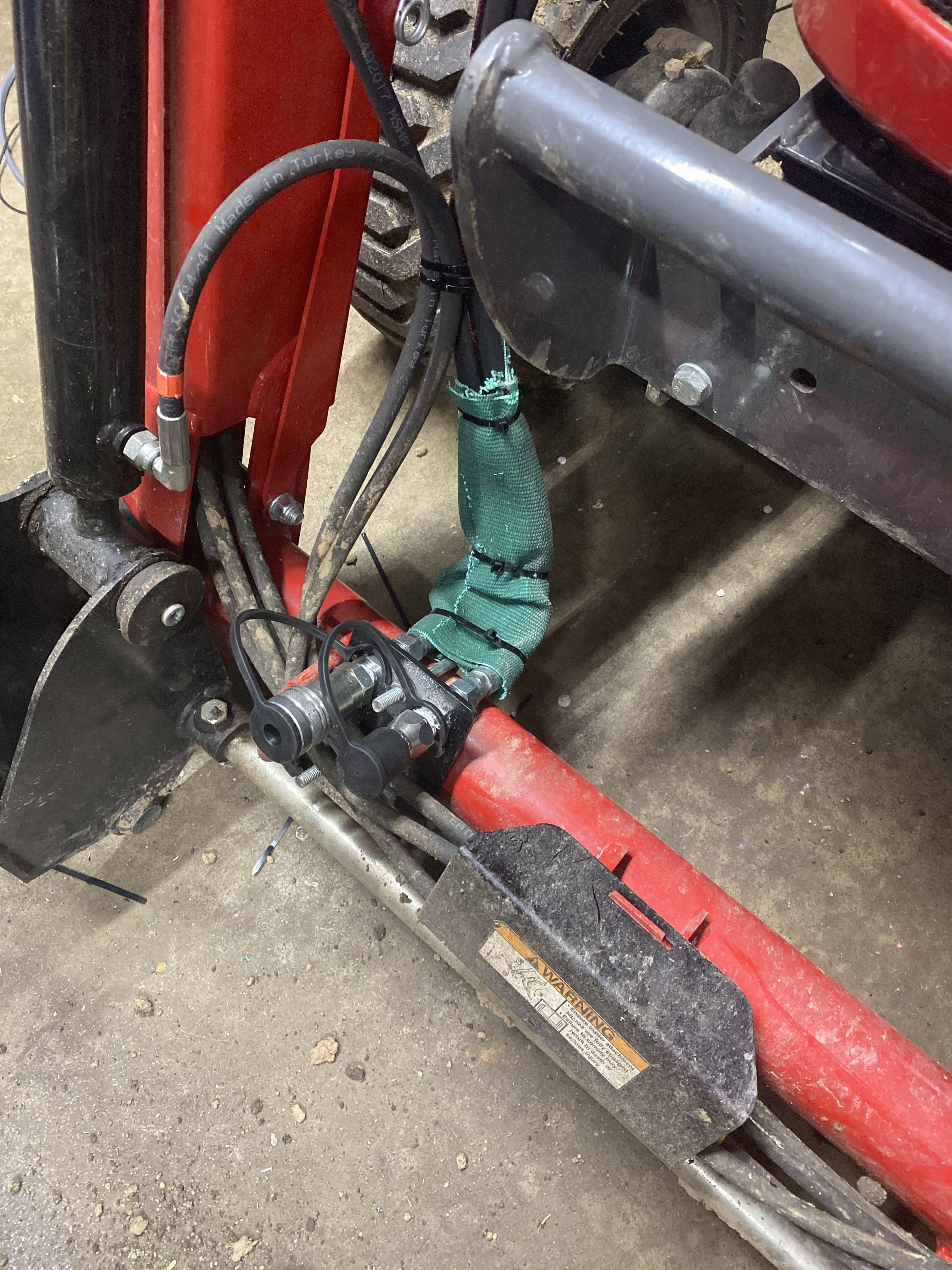

Yup, WRlong. I ordered it through my dealer as a kit. It had everything needed. I used a trailer 4 way plug for the wires, to disconnect.
KC
Just realized I didn’t actually answer your question. The only markings on the box was the MF1805. So I don’t know which # kit it was.
And Cglaser you are correct, as far as I’m concerned the MFs are better then the Bota or Deere. Virtually same performance, no treadle pedal and no proprietary SSQA.

Thanks, sounds like your MF dealer has done the work of filling out the WRLong FEL dimensions on their form.
KC
I have the older DL95. Same thing, I just ordered through my dealer who obviously knows I have a GC1710/DL95 and the kit was all sized to install out of the box. I also used a 4pin trailer plug and cut 2 of the 4 wires off flush to be able to remove my FEL. I'll probably switch the plug to a 2 lead weatherproof plug down the line as I get my machine dirty and power wash it... Water is the enemy of electronics so I want something more resistant to the moisture

Your valve looking good, btw.
   / What have you done with/to your GC Series 2300, 2400, 1700 Tractor TODAY #280
Mine is also a DL95, guess for the valve they are the same.
