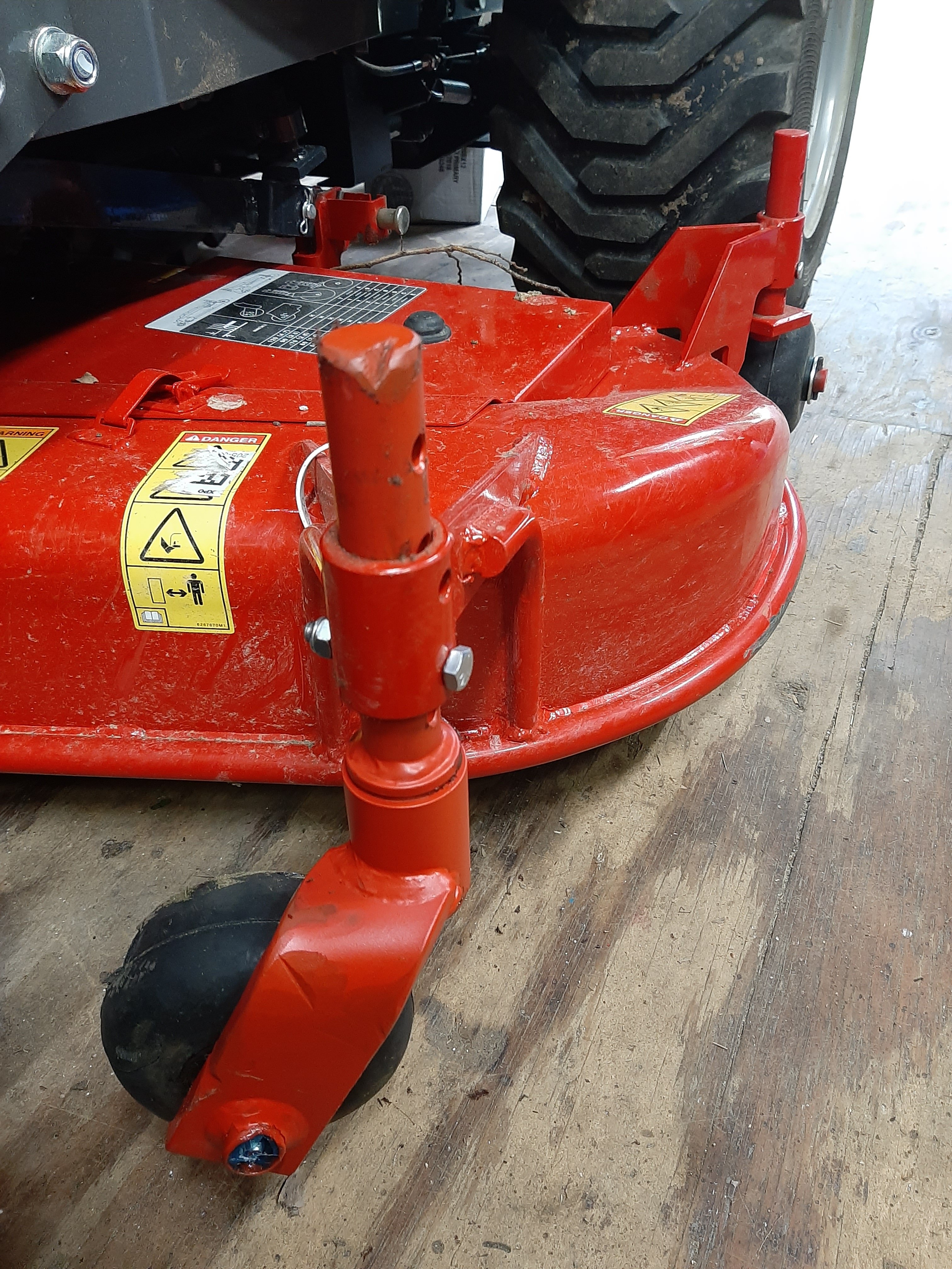

yeah, those pins should be inserted the other way with the clips on the inside. Seems like all the dealers put them in backwards or something. They are more of a PITA to insert with the clips inside. I did something similar, but I did not mow it. I have not had any issues since I started putting them in the right way.
Did you chip or bend the blades?
Just inspected the deck and just a few dings in the blades, not enough to warrant removal and sharpen.
Did a bunch if grinding and required a holesaw to clean out the grease fitting. Bolt and lockout now the pin for this one. Swapped all other pins around and sprayed with what can of red I had on hand, it's not Massey red😅🤣😂
When I had the deck, I did the same thing with the screw/nut after one of my casters came off like yours did.

Mowing along the edge of my property or close to areas where there is a lot of brush and shrubs. If the clips are installed on the outside of the deck a stick or anything stiff can easily snag the clip and pull it off. I mow extremely close to brush and shrubs to keep them from spreading and in some cases mow them back.

Some years back, when this happened to my tractor, I had a dude here on TBN argue with me that it's impossible that some brush could yank the spring pin out. But yes, it's possible, coz that's exactly what happened. Moot point at this point, coz I now mow with a stand on mower.

Yep, until you see it happen, or I should say, until you have to go looking for a guide wheel, you'll swear that those clips can't be yanked out. I was surprised the first time it happened to me. Honestly, if it wouldn't make it take 4x the amount of time to adjust the wheel height I'd switch to bolts and lock nuts all around. However, since I've put the pins in with the clips on the inside, I have not had one pulled off.
