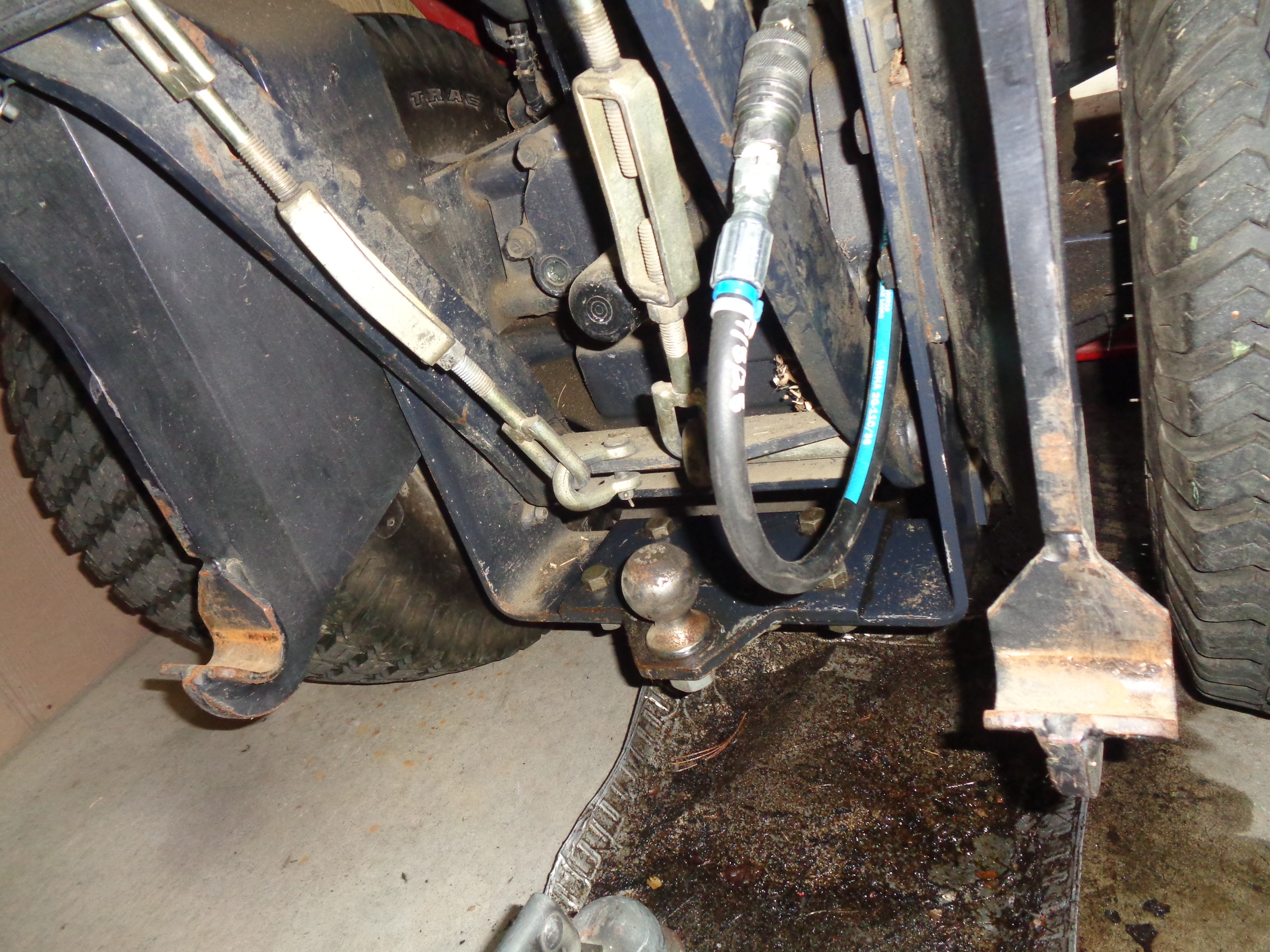

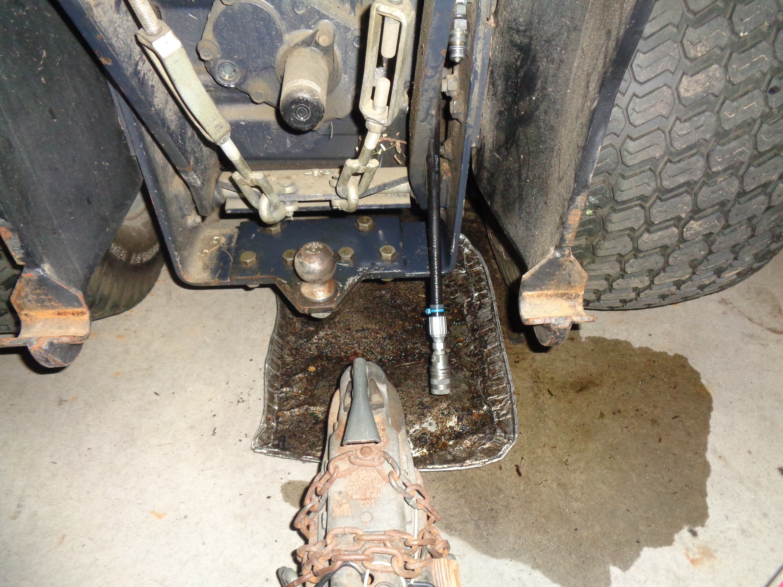

Well, haven't done anything yet, but it looks like I'm going to have to change another hydraulic line. Replaced one of them that go from the joystick back to the rear quite a few years ago, and now I have another (the "return loop" when BH is off) that's leaking. Glad I have shops nearby that can fabricate lines....
   / What have you done with/to your GC Series 2300, 2400, 1700 Tractor TODAY #2,813
Well, as it turns out, that wasn't an original hose -- it was one of the two or three that failed when the tractor was still fairly new. Bought my GC in early 2008 and I had apparently replaced that one in May of 2011. I guess 14 years isn't too bad...?
I was, however, surprised at the price! Seems like the last ones I changed -- maybe 8+ years ago?-- cost around $50 or so; this one was a tad over $100. Had it made up at a local O'Reilly's, so at least it was available quickly.

Try @kennyd (of BoltOn hooks fame) for hoses. He'll make them for you IF you know exactly what you need.
Why is the backhoe mount on the right side of your photo different from the left?
   / What have you done with/to your GC Series 2300, 2400, 1700 Tractor TODAY #2,815
Not sure what you mean, but it could just be the %$# camera I use stretching the image on the sides. (The old camera I had worked quite well, but eventually the storage-to-card circuitry died. This one I bought to replace it really doesn't work as well for me.)

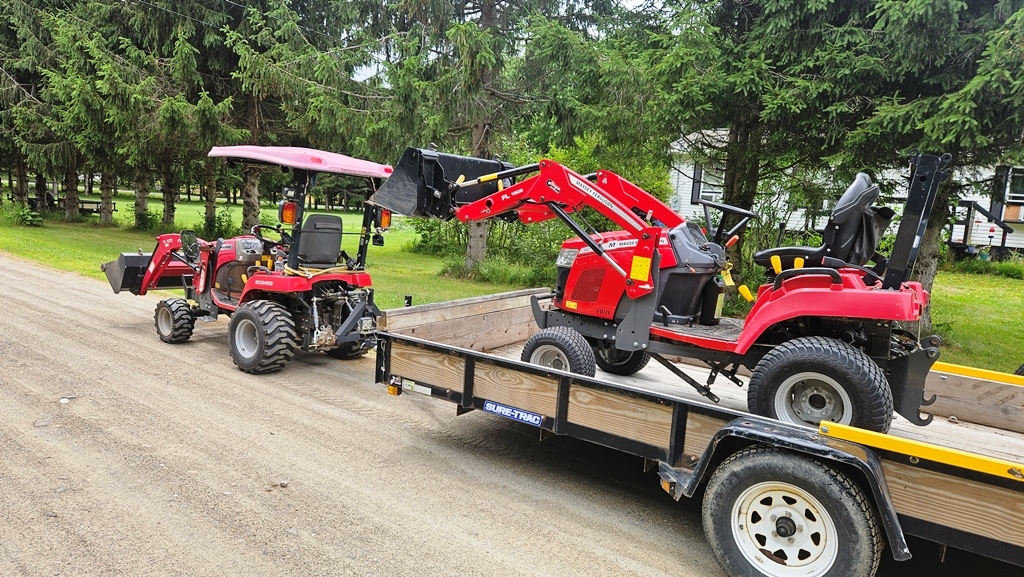

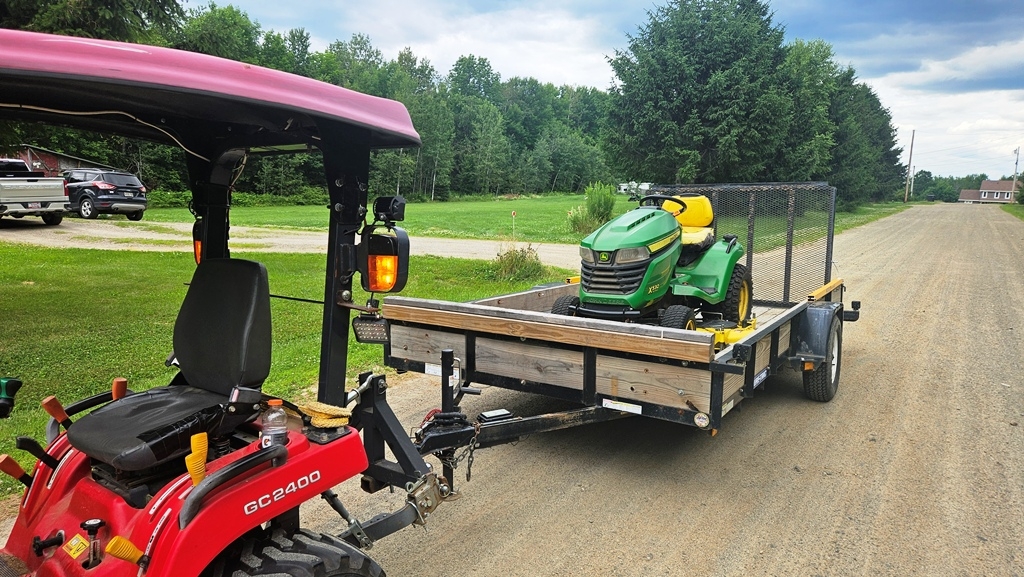

another one serviced and being hauled up road to owner.
1 deere d105 lawn tractor with shredded transmission drive belt fixed and serviced and delivered in this manner monday.
1 gc1725 with temp sensor and thermostat issues fixed and delivered tuesday.
1 deere x530 lawn tractor (nice unit, power steering diff lock (2wd) etc) had deck serviced and leak on hydraulic reservoir (orings) corrected and delivered today.
since only 1/4 mile or so to each customer just as easy to go for ride with tractor and trailer vs hooking trailer to truck.
now MAYBE I can finally clean and service my tractor and deck :)
