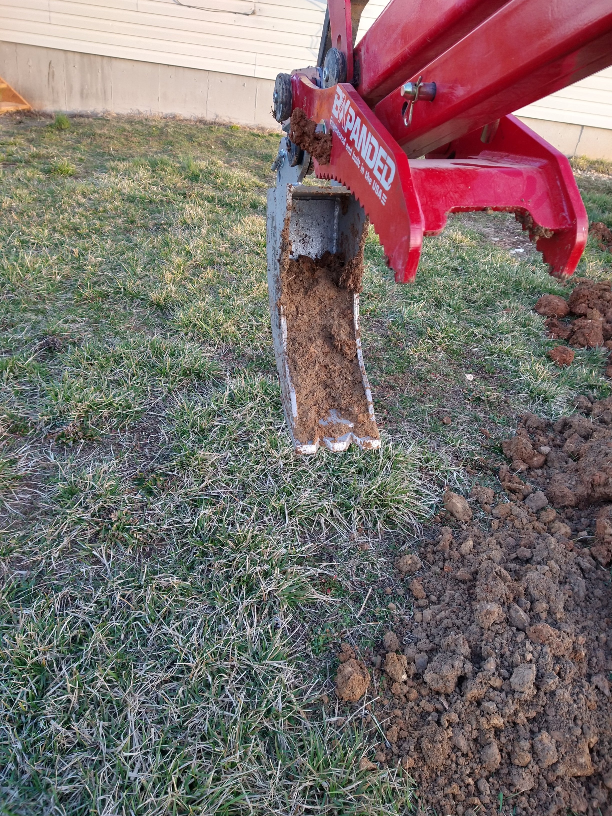

Depending on soil conditions, a 6" bucket can be hard to empty.
I have heavy clay soil. And, unless it's bone dry, my 6" doesn't empty well.
I learned to schedule those projects for the driest time of the year. Then, it goes quite well.
The BXpanded design has shallow sides which will help with emptying.
If sticking is a problem, wait for dry conditions.
Shaking the heck out of it, is likely to loosen your bushing's up in a hurry.
If it sticks, I just tip it upside down and just tap it on the ground ...
Gets "most" of it out ...
One thing to be aware of using both the Quick-On and the narrow 6" bucket ... It's "possible" to snatch the pin out of the Quick-On ... !
I did add one of Kenny's Bolt on Hooks to the factory bucket ... Comes in handy! Even though I had to do a bit of digging on this 25 plus year old set post, setting the bucket on the ground, and "rolling " it back, got it started up ...

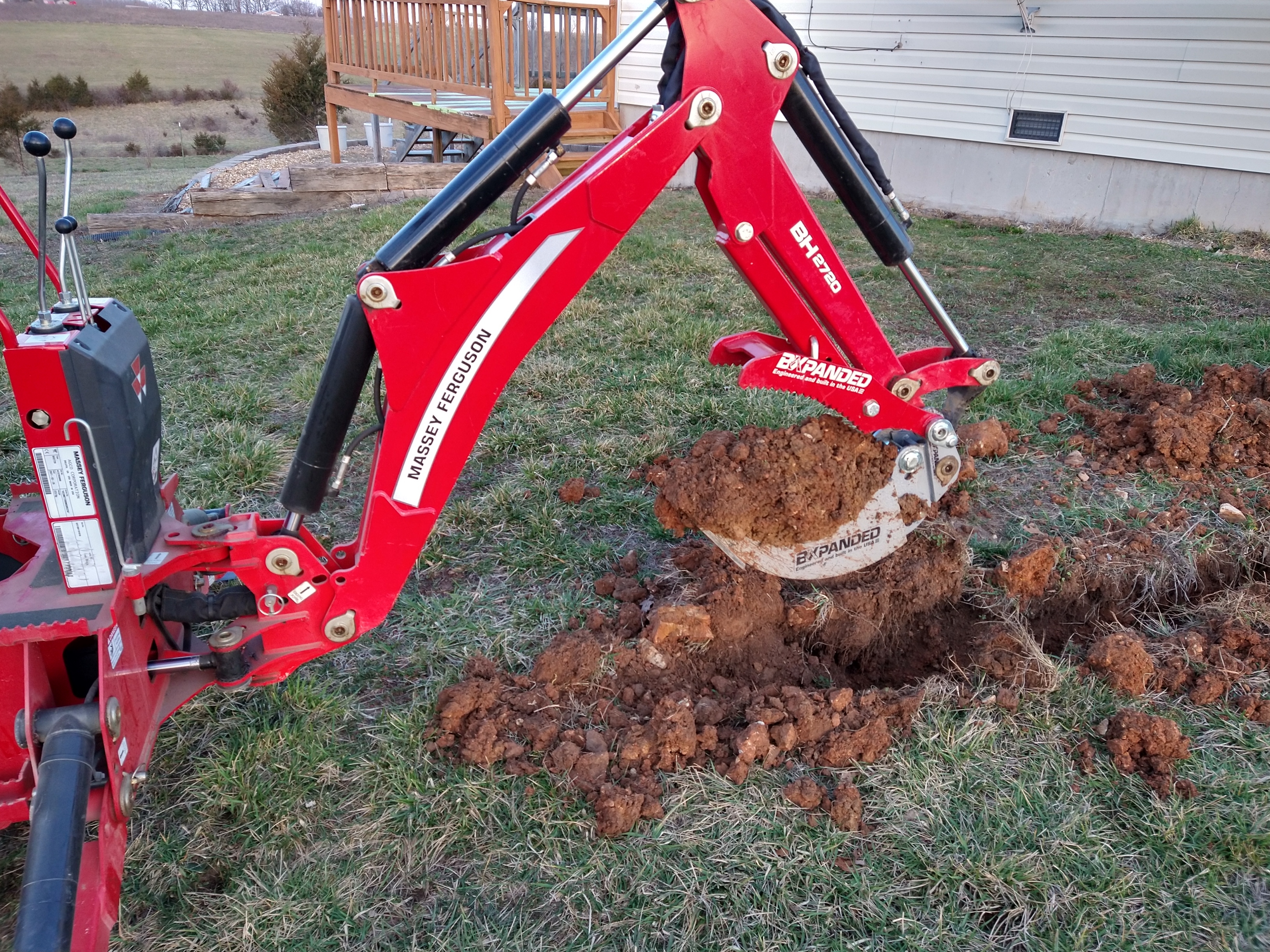

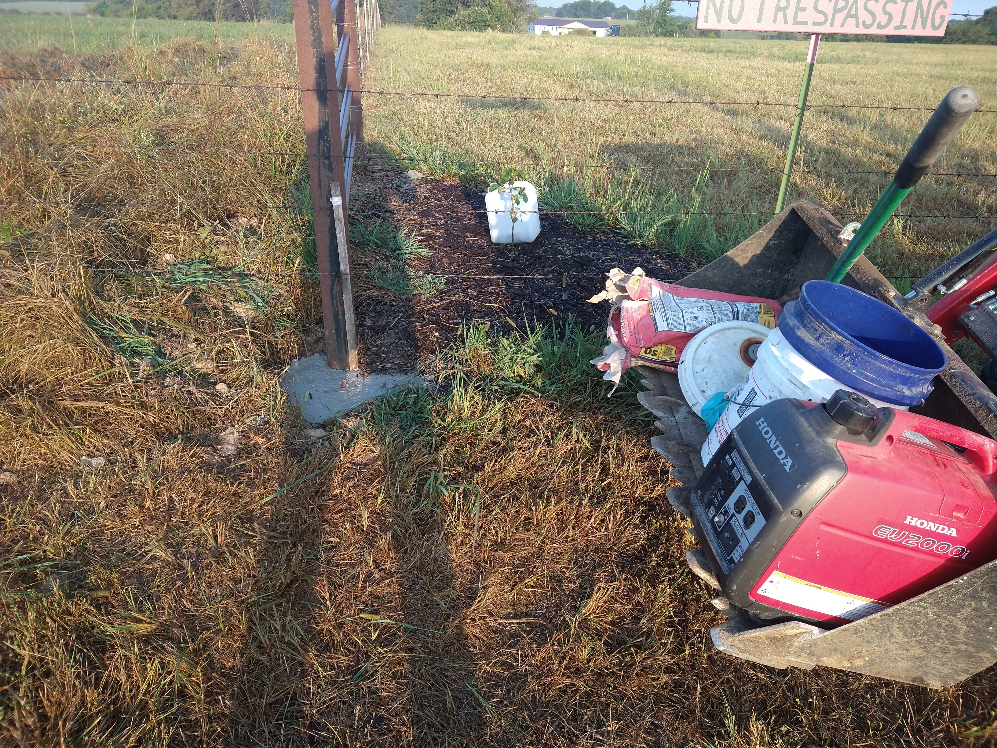

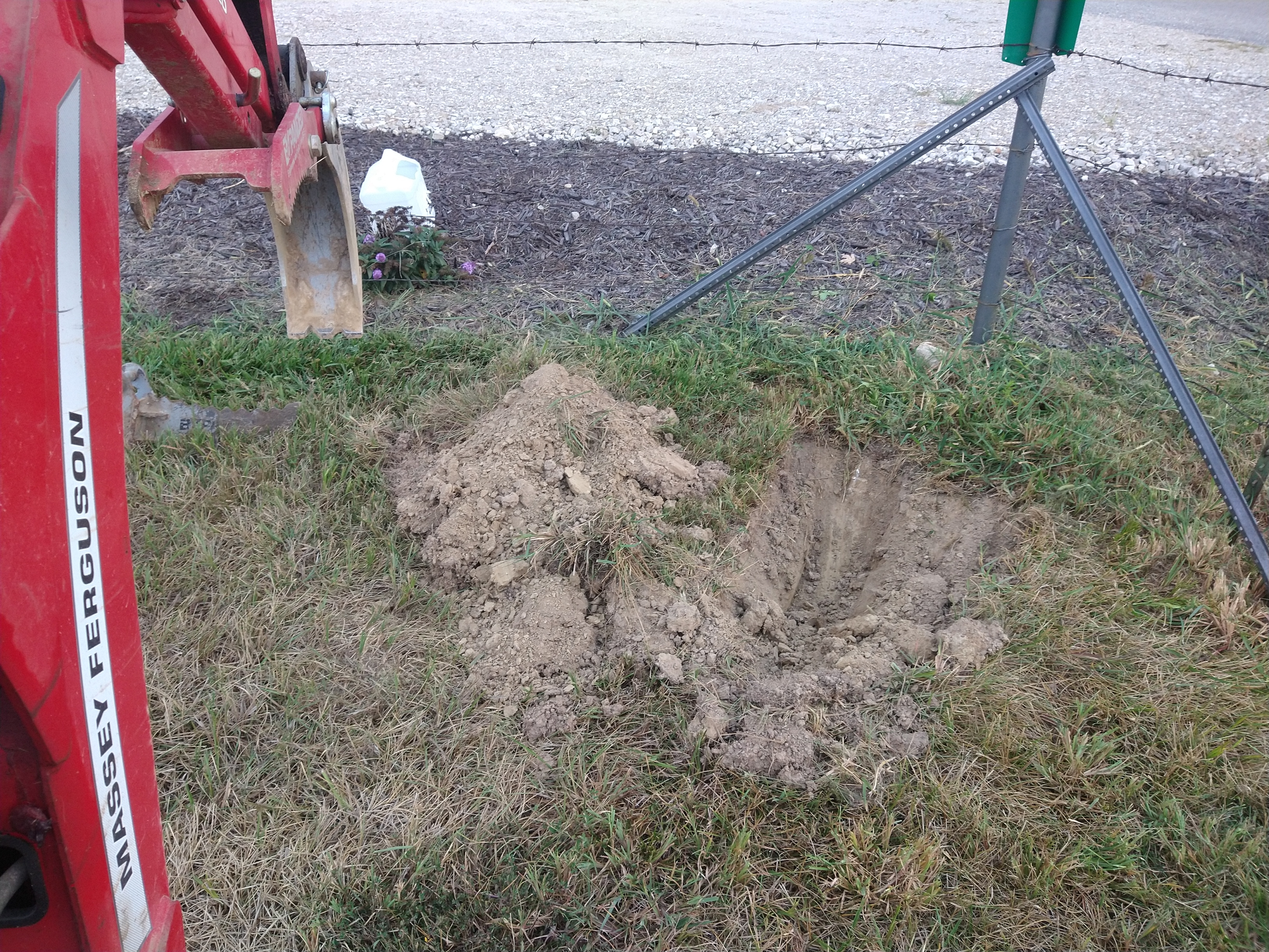

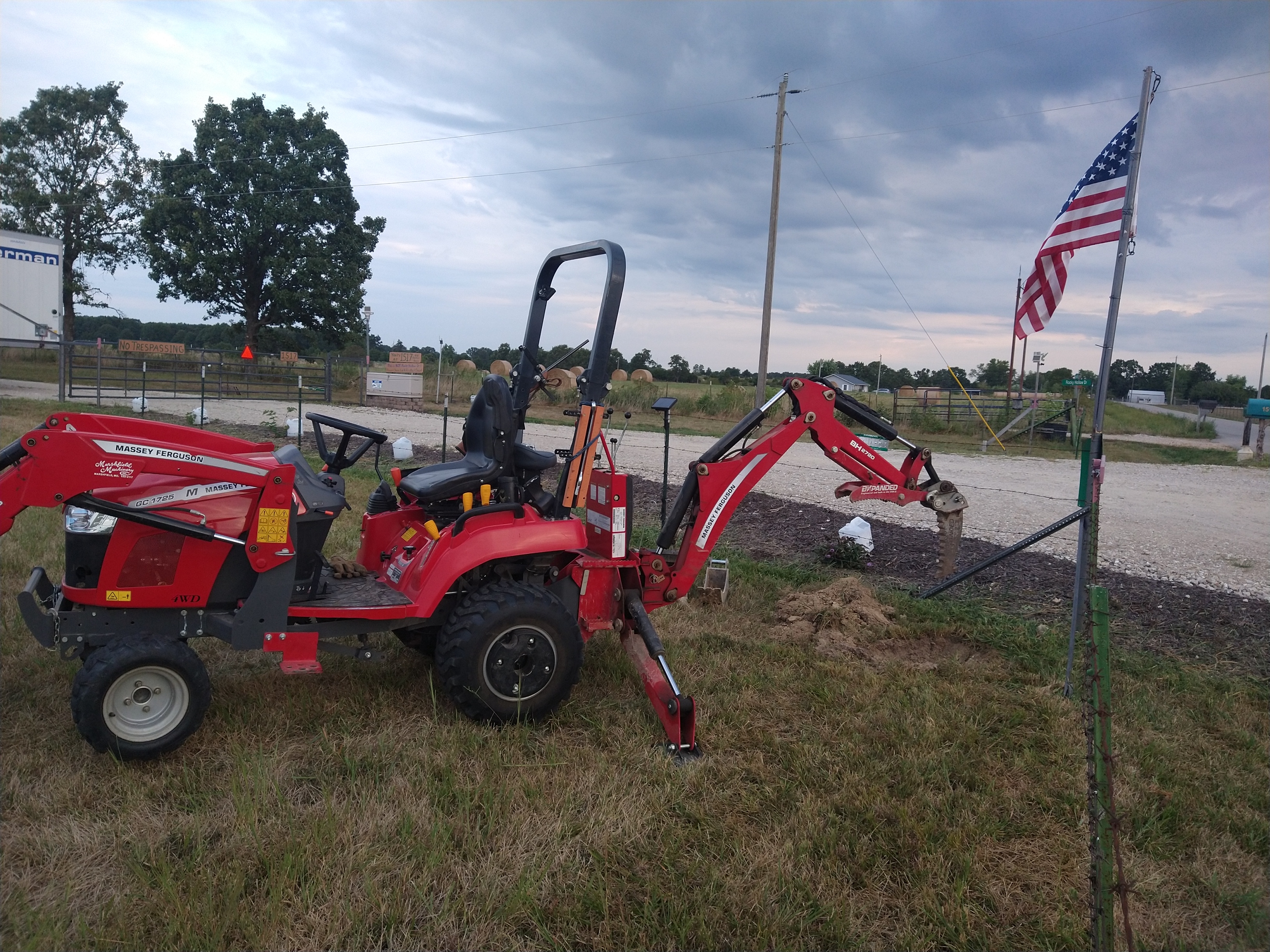

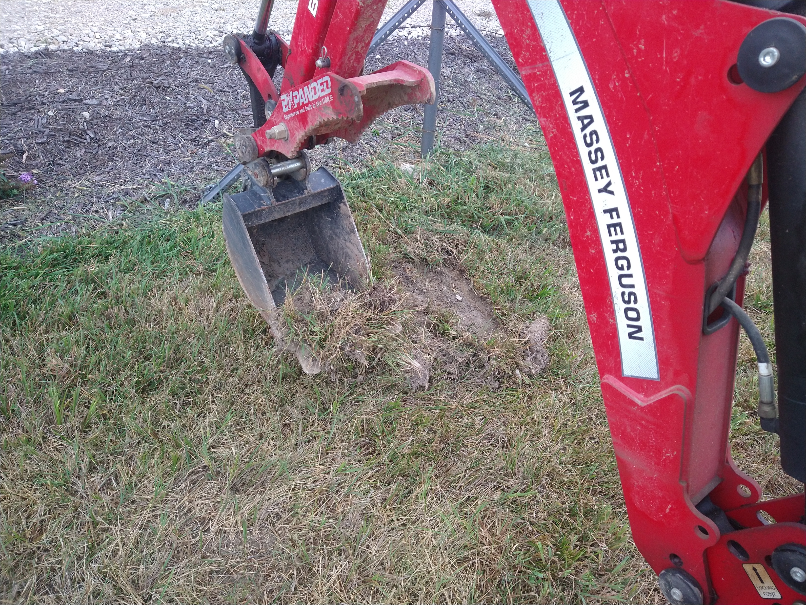

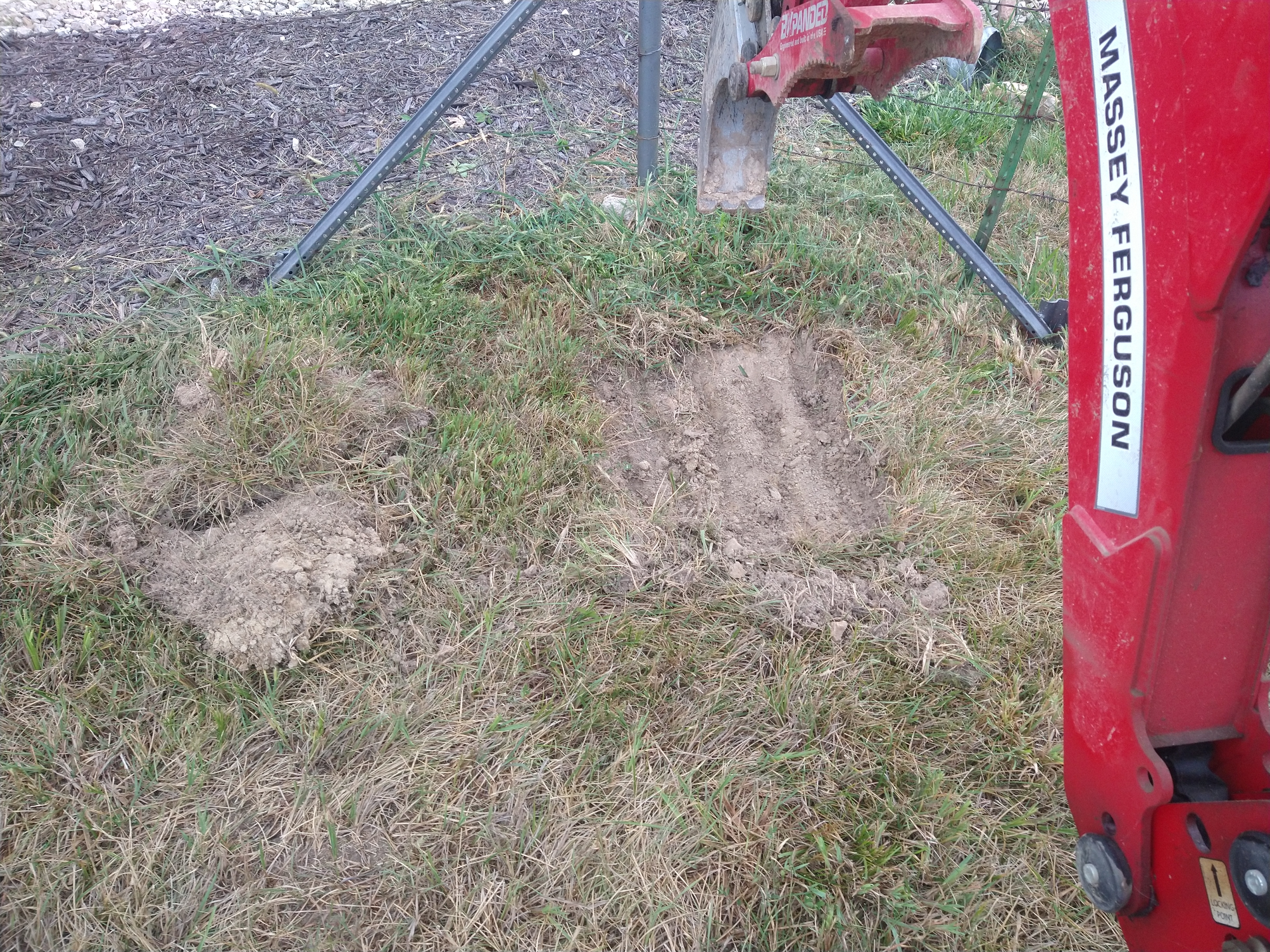

Caught a thieving opossum in my barn this morning ... So I switched out the QH for the BH and headed out to the fence corner where I plan to plant an Forsythia bush in the spring . . . We've had less than 2/3" of rain in the last 2 months, and the clay is quite hard, so I brought a long my 6" bucket and the ripper . . . Gonna make some awesome opossum fertilizer!
The factory 12" bucket was having trouble digging . . .
So I tried the 6" . . . as this was the best the 12" did after many tries!
A little bit better, but not much, and it didn't like the sod ...

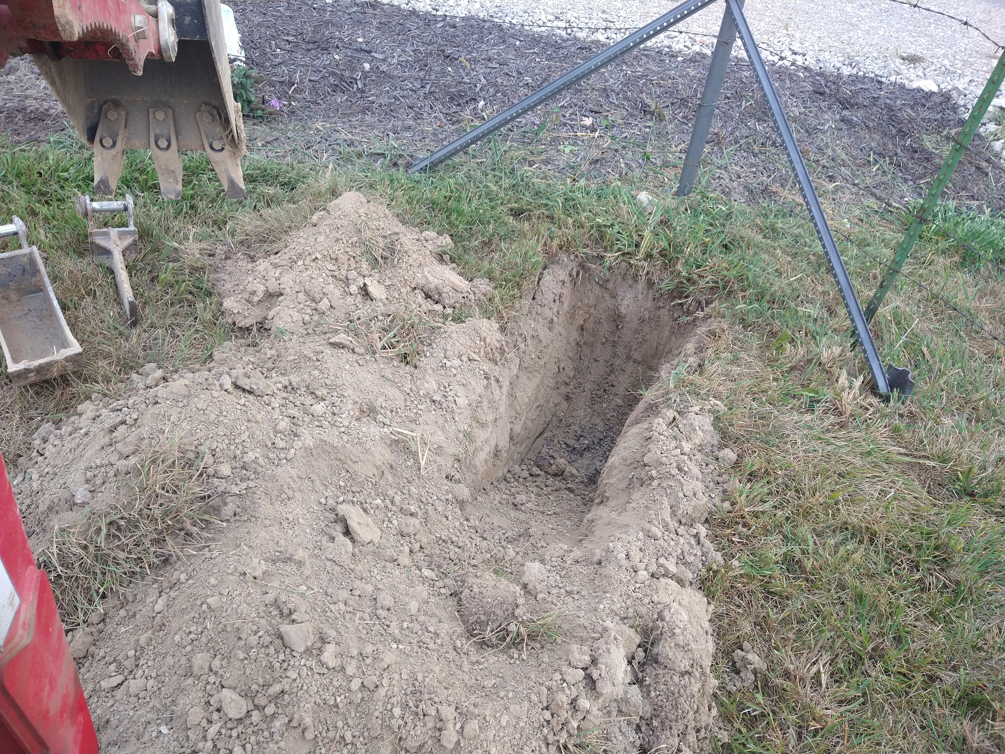

Put the ripper on and LOOSENED it up!
Then switched back to the 12" and cleaned it out!
It's only 30" - 32" deep ... I dropped the fertilizer in, then tossed the sod in, then back filled ...

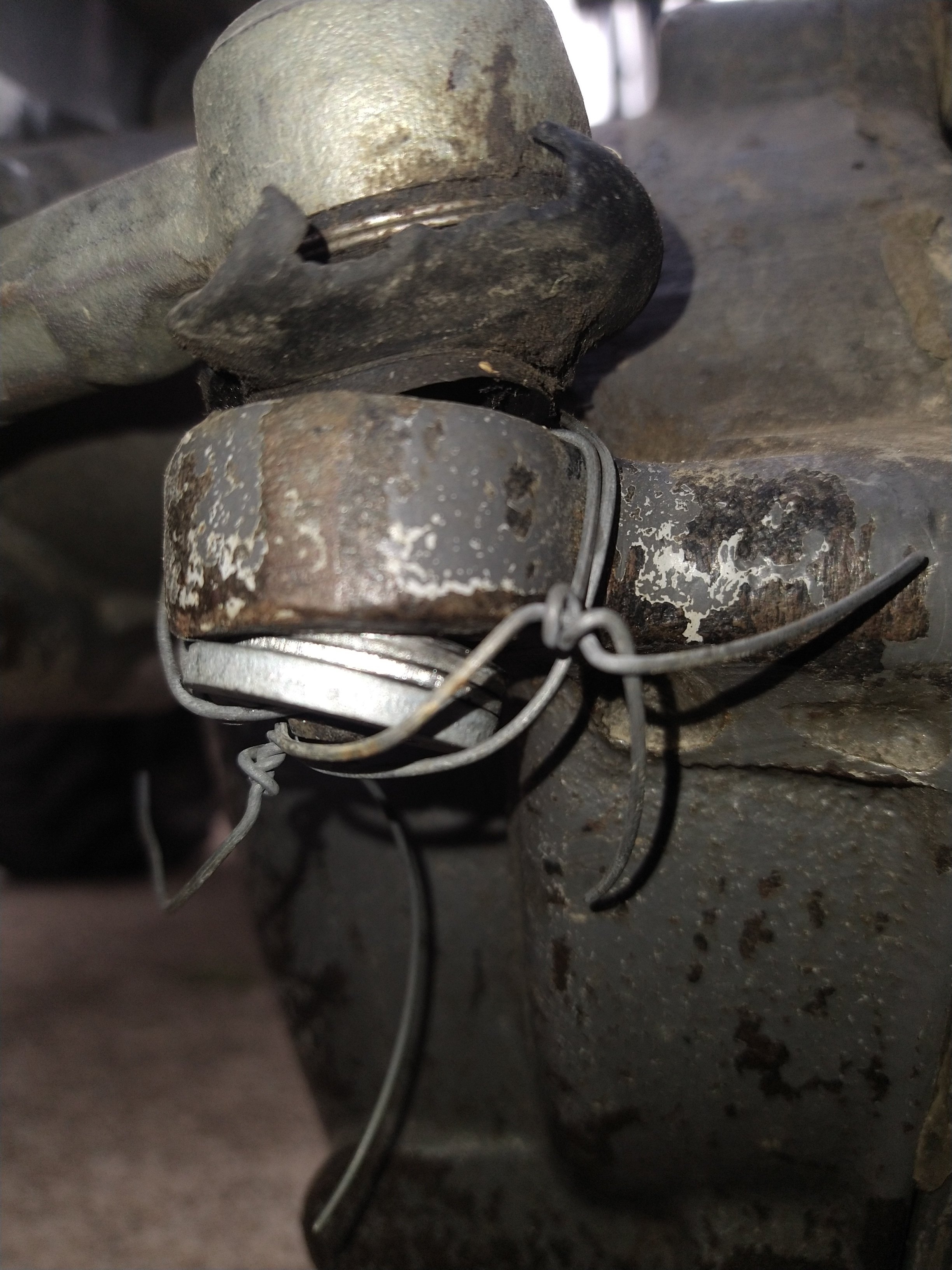

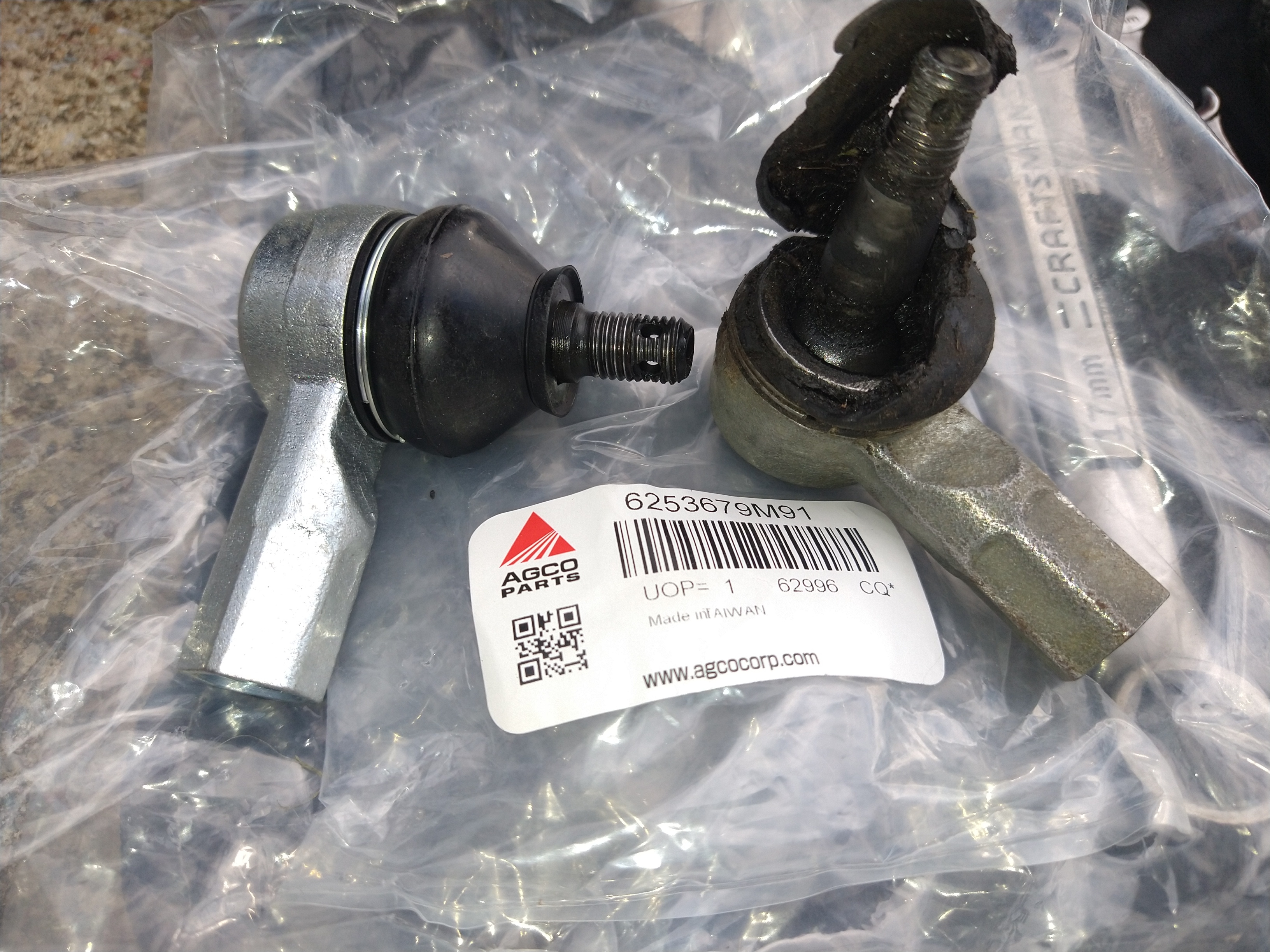

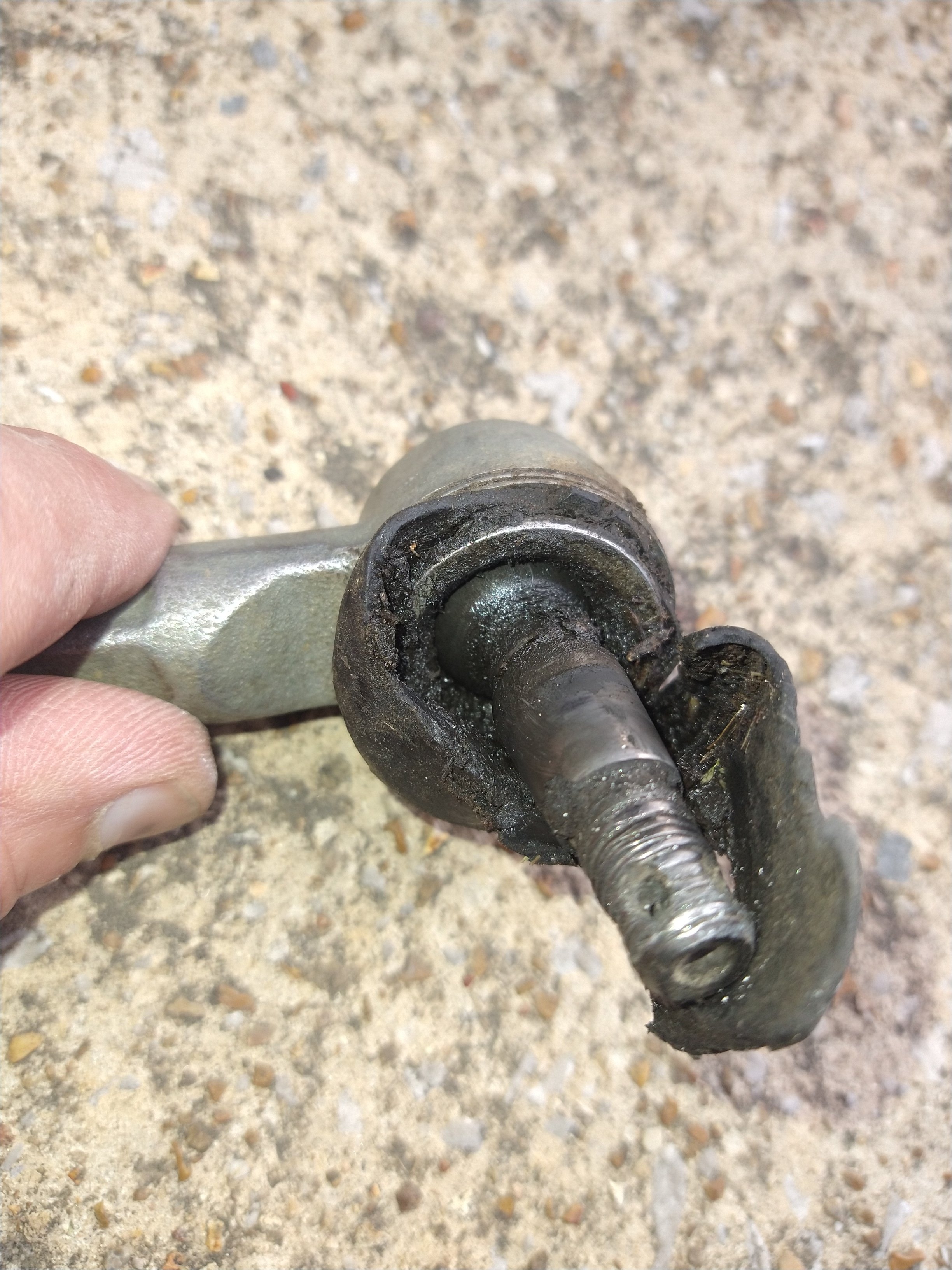

A few weeks ago I was out watering and was backing up on uneven terrain and it started to spin, I put it in 4X4 still wouldn't go, locked in the rear axle ... Still spun ... Then I noticed both front tires were pointed out! My left side tie rod end had popped out, the nut was missing ... I had to finish ... So I did a "field repair!
The threads were already buggered up, so I grabbed a few washers and some wire and tied it together ... And ordered two new tie rod ends, as both were pretty tore up from brush hogging over multi-flora ros
es!
I also stuck a piece of wire though the right side one, as that didn't have anything securing the castle but, not sure if it ever had one, or if I snatched it out while brush hogging ... ? Does your have a cotter pin in it?
The tie rods don't come with new nuts, washer or cotter pin, they are separate ...
The old one was not really wore out, but I didn't mind tossing it in the trash!
Got both sides replaced, and used a hypodermic needle on the end of my grease gun to give both 4 pumps of grease ...

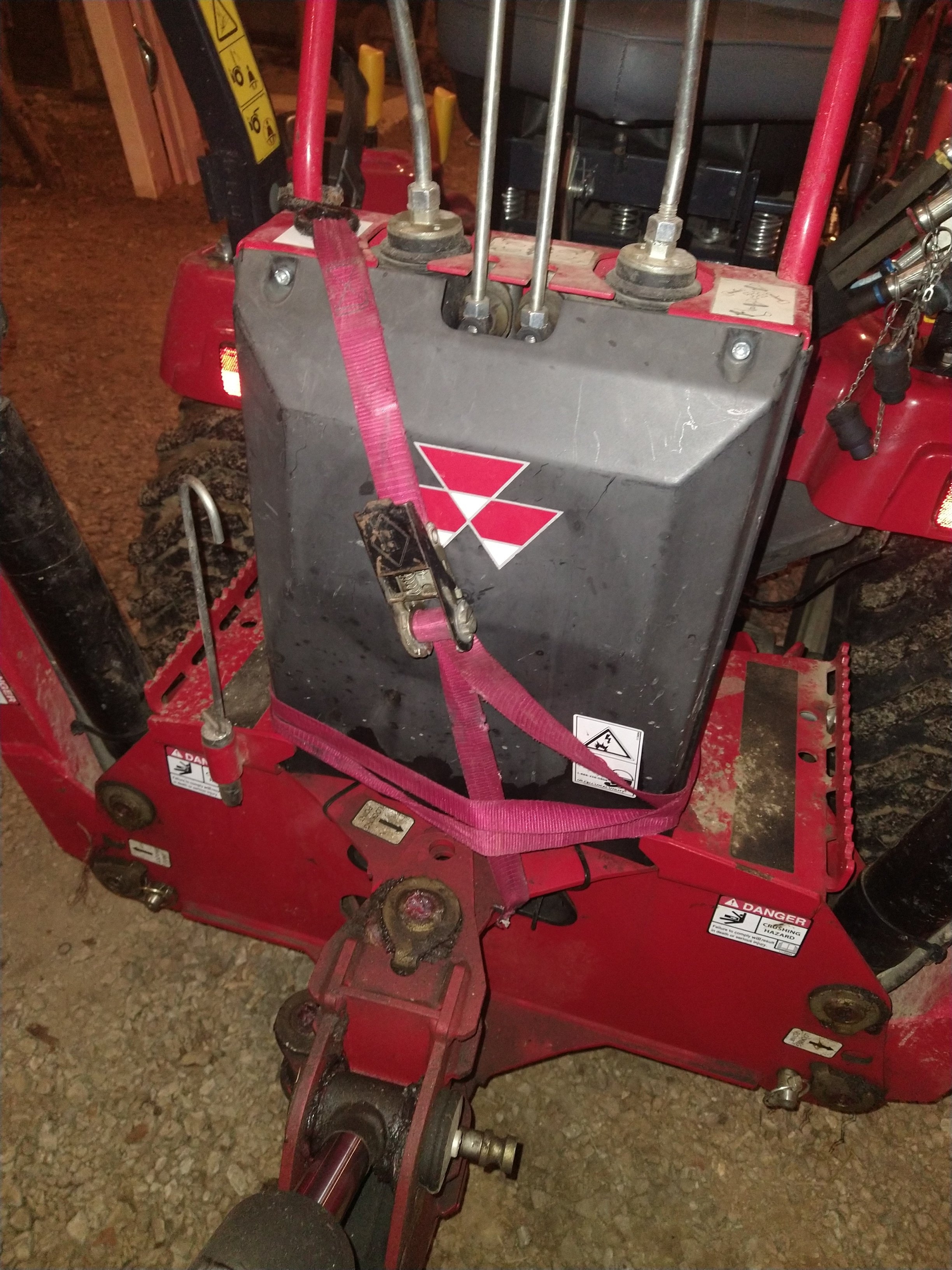

Last night shortly before coming in from my creek project I noticed the BH control tower was wobbly, rocking forward and back, this morning I took the plastic cover off, and 2 of the 4 mounting tabs have cracked!
While I could weld it mounted on the tractor, I prefer to wait until I take it off to weld it ... In the meantime I used a rachet strap to secure it!

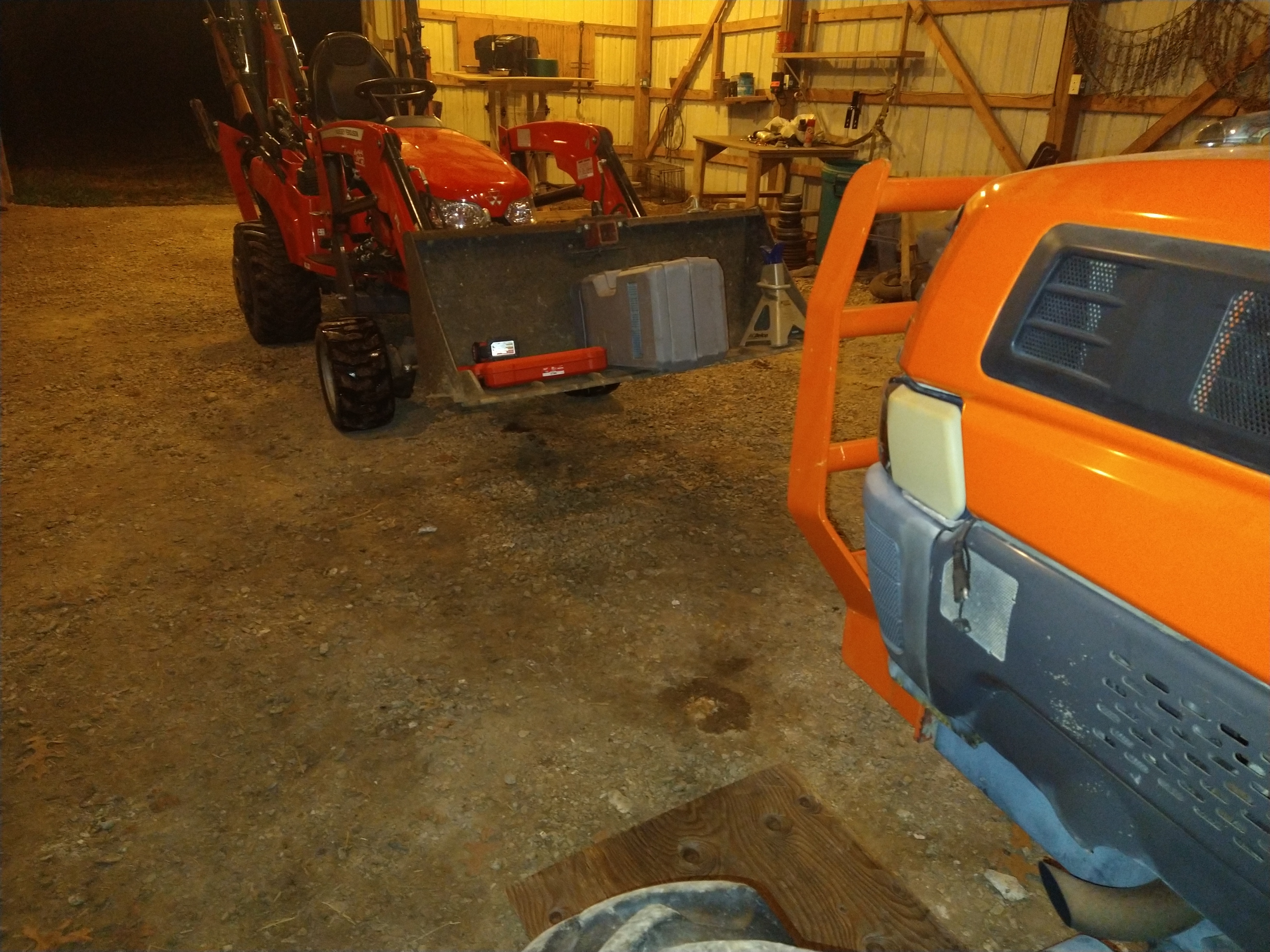

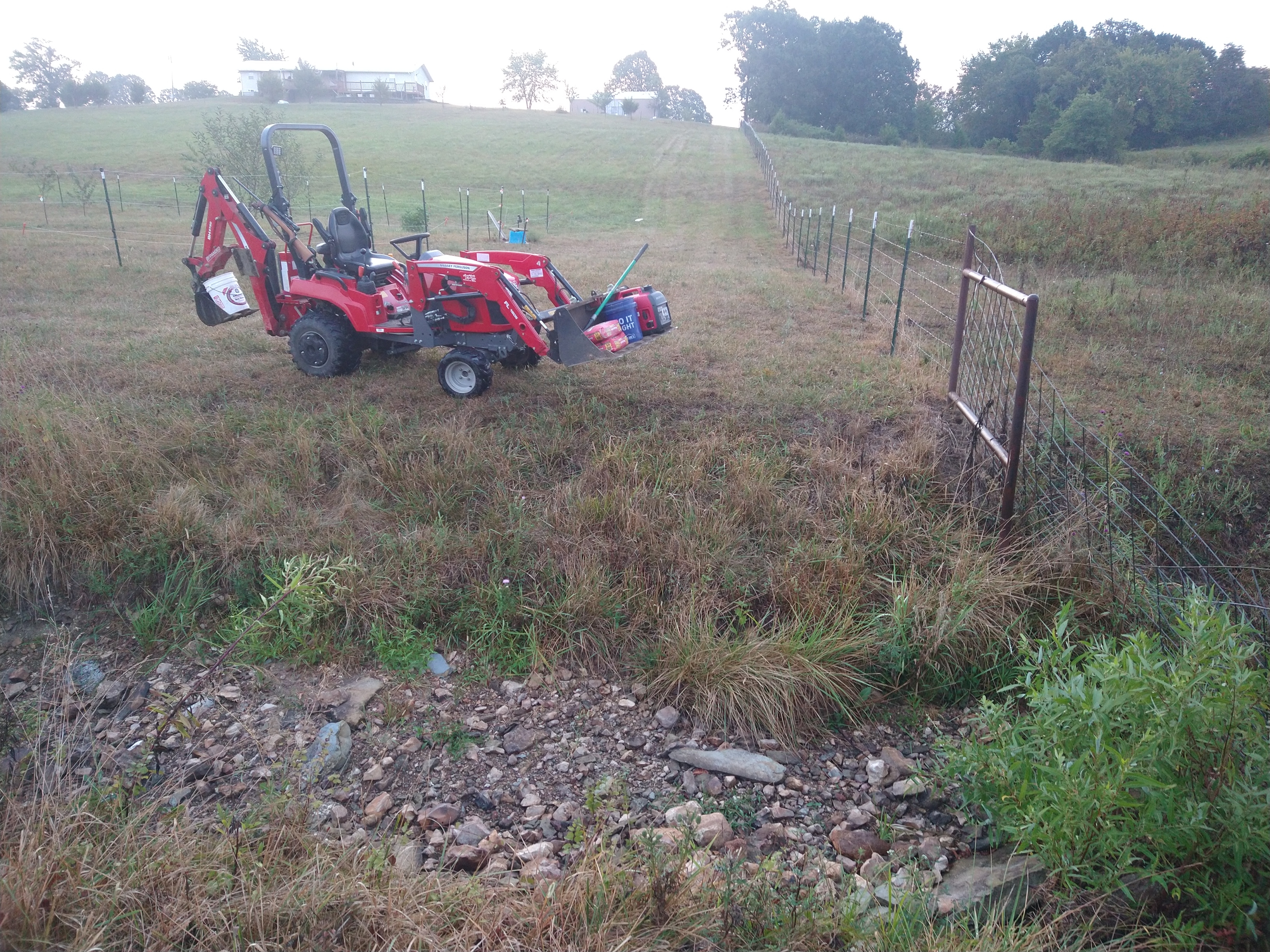

I then went out to work on my Kubota, Little Baby Fergie helped me carry stuff from the garage ...

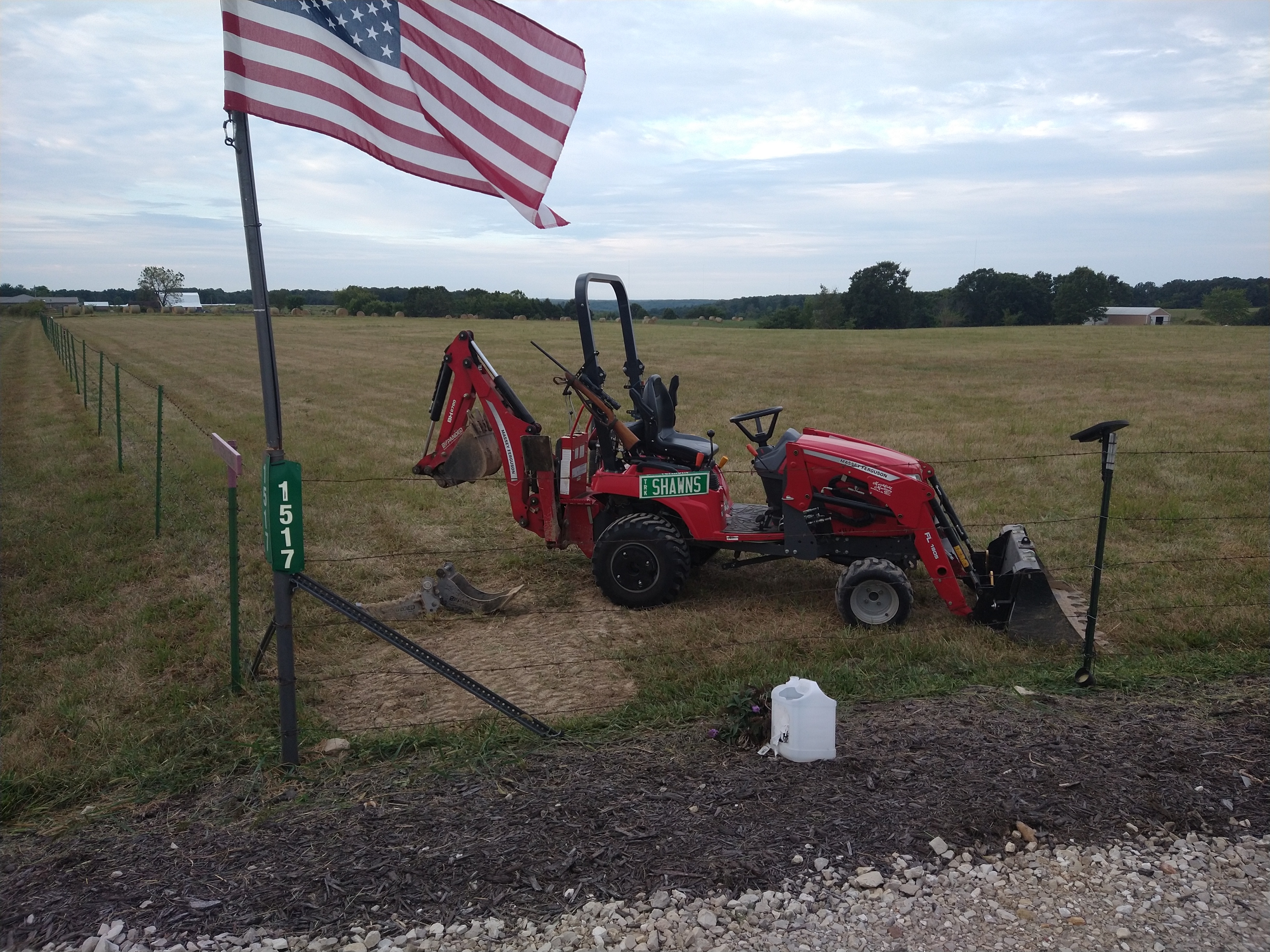

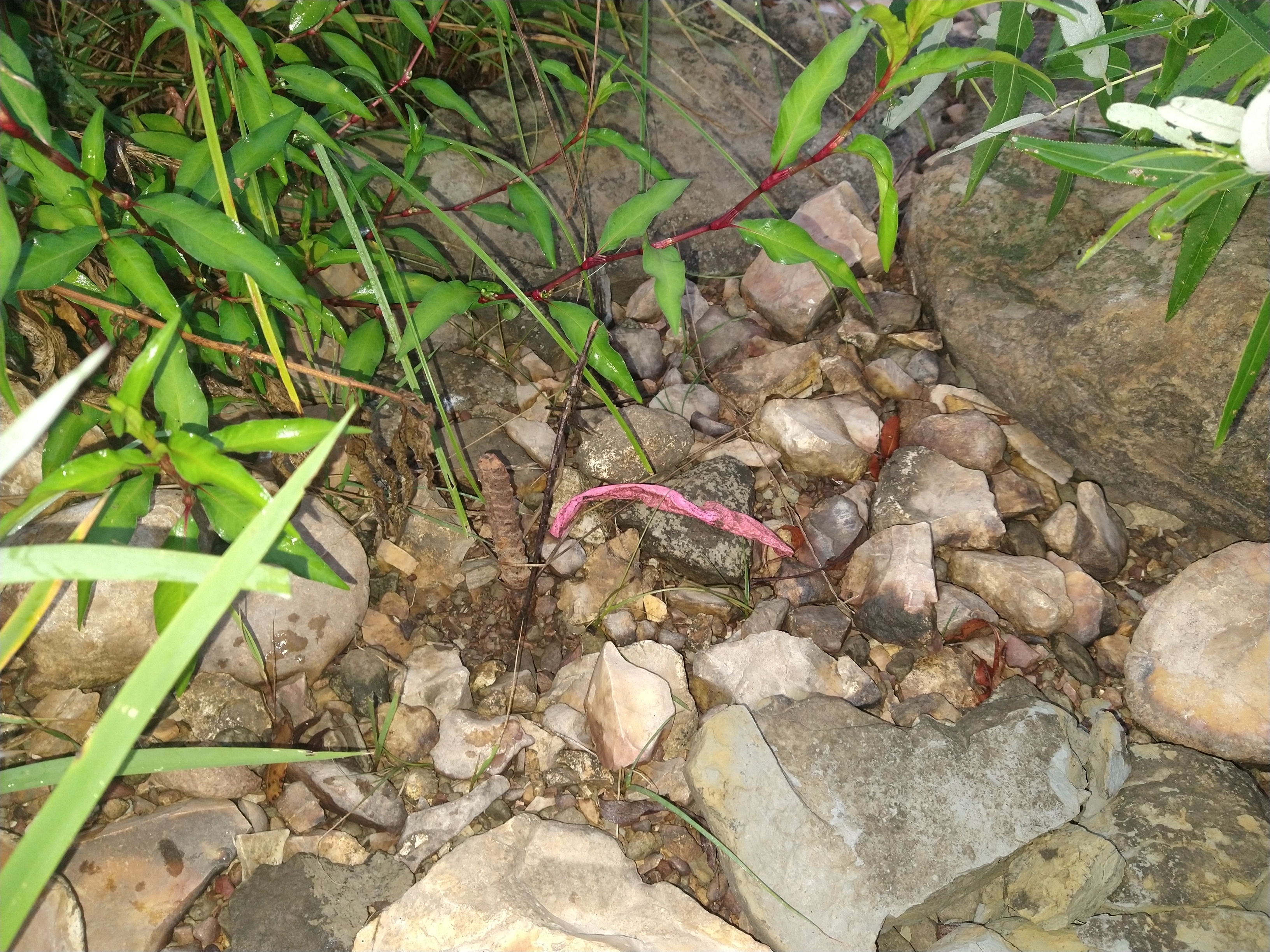

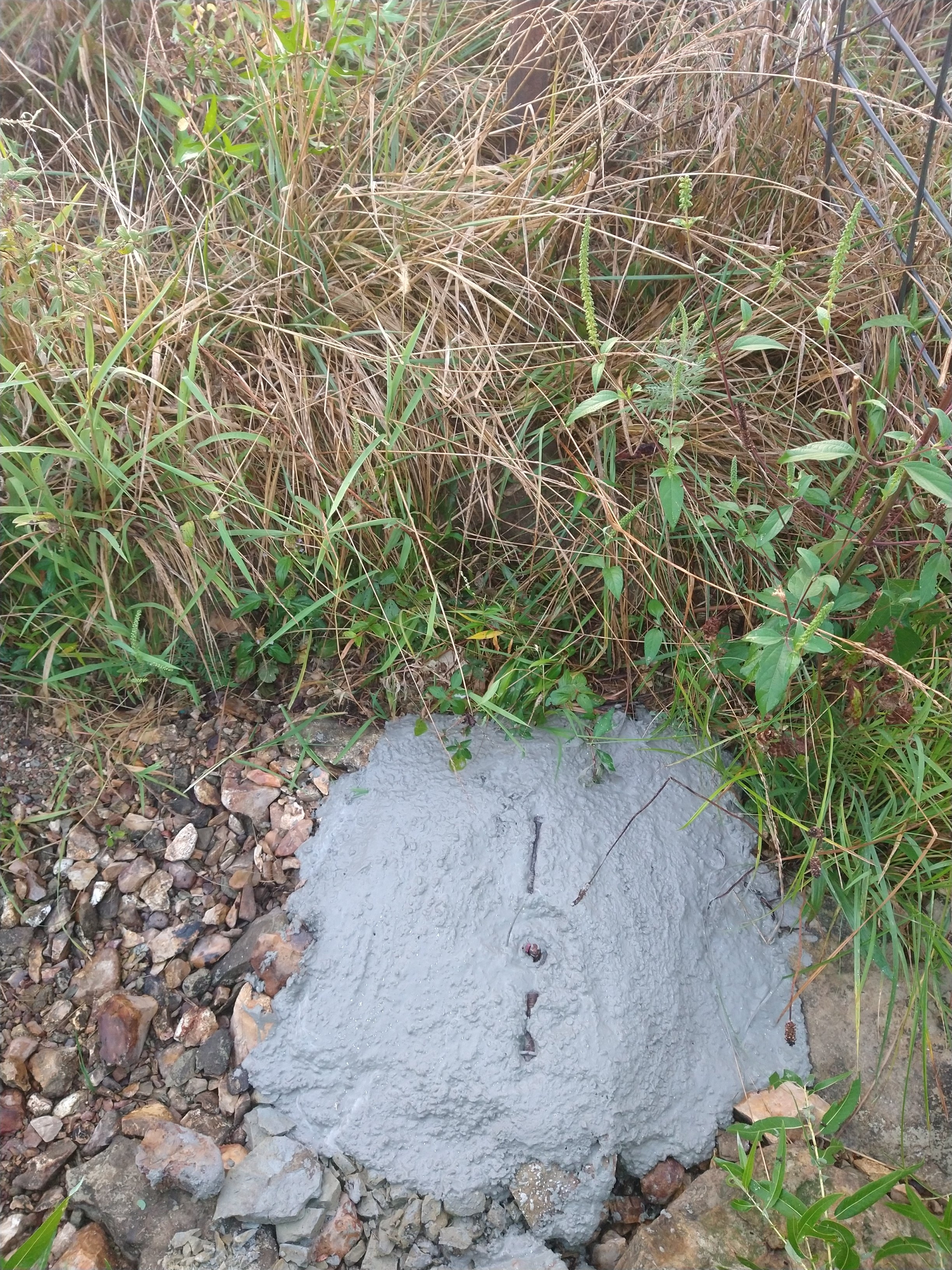

I then loaded her with supplies to put a bag of concrete around two of my corner survey pins, one is down in the creek! I wanted to do it while it is still dry!
I dropped a lug nut over the piece of rebar, then added two old bolts, to increase the metal content, to make finding later easier
Then went out front, while there is a 4" steel fence post right there, I figured it would preserve it, plus make trimming around it easier ...
