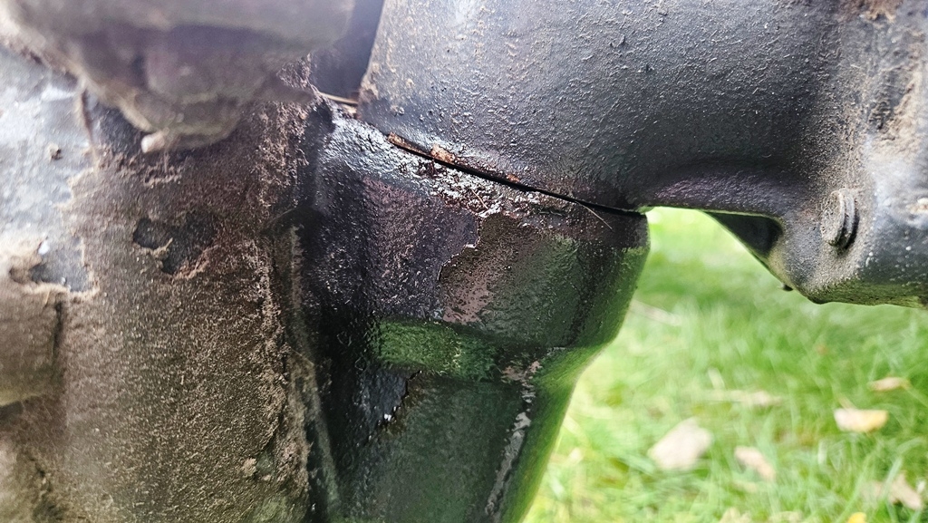

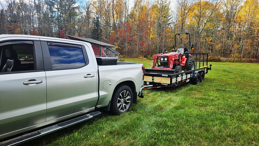

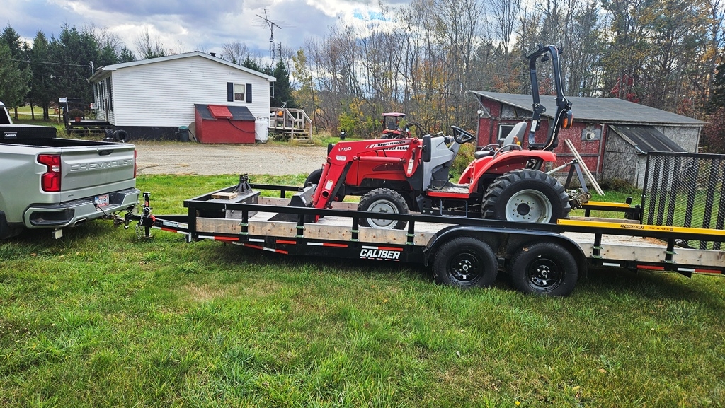

gc2400 hauled the 20ft trailer up (never try that w/o bucket on especially if hills involved :) ) so I can carry neighbors 1532 into dealer for front axle seal repair.
drop section pivot seal leaking.

was only 3rd time using trailer since bought in late 2024. first 2 times my snowblower (gc2400 with dl100 fel and blizzard 60" rear pto blower) total weight prob 2400lbs +/-) and was only 8 mile round trip.
this prob 32 mile round trip, lot of undulating territory (including a marked 9% hill) and best I can tell the 1532 with L100 bucket approx 3200lbs. the tractordata info of 2600lbs appears to be w/o the L100 FEL. so I figured 600lbs for that was safe.
anyways got to dealer paved level lot and looked. front of trailer at hitch 2" higher than rear at gate. rear bumper of truck 1" lower than front bumper.
reason I went with 20ft trailer over 18ft (which would have met all my dimensional needs) was all 18ft locally had equalizer pivot between 8 and 9.5 feet. any 16ft would not work for me as tractor with blower and edge protectors on bucket makes me 16' 1" long.
this 20ft has center of equalizer set at 11.5ft. gives me a lot of load placement leeway. and even with toolbox mounted in it I have approx 18.75 ft interior space.
   / What have you done with/to your GC Series 2300, 2400, 1700 Tractor TODAY #2,934
Do you have a weight distribution hitch?
I use mine even if I just put on my 1300 Lb Z-turn ...
