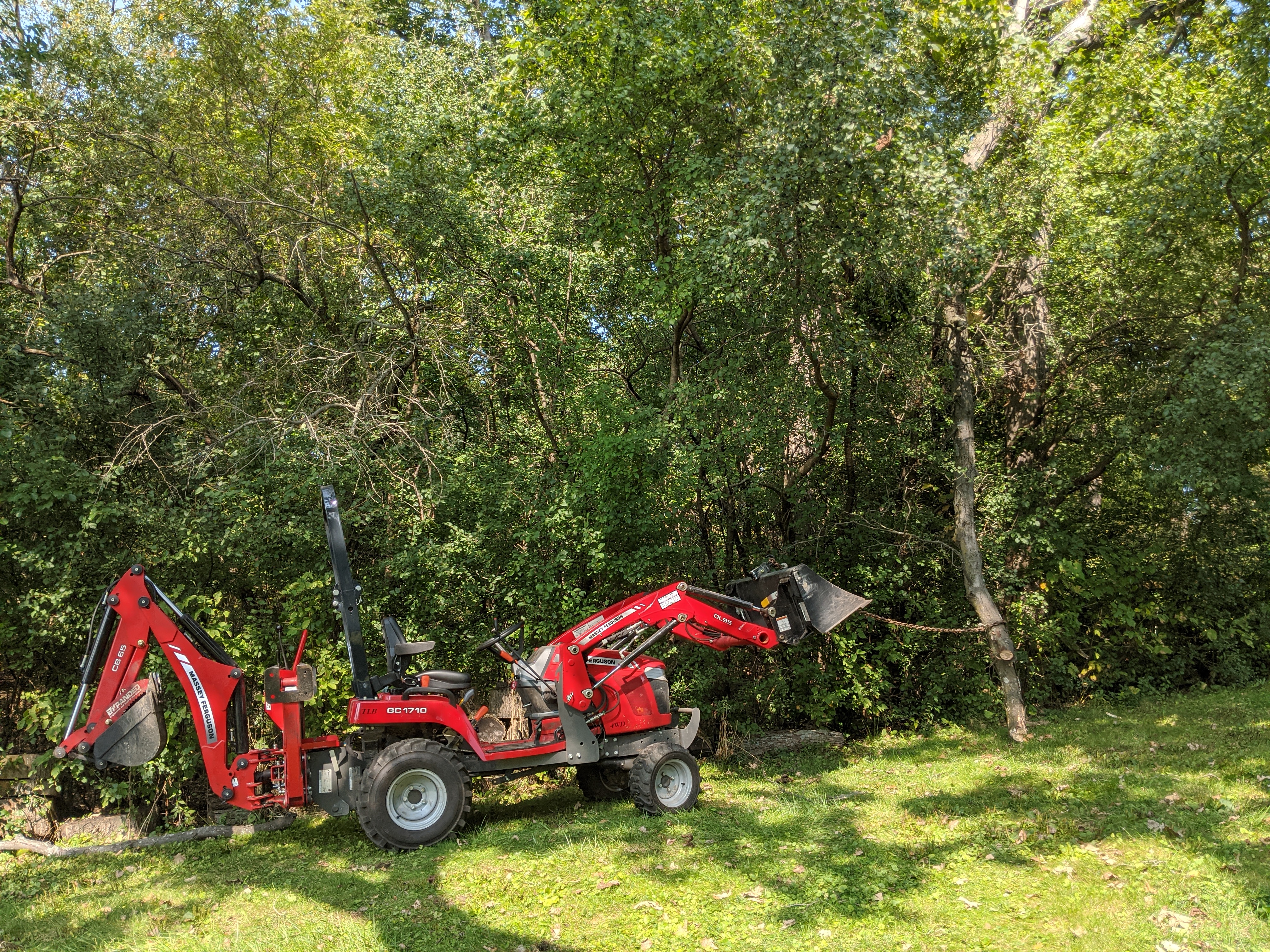

Anyways, things I did on the GC yesterday. Well first, I tried ripping down a hanging tree limb. That was a no-go, that sucker would just not rip off.
That was one scary widowmaker for which I was able to throw a line up and yank it down a few days prior, but now it's just hinged over there, hanging down. I'll screw with it some more down the road...at least I don't have to worry about it dropping on my head while mowing.

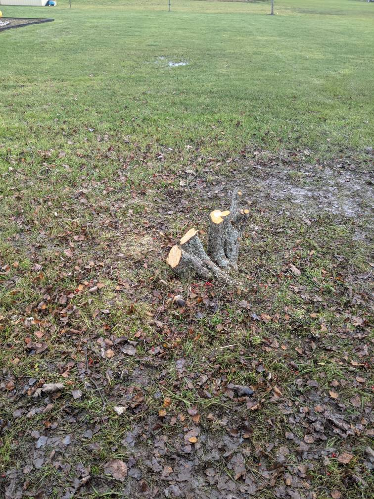

Put some hours on the backhoe this weekend. Went after 6 or so stumps all successfully.
However the Oak stump, even using the sawzall to cut all the surrounding roots, won't move. It's only about 12" across at the top of the stump. The stump was cut close to the ground, so no leverage and the BH bucket won;t go under since so many side roots. This stump won;t budge even the slightest. Have too many other projects, so will see about getting the top cut down a bit and bury or burn.
However the ones I got out make that whole area easier to mow. So I consider this kinda successful.
A few smaller/older stumps actually came out with the FEL bucket, which was nice and quick.

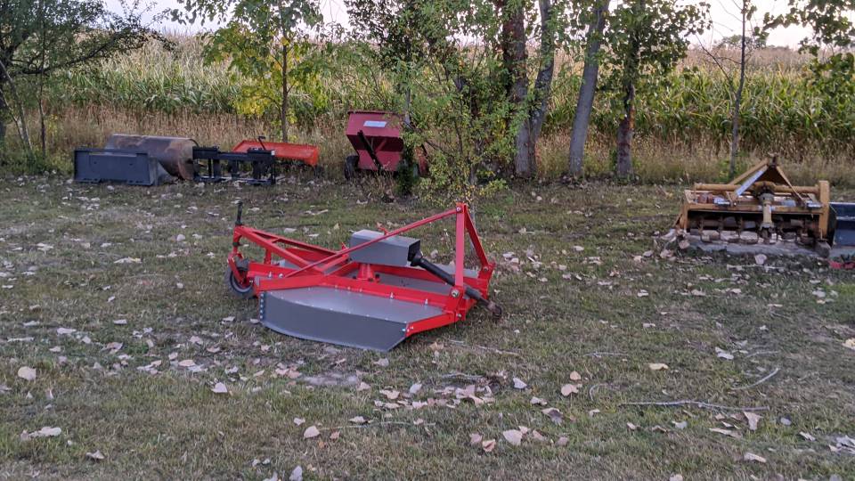

In other news, I mounted the gearbox today, filled it with oil and let 'r rip on the ol' PTO. And let me tell you...she hums.(I'll film it when I put the blade bar on) Speaking of the the blade bar, put it on my balancer and I've got a bit of work to do. It close but not close enough for melt liking. I guess 55 years of beating up saplings, grass and, who knows what else can put something out of balance.
Finally, My neighbor's father-in-law is a head machinist and is making up new blade bolts for me as JD wants $70+ per bolt and $25+ per nut no matter where I looked. Should be taking it to mow this weekend if everything works out as planned. (I'll video that too)PXL_20200921_232611509.jpg
