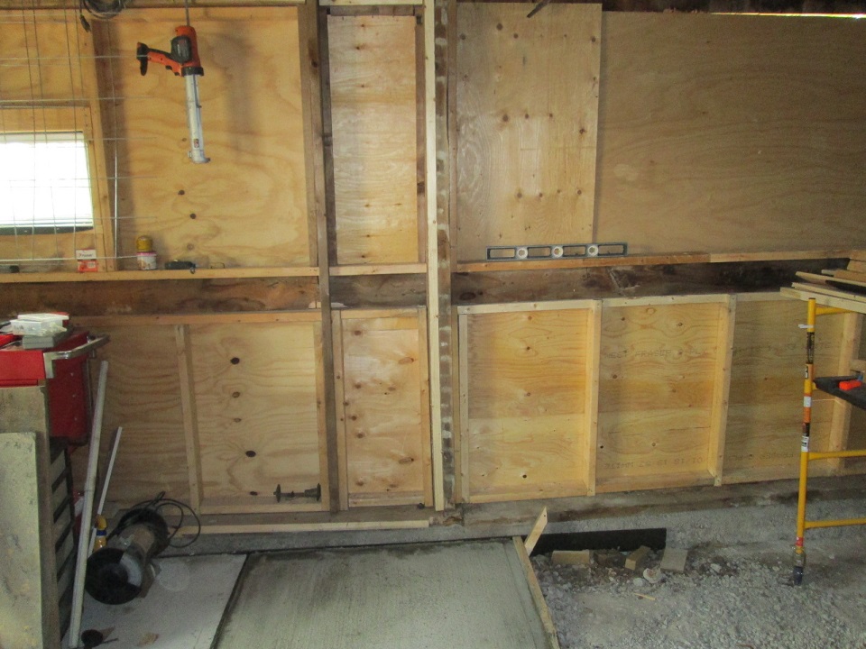

Its a 2 bag mixer, about 8 bags each pour. Constant shell game of moving stuff around in the garage to have enough work room. I've been pouring 4'x7'pads. Doing it by myself, any larger and the cement starts to set too soon for me to finish it.Thickness ranging from 1 1/2" to 4" depending on the floors condition.

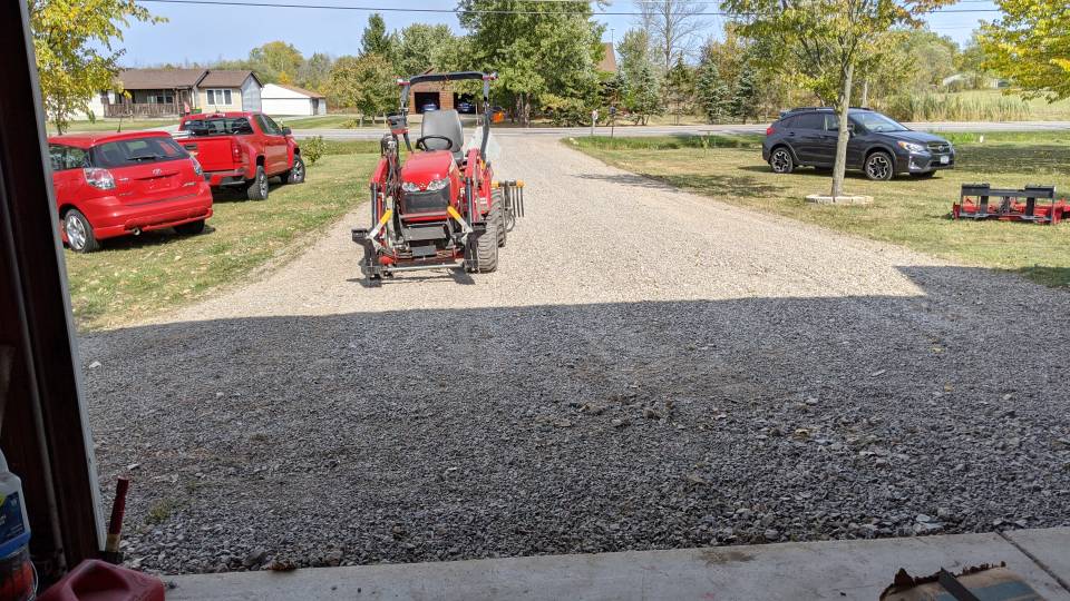

Got out my back blade, box blade and rake with gauge wheels and redid the driveway. Looks 1000x better than it did and got it gently crowned ahead of fall weather and winter. PXL_20200926_184823001.jpg

I like that, I like seeing a well-tended gravel drive, it's a thing for me.

Same here. I do the driveway about 2x a year. 1 time early after things dry up a touch in the spring and in the fall before the winter wet season. I just did an old friends driveway last weekend that hadn't been done in 30 years. It was so refreshing to do it as I drive by that house almost daily.

Me, I got a blacktop drive, but people have gravel drives around these parts, and some of them look like total dreck. When I see one kept up, it looks so nice! If I had a gravel driveway, I'd baby that thing, it would be immaculate.
