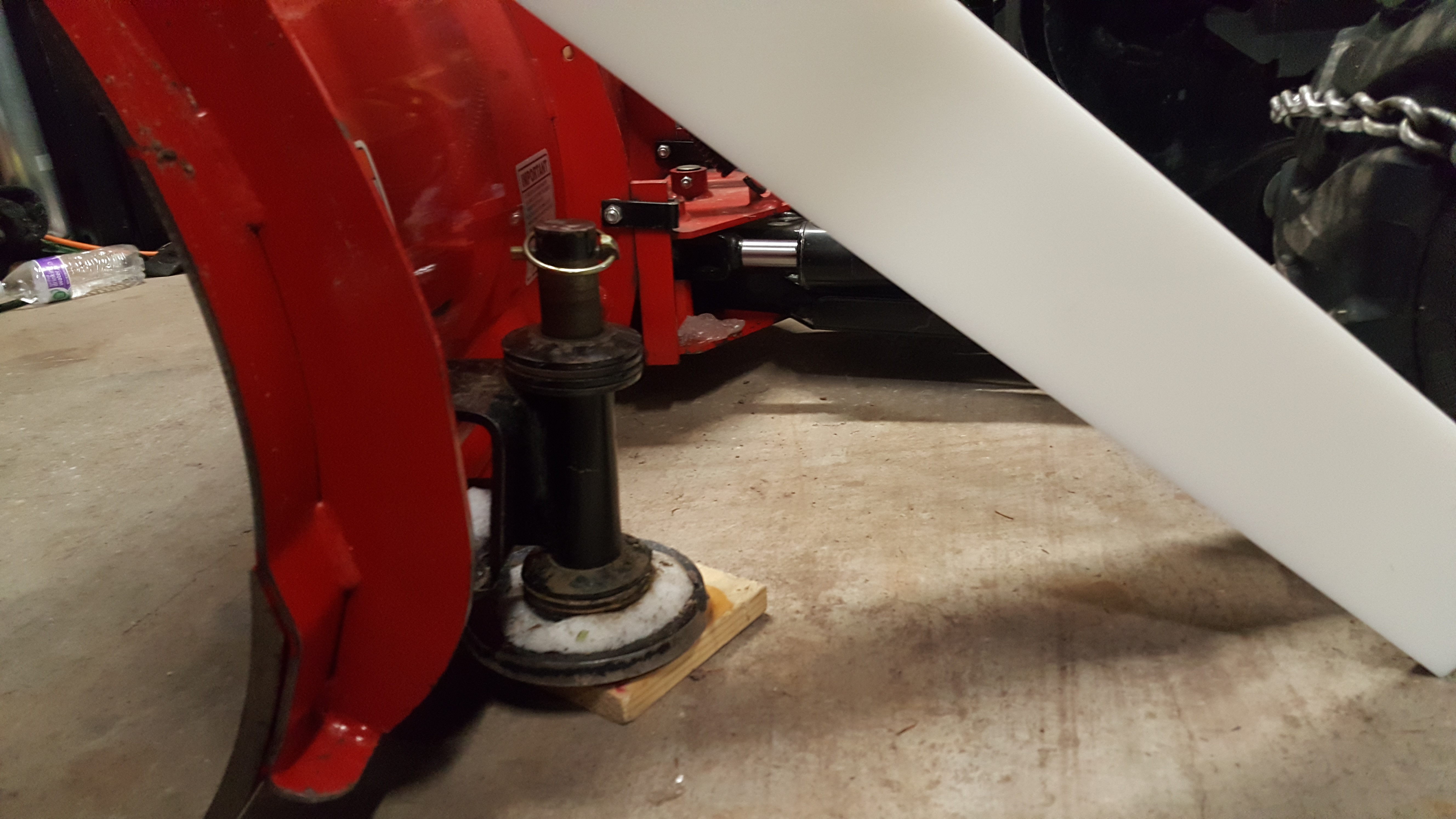

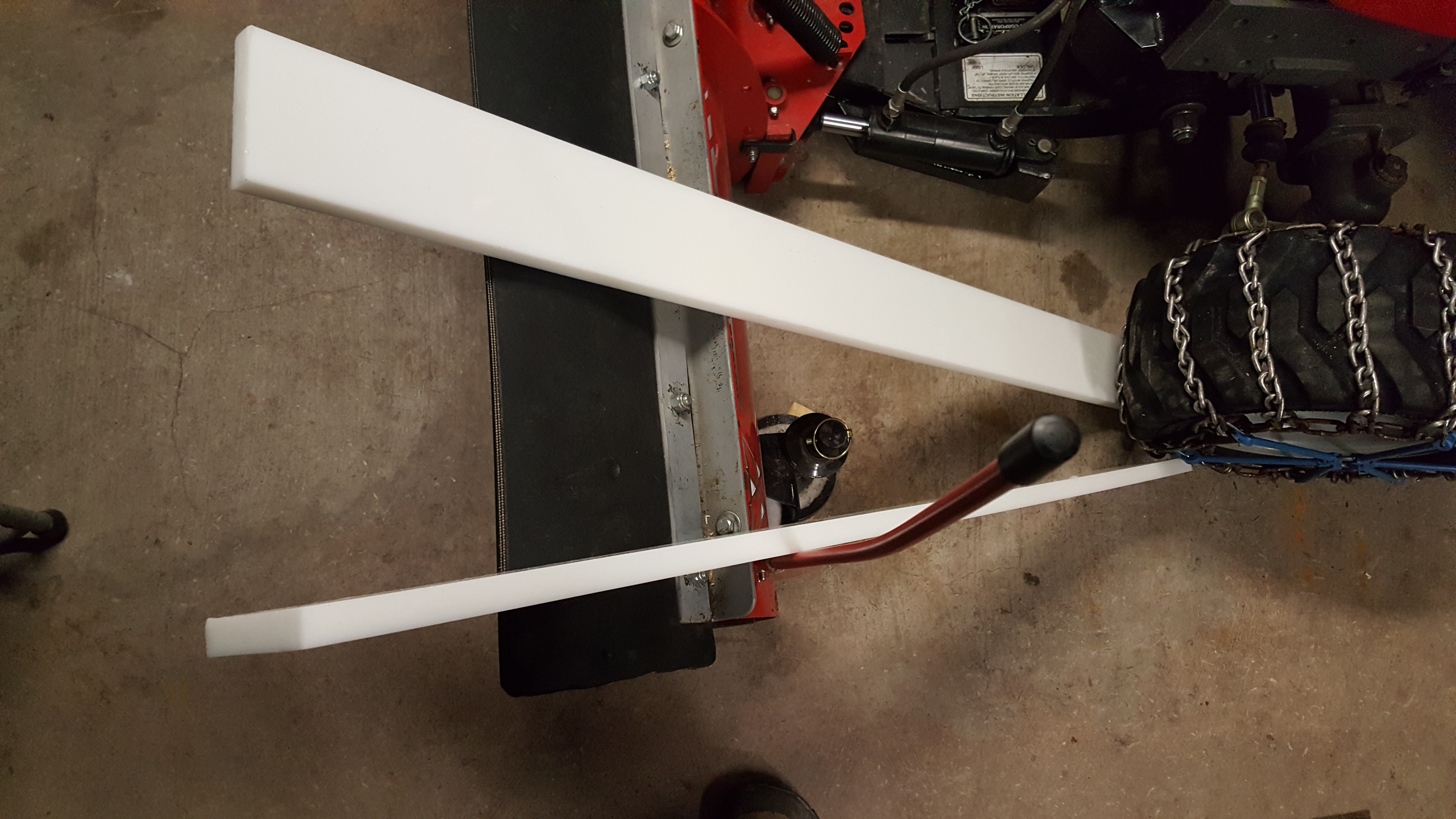

I just received my UHMW - 3/4" x 4" x 48", ordered 2 lengths at (Amazon) $31.60 each with about $11.00 shipping.
I have been thinking about using this product for quite a while, for my skid shoes on my MF 2340 Dozer Blade & MF 2360 Snowblower (driveway is gravel & roadmix material).
I believe I will use the existing pipe sleeve on the Dozer Blade with a new rod and steel plate (on the bottom) and bolt the UHMW to the plate, maybe able to get a 6" x 12" shoe.
I will drill and pin the new shoe through the pipe sleeve to eliminate any swiveling movement with drilled holes 1/2" apart vertically to allow for height adjustments.
On the snowblower I'm not a fan of putting the shoes on the outside edge of the snowblower because of the hazard of smacking the shoes while snowblowing, but I think this might be the best choice.
My other option is to replace the existing shoe with a larger and longer piece of angle iron and bolt the UHMW to the bottom.
I'm finding it difficult to get started in the unheated garage as it was about 18F in there today, froze my fingers assembling a 4 wheel "Gorilla Cart" today.
I am open to ideas regarding my fabrication of these skid shoes, and I know there are going to be good ideas from all of you.
Here's a couple of pictures of the UHMW leaning against the Dozer Blade and the existing MF skid shoe.
KC

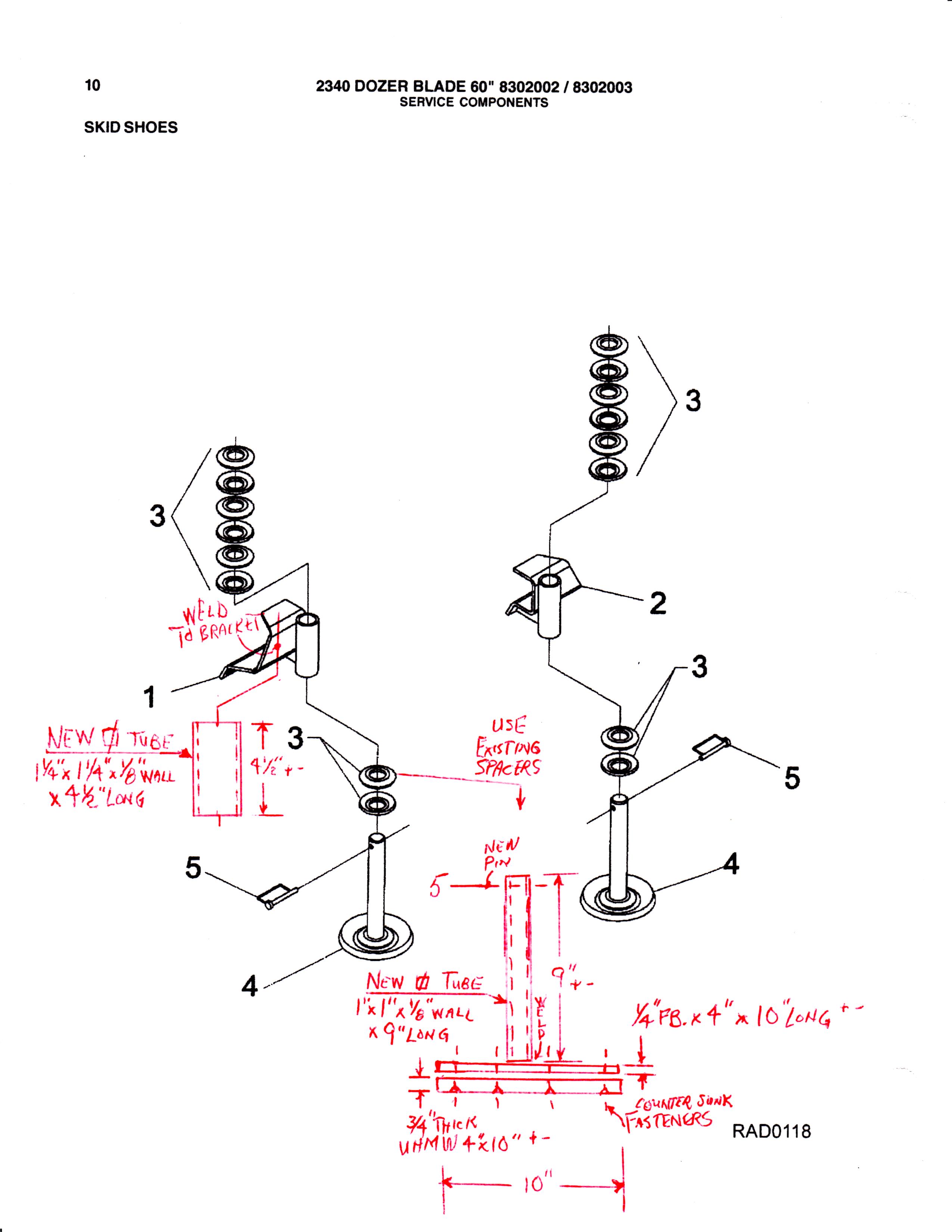

Update on my Dozer Blade UHMW skid shoes:
Well it warmed up to 20F today so working in the garage I believed I have figured out how I'm going to fabricate my new skid shoes using materials I have in my small metal rack.
By removing the 2 outer nuts for the scraper blade, the existing shoe brackets can be removed completely from the back of the Dozer Blade.
I'm going to cut a piece of square tubing 1..25" x 1.25" x 1/8" wall about 4.5" long, clean up the inside so the new square tubing 1" x 1" x 1//8" skid shoe will slip up/down when inserted.
I will weld this new 4.5" long tubing to the existing skid shoe bracket next to the existing round tube on the bracket.
Then I will cut a new piece of square tubing 1" x 1" x 1/8" wall about 9" long and weld one end to a new piece of 1/4" x 4" flat bar that's 10" long.
This new piece of flat bar will have the UHMW cut piece, 4" x 10" which will be counter sunk and fastened to the bottom of the flat bar.
This existing skid shoe spacers/washers will slip over this new square tubing and will function with the same vertical adjustments as the existing skid shoe.
By using square tubing instead of round tubing the new skid shoe will be fixed in place with no rotation of the shoe.
And by being able to use the existing spacers/washers makes all of the vertical adjustments just as easy as before.
The existing 6" diameter skid shoe has a 28 square inch surface area, and the new skid shoe has a 40 square inch surface area, which I think will make a difference.
So far this is "Plan B" and during my fabrication I just might be going to "Plan C", might increase the surface area to 6" x 12" (72 square inch surface area), or somewhere in between.
Here's a little sketch that may help others visualize my new skid shoe better:
KC

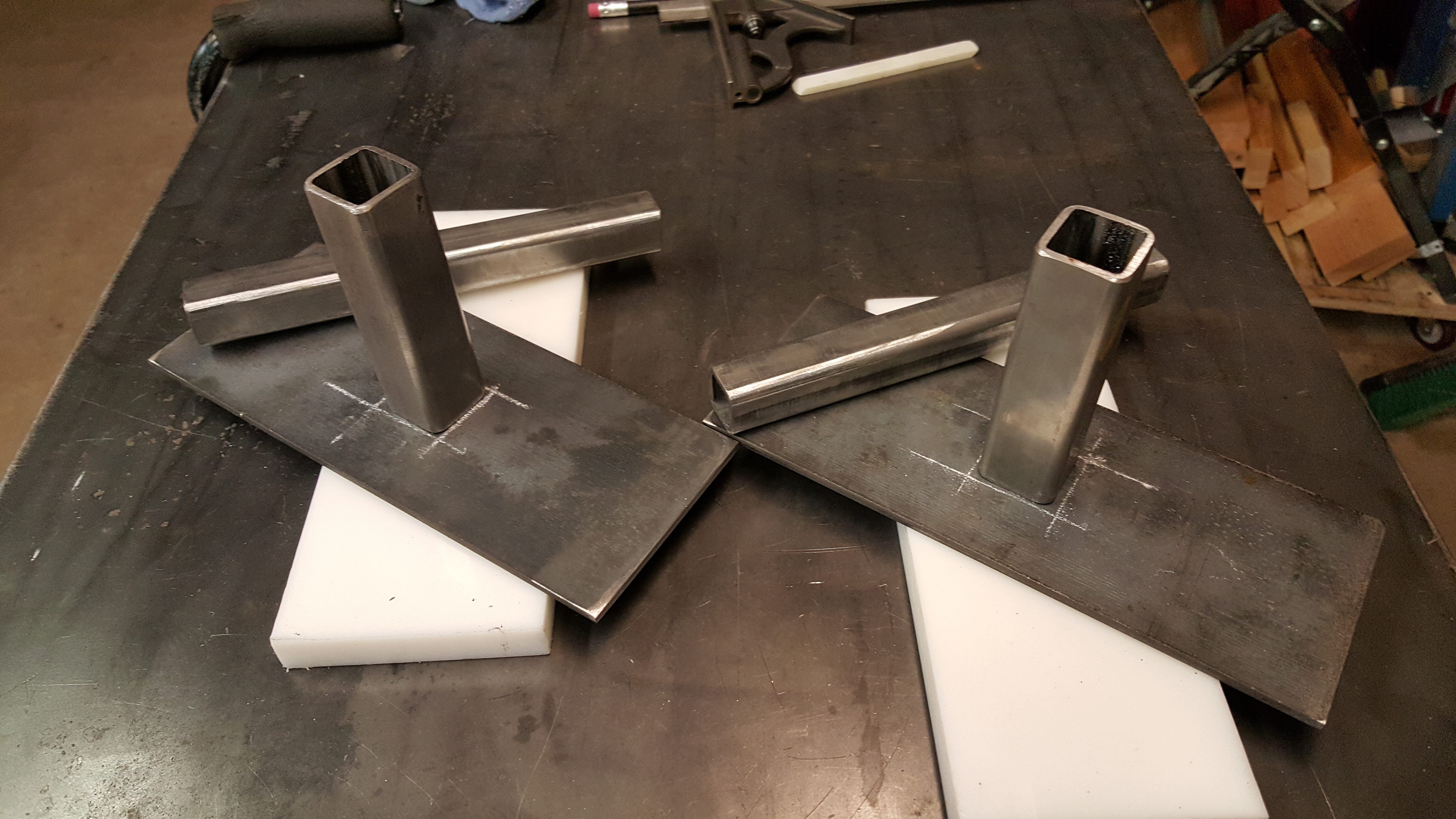

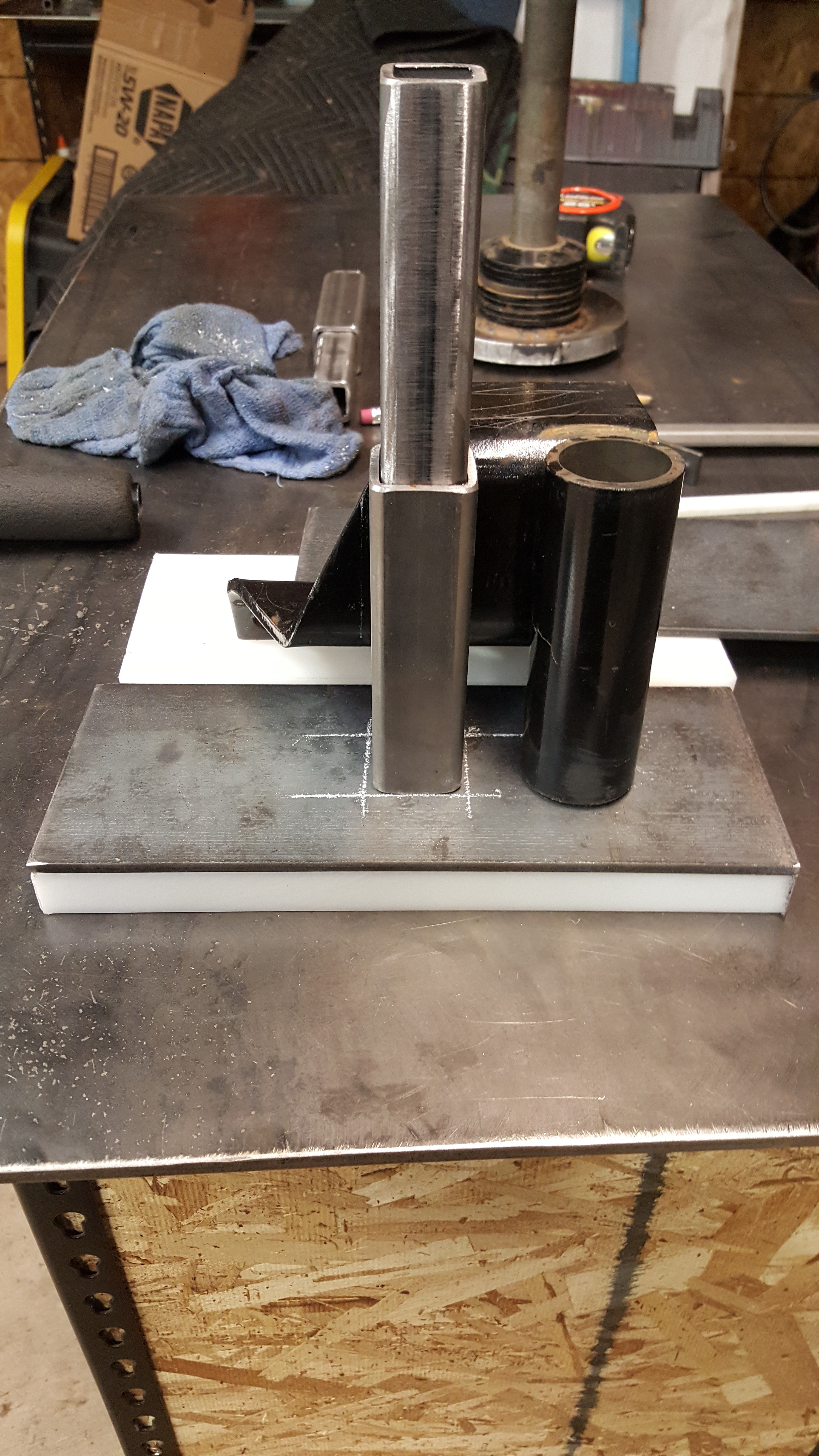

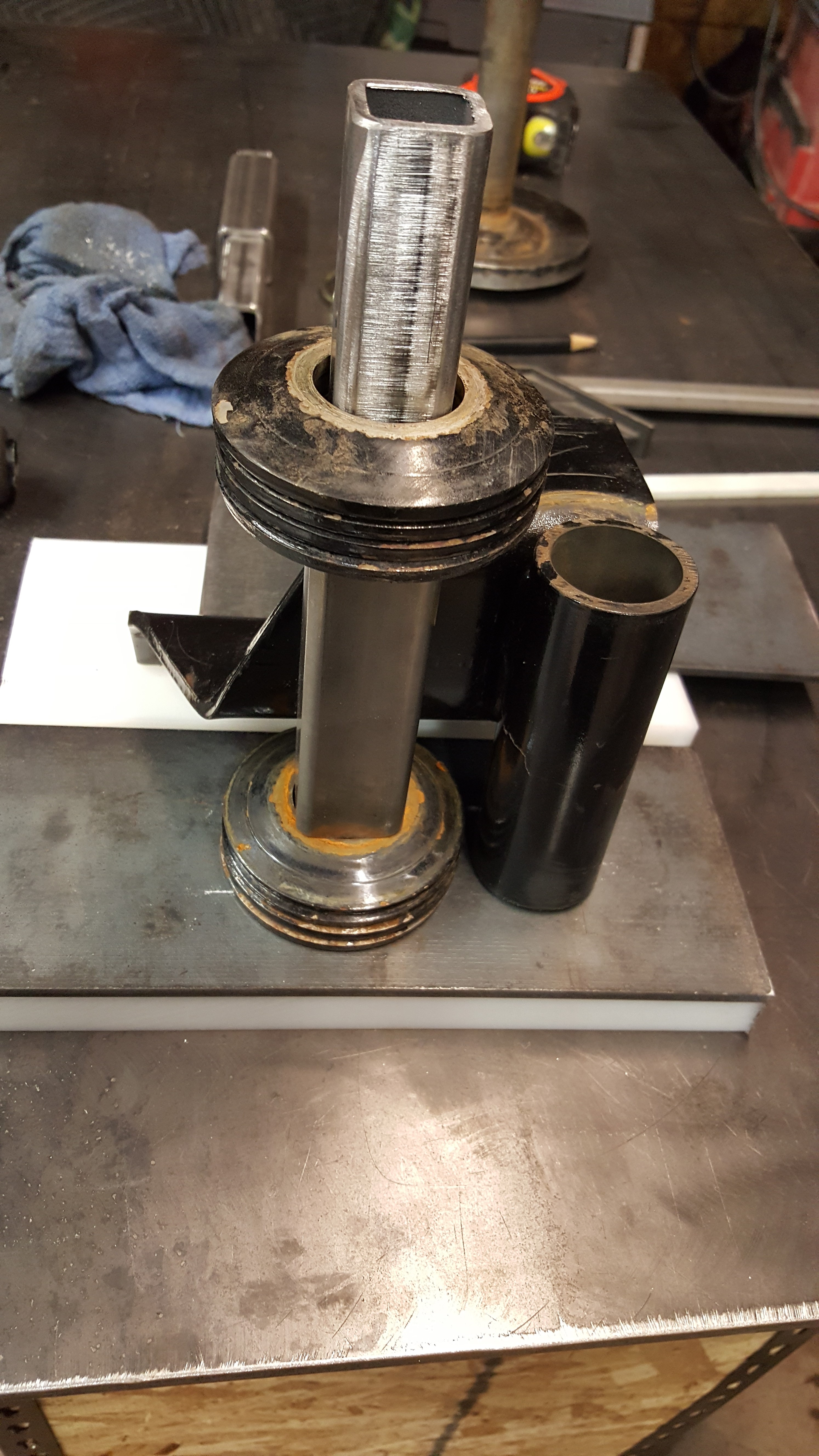

Gene, here's a look at my progress with the UHMW skid shoes for the MF 2340 Dozer Blade (previous post #671 & #672).
I cut all of my pieces yesterday and plan on welding/assembly the parts today.
Pictures of the parts:
KC
(for this project update see post #681)
KC
View attachment 679097 View attachment 679098 View attachment 679099

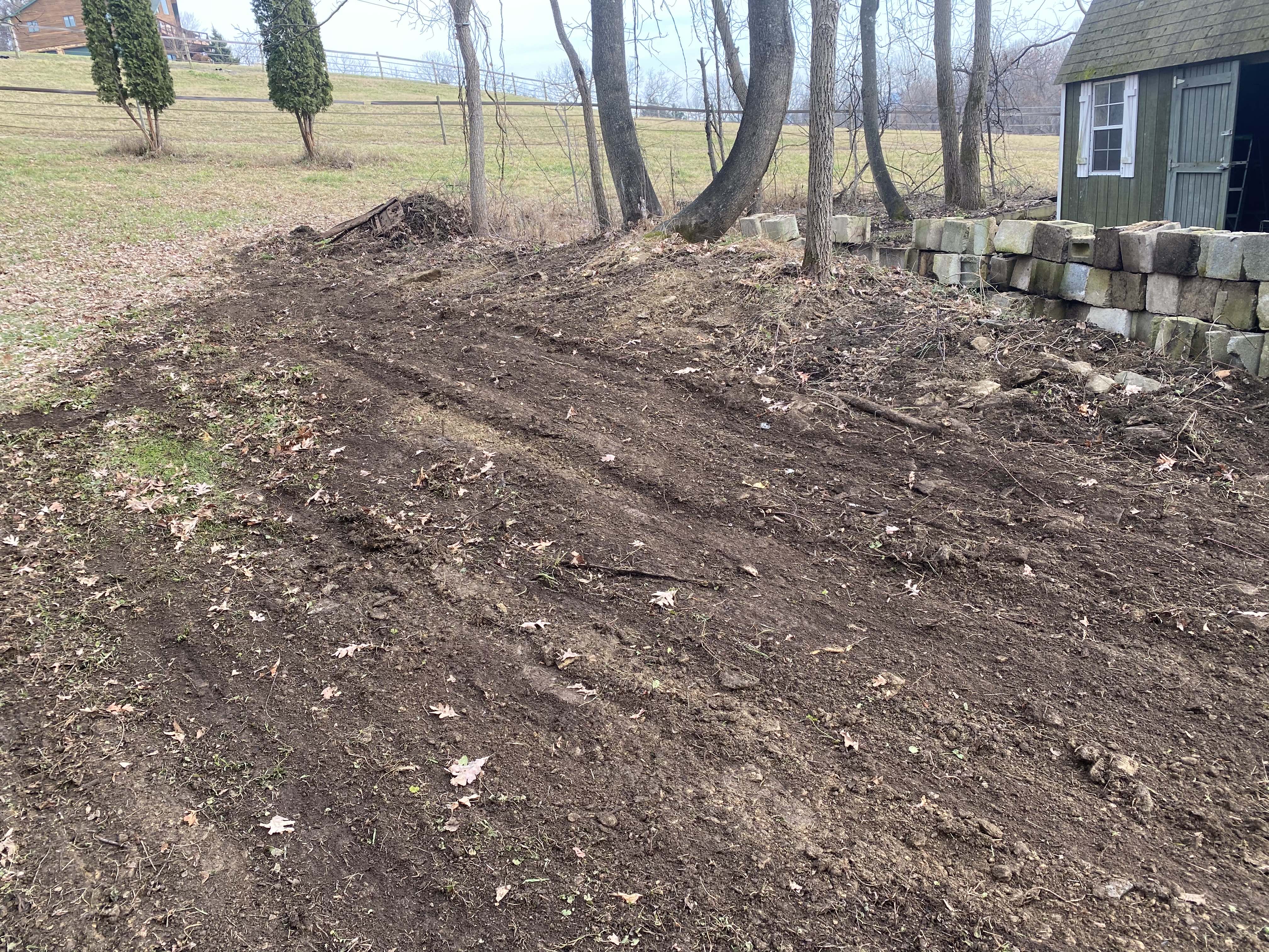

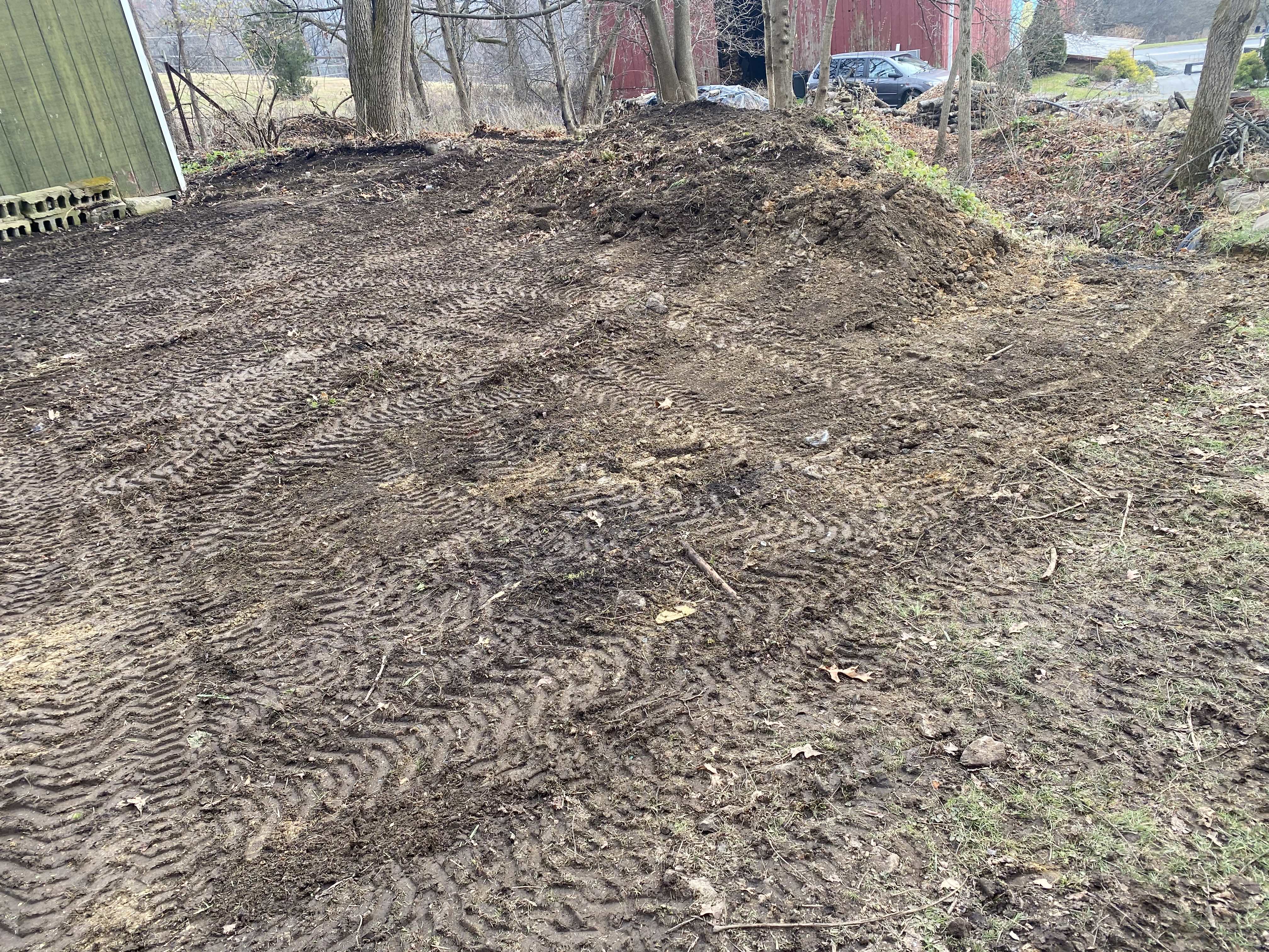

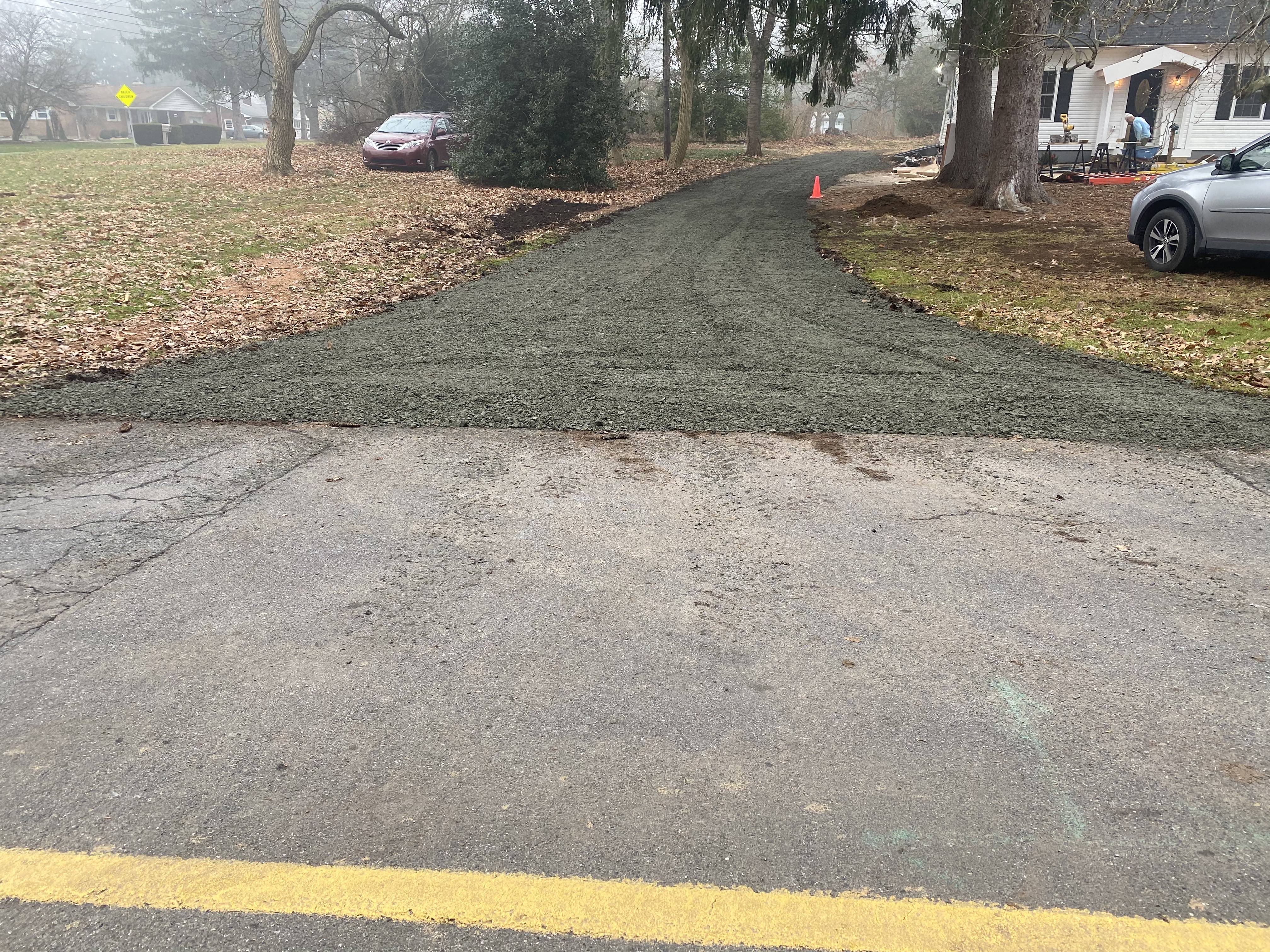

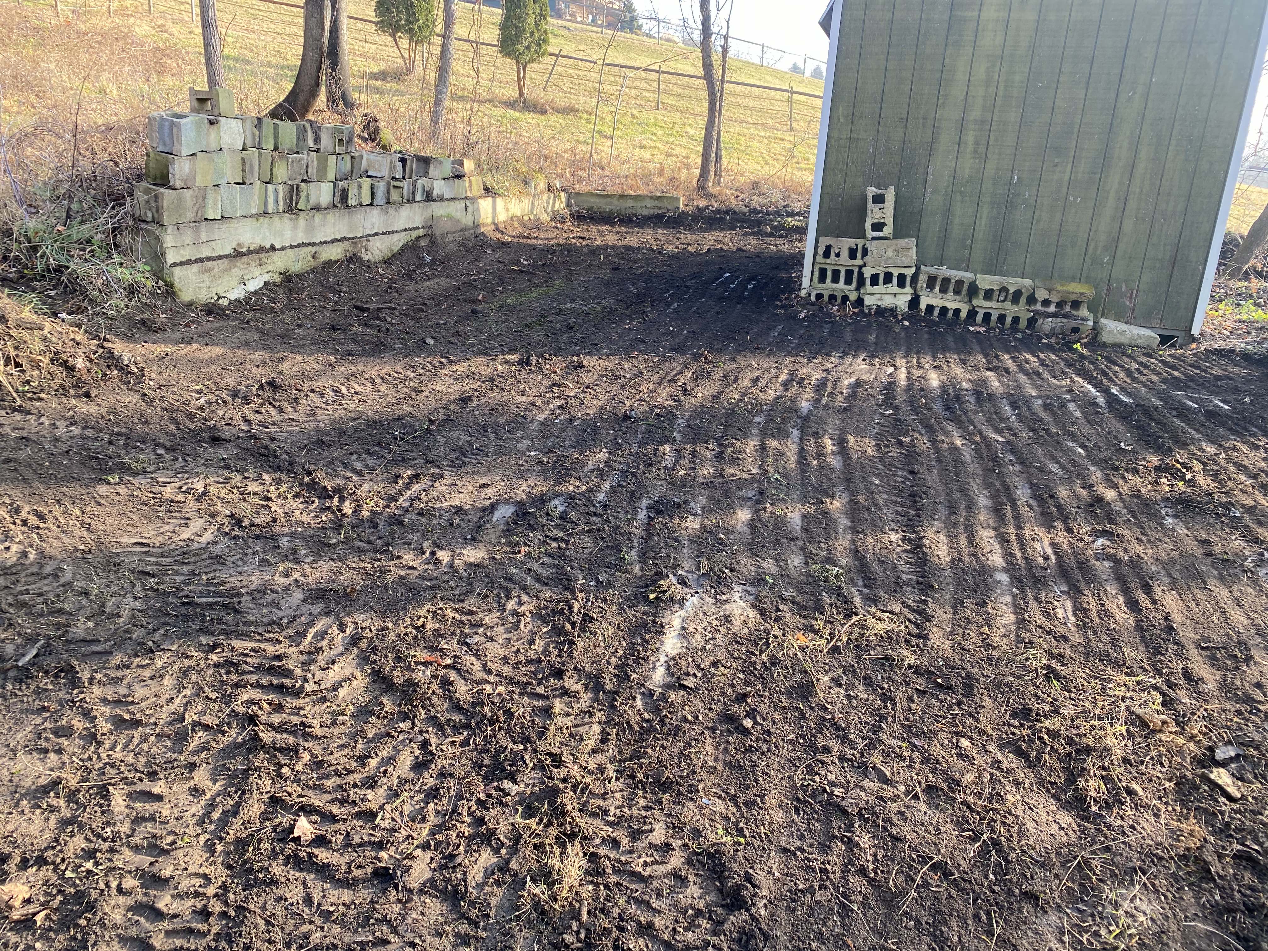

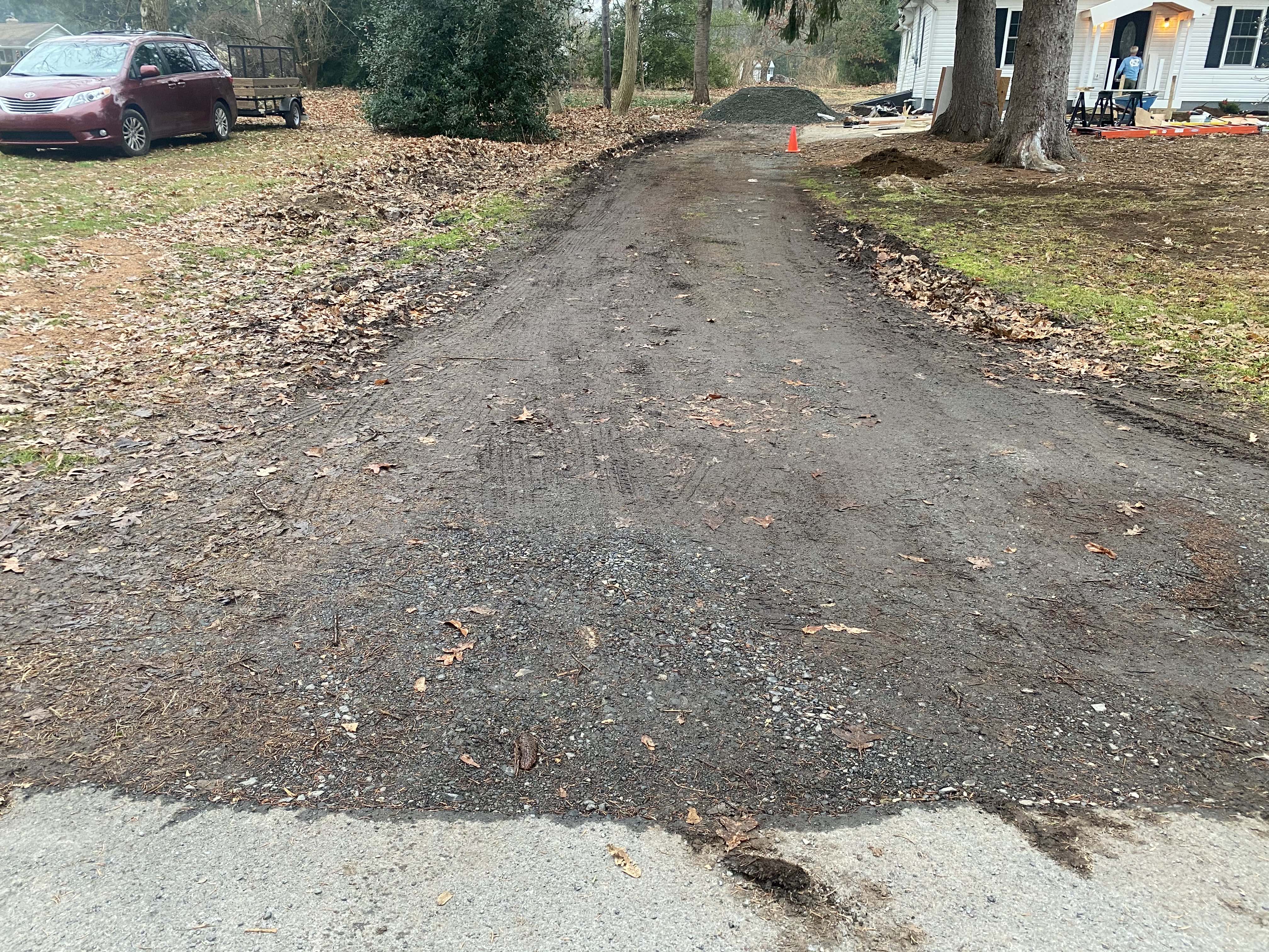

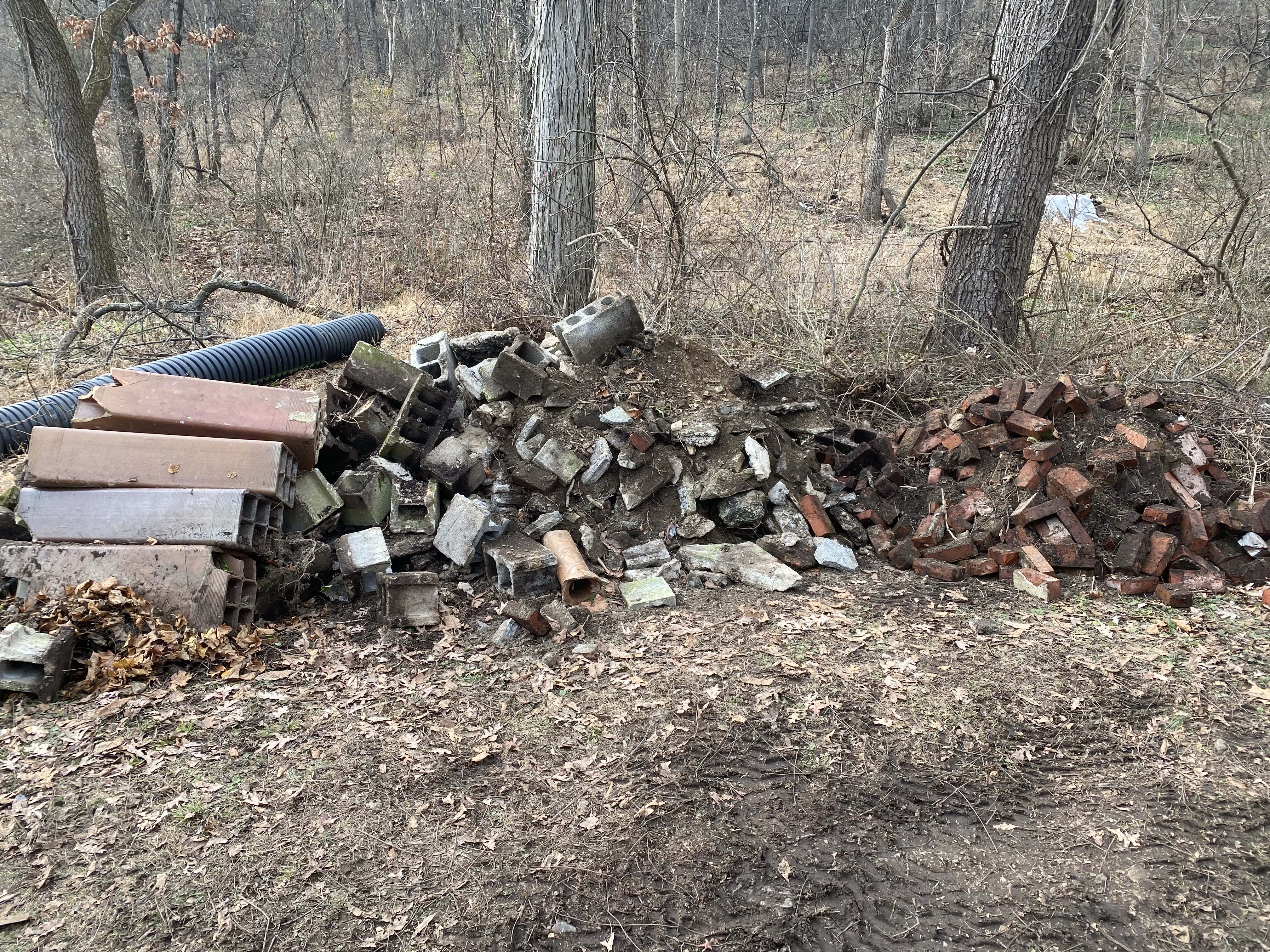

Busy two days, last jobs of the year.
Bunch of small area grading and moved a bunch of rubble for one customer.
Driveway surface for another.
