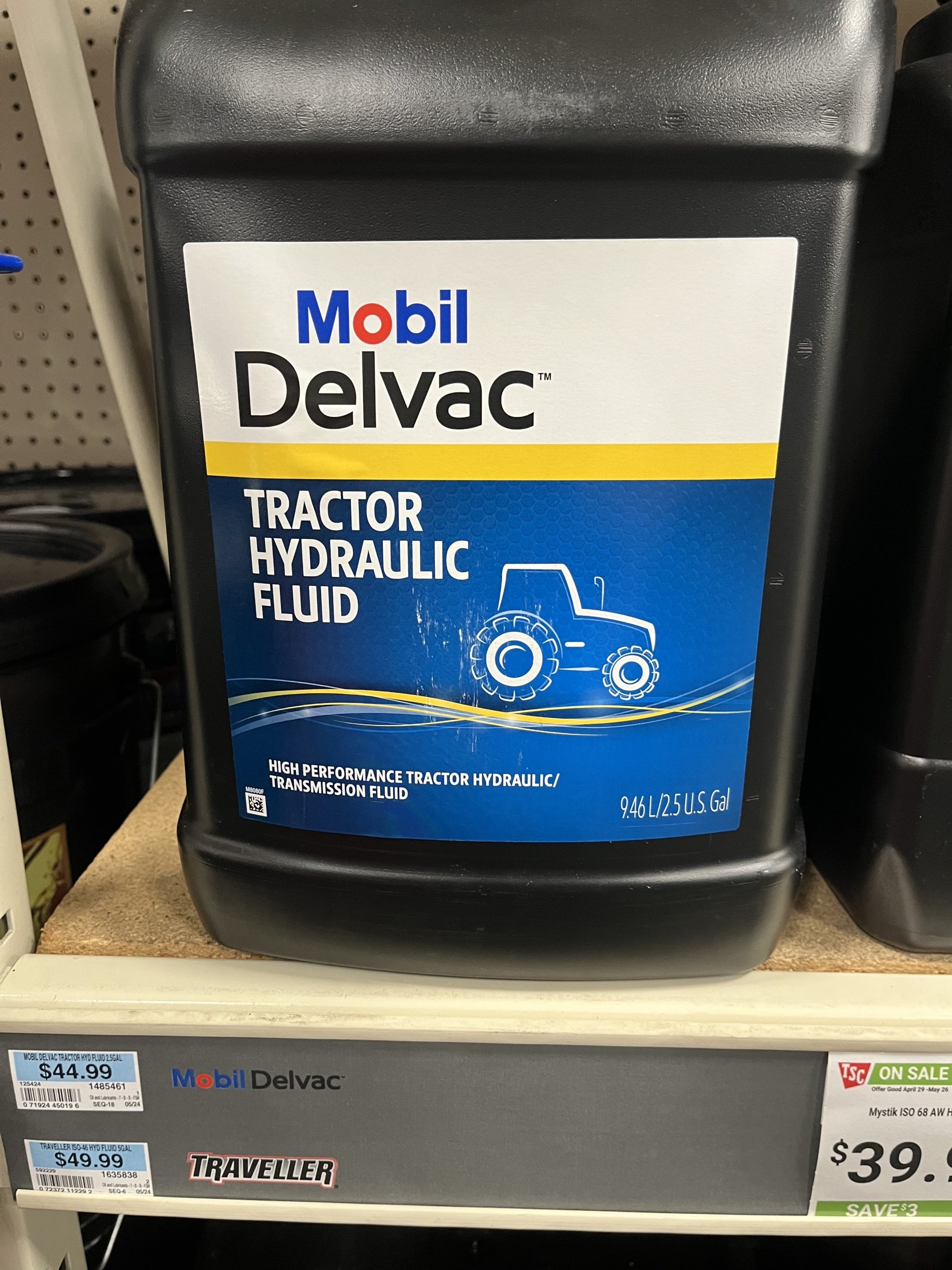

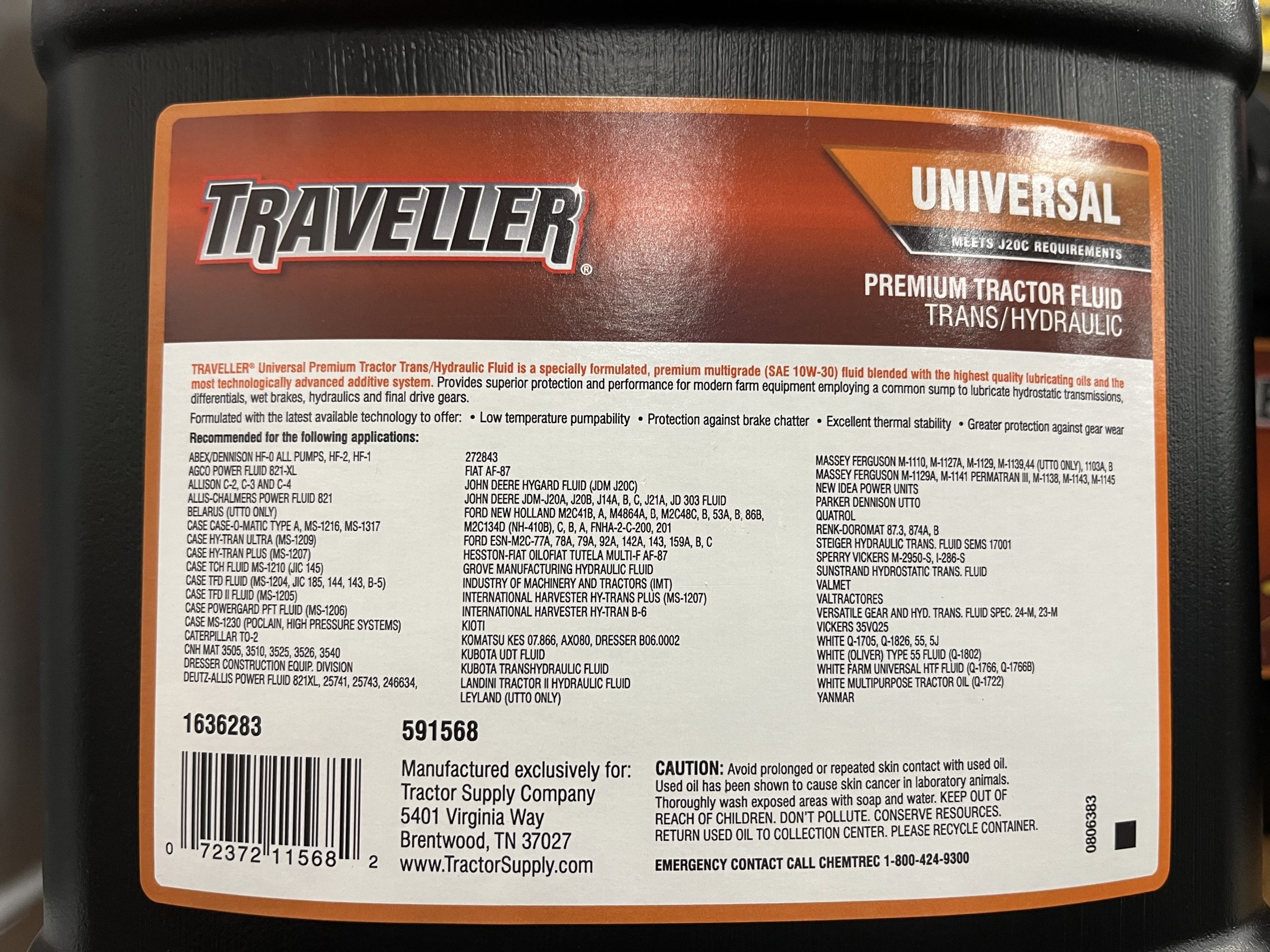

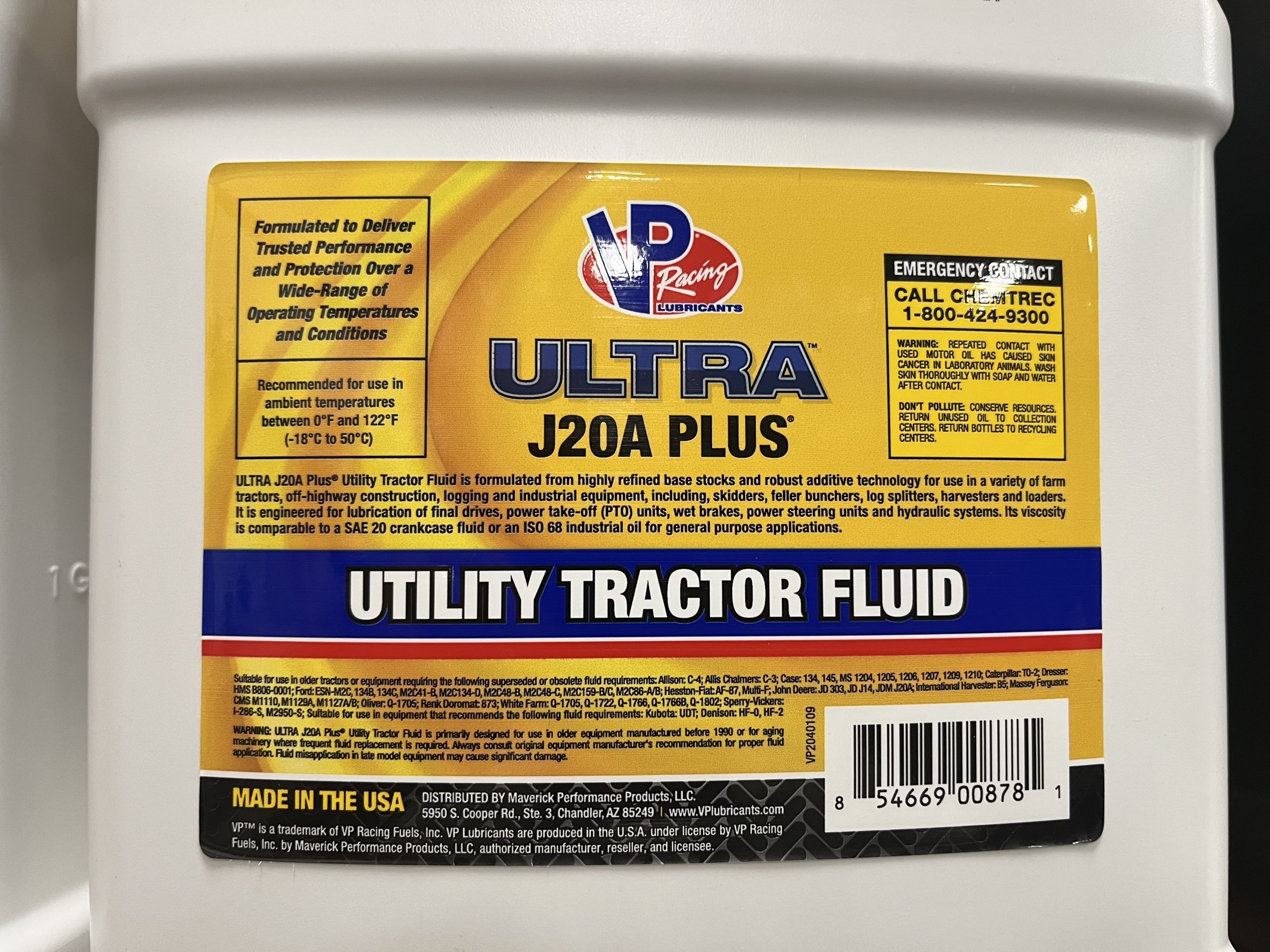

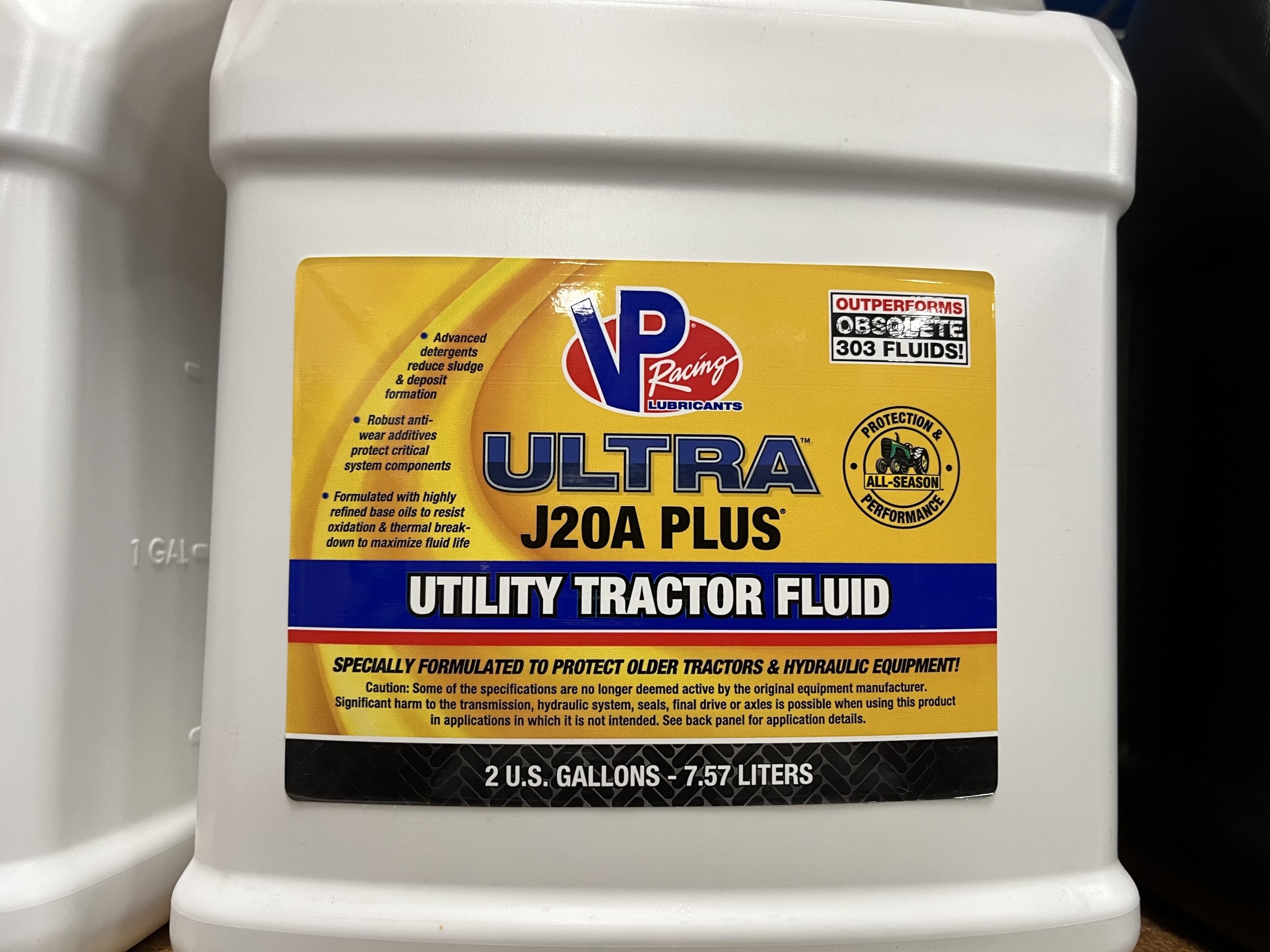

After looking all over the place to find what transmission hydraulic fluid should I should use in my Montana 4940C no information really was found. I realize it needs to be compatible for wet disk and wet PTO applications. My question is what oil would you use? I have a few options below.

I use delvac in my Branson 3515h. It works really well. Almost no whine and strong hydraulic functions.its the same as Mobil 424.

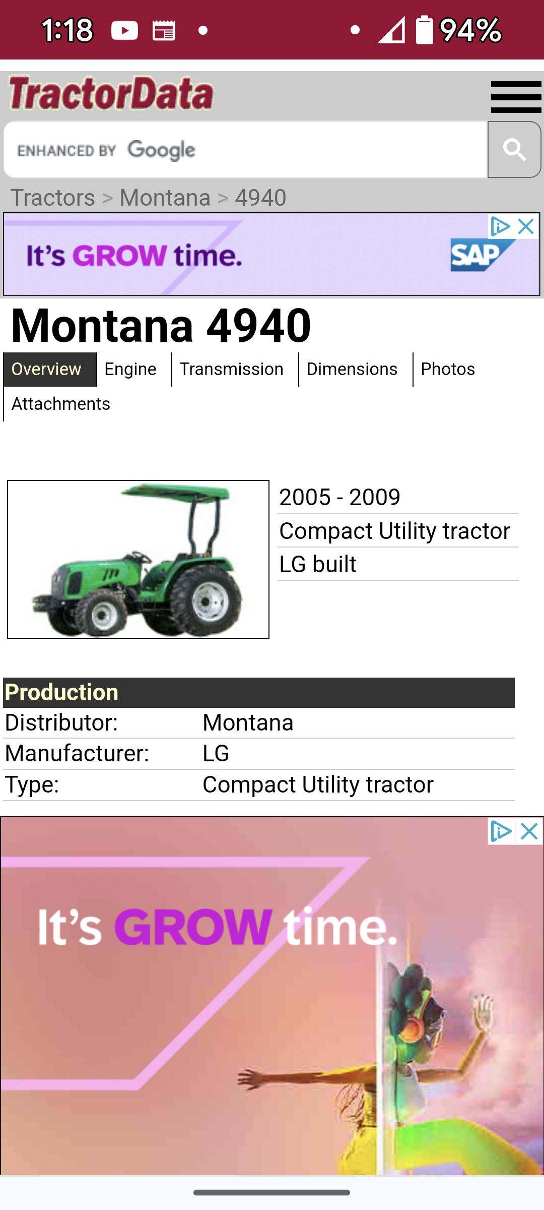

My LS (Case IH) calls for Hy-Tran sold by case for $95 per 5gal.
I think LS built some Montana tractors.
Might also be TYM. I would try to find out what tractor maker made your tractor and then look up one of their owner manuals.
   / What Hydraulic Oil?? #5
Montana 4940C
Your tractor was made by LG which later became LS.
Hy-Tran will work
