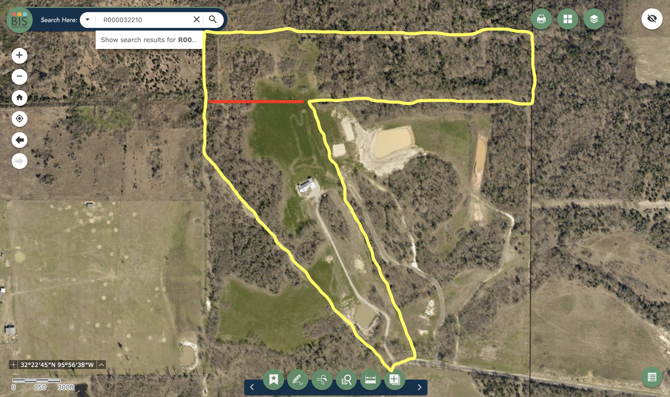

I posted one of those "I'm buying my first tractor" threads some months back. I received A Lot of great advice from you folks, and I appreciate it. My wife an I are in our new home with 39 acres, and are loving it. I was blindsided by the MoneyMan in the family (my wife) once we moved in when she said, "we can't afford a tractor right now." OK, plan B began. I have rented a tractor/bush hog twice since we have been in the new house. For all those folks who give the advice to rent one for a days or a week, THAT is the best advice to give the new tractor shopper.
The tractor I rented gave me A Lot of info to understand what I liked, didn't like, need and didn't need. I found that there are not a lot of places that rent tractors/bush hogs. The ones that do, only seem to rent tractors in the 30hp range. I ended up renting a JD 3038E. I rented it the first time for one day, and the second time for one week. I have about 11 acres of pasture, 1 acre for the house and the rest trees. Here are the things I learned.

I'm not too far from you. You did right renting a tractor.
I looked at your property and if you have chances of running over stumps or have uneven ground consider the protection you will need underneath the tractor to protect hydraulic filters and other vital components.
