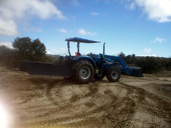

I am wondering if there is an implement I can use on my tractor that would be better to maintain a gravel road and drive way than a box blade with gripper teeth?
It is a private road and drive way that in all is about 1 to 1.5 miles of gravel road. I'm a newbie to tractors and all the implements and just looking to see if there is something out there that would make the job of maintaining the roads easier.
Any suggestions would be greatly appreciated.
/ What implement to use? #2
Take a look at a Grademaster or Road Boss Grader One of these will work good for your application. I have a Road Boss to maintain almost 2 miles of roads.

For maintenance I use a landscape rake with gauge wheels. Easy to pull material back in after winter plowing and easy to reset the crown. Also works for spreading gravel used to fill rough spots. For the ditch line I use a rear tilt blade. I also use the blade for making water bars to channel the run-off away from the road.
