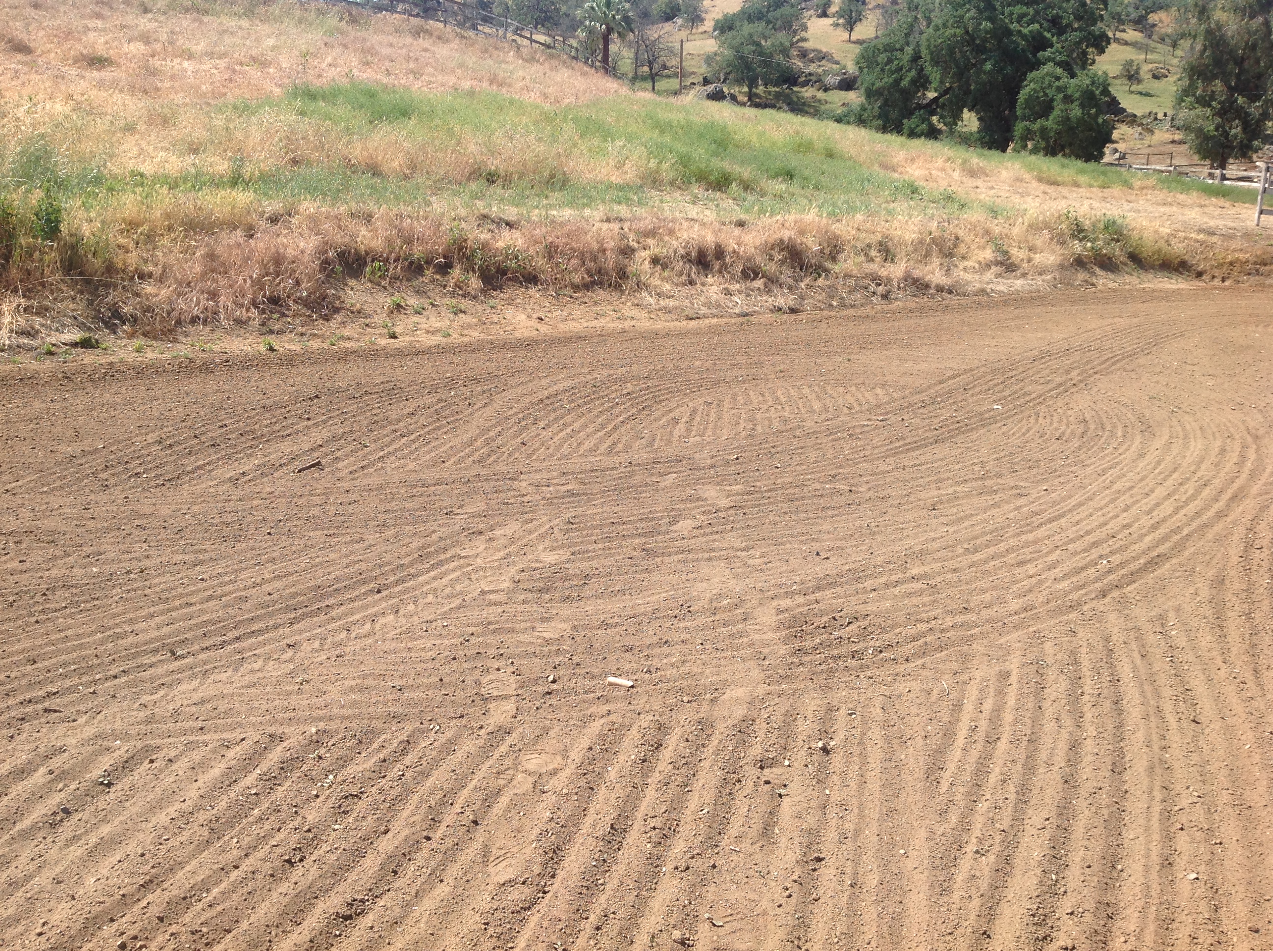

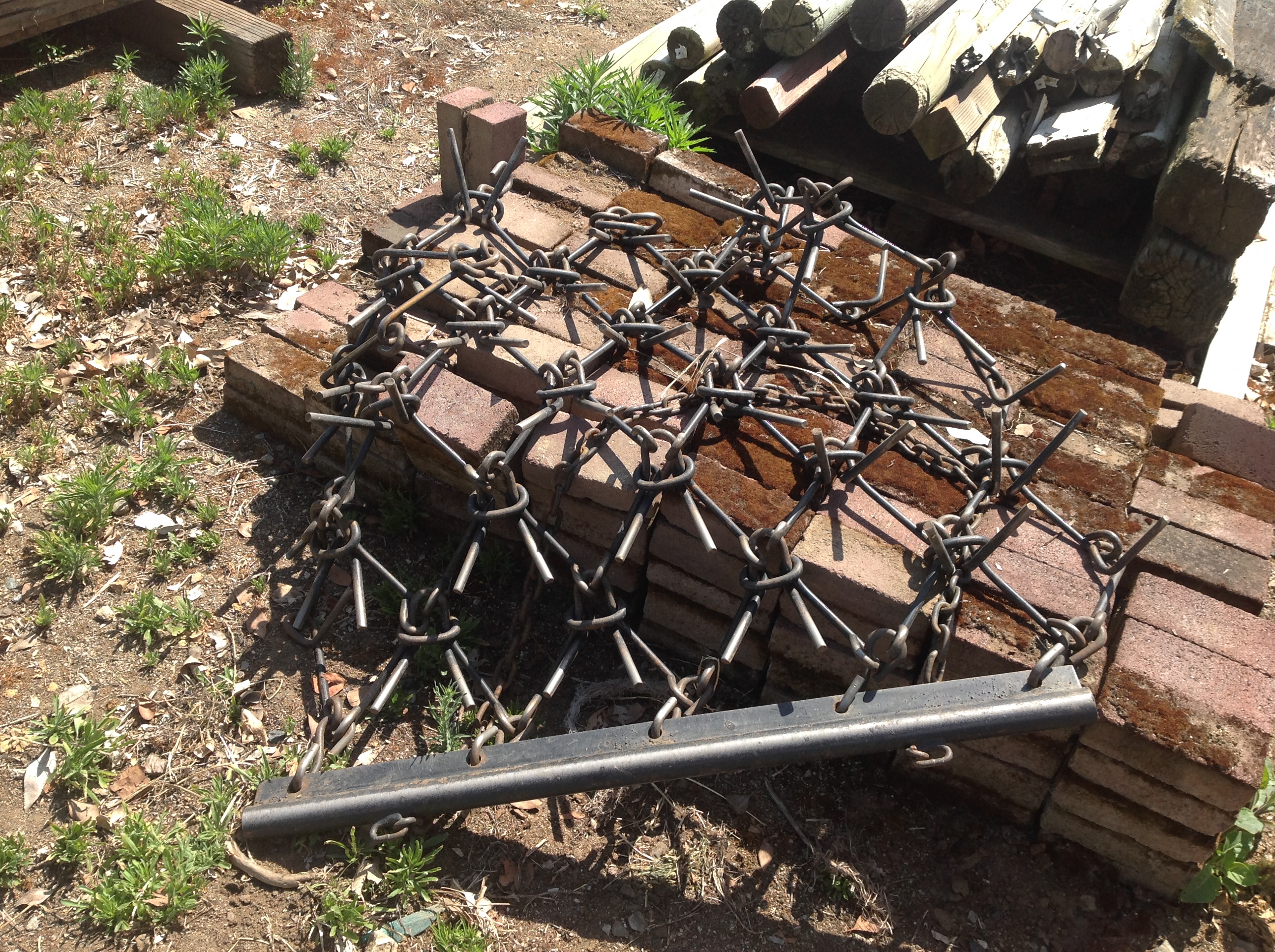

#40
This is an area around my house that I used the roto tiller on to control the weeds and you can see the new growth already cumming up, I ran a chain harrow over it and that did not work to remove the new growth.
Unfortunatly, I don't have the time to plant a crop or another type of grass at this point in my life, way to many projects that are a priority, so in the meantime I just want to turn the weeds over before they have a chance to produce those nasty foxtails and then drag an implement over the top of the new growth, as you can see from the second picture a chain harrow does not remove even the smallest new growth, there has to be some type of drag implement that would cut just deep enough to remove the new growth without over digging the soil. Do you guys know of one?
I appreciate everyone who has posted on my thread :)
