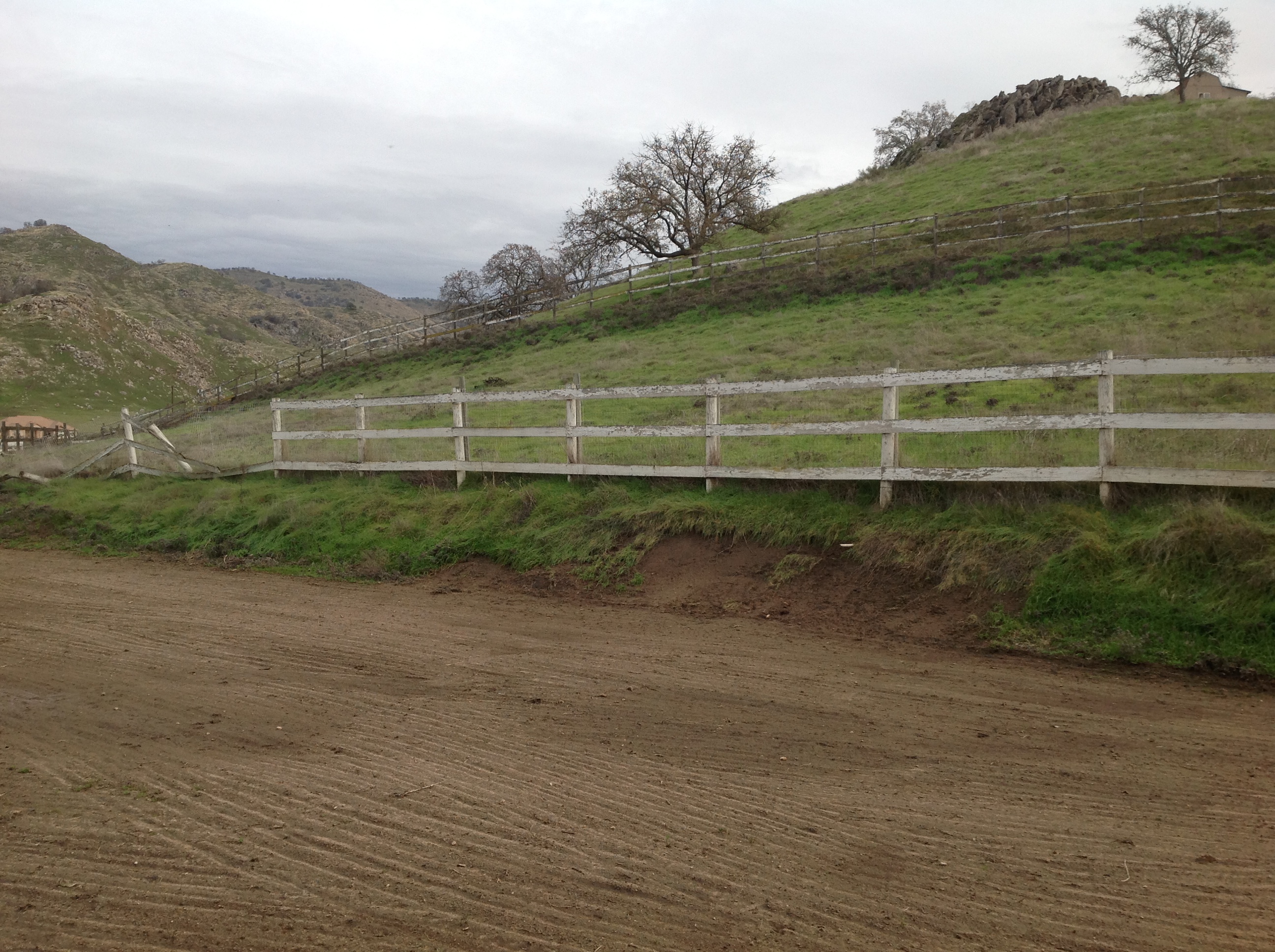

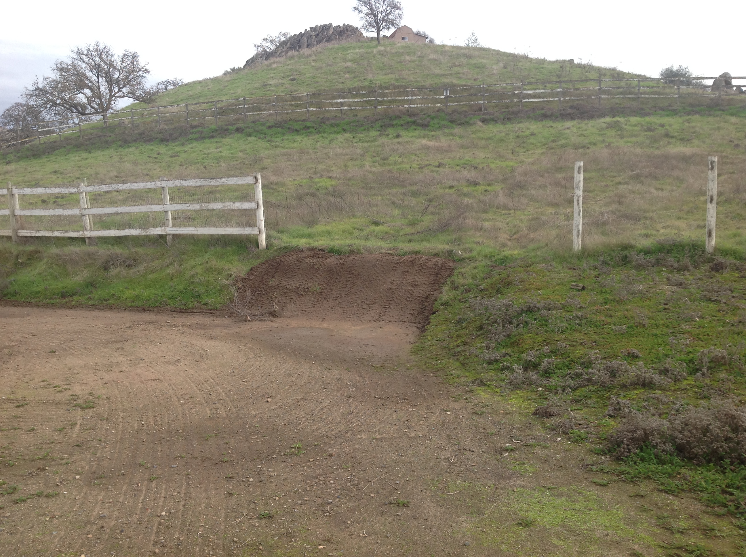

I was looking at spring tooth harrows like the one Jeff9366 posted but don't see any small ones with wheels like you have. My tractor has 32hp. and the rear tires are loaded with rim guard.
How do I work a slope safely, can I use a spring tooth harrow on a slope, or do I risk a mud slide when winter hits.View attachment 508966View attachment 508967
