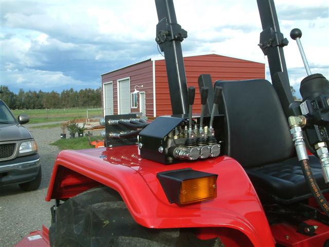

Here are the triple hydraulic remotes on my 2008 Mahindra 5525

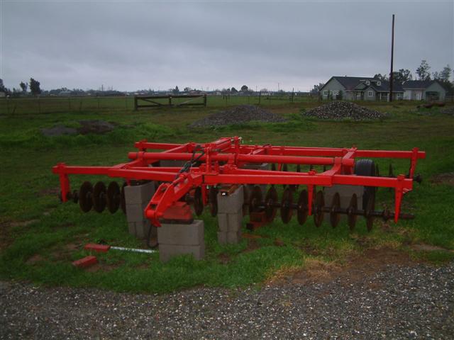

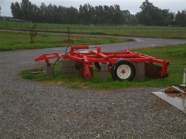

These auxiliary ports are used to operate implements that require hydraulic power (e.g. hydraulic motors on post hole diggers, hydraulic cylinders (rams) on a variety of equipment). For example, my wheel disc has a large hydraulic ram to raise and lower the transport wheels
Dealer installed remotes generally cost $500-800 per unit (including the hydraulic control valve, hoses, hydraulic quick disconnects). I was lucky. When I bought my new 5525 in 2008, the dealer installed the triple remotes for $750--couldn't pass up that deal.
Hope this info helps.

Flusher:
Your rig shows the benefits of flat top fenders.
But that's the problem with places to put stuff, they always get filled up..
