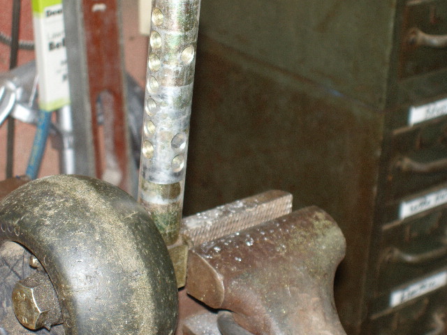

This is my fix to the mower issue. The top hole keeps the deck too high and the bottom hole keeps the wheels off the floor, the added hole gives the mower 1/2" clearance to the floor and it will roll out with out jacking the tractor up.

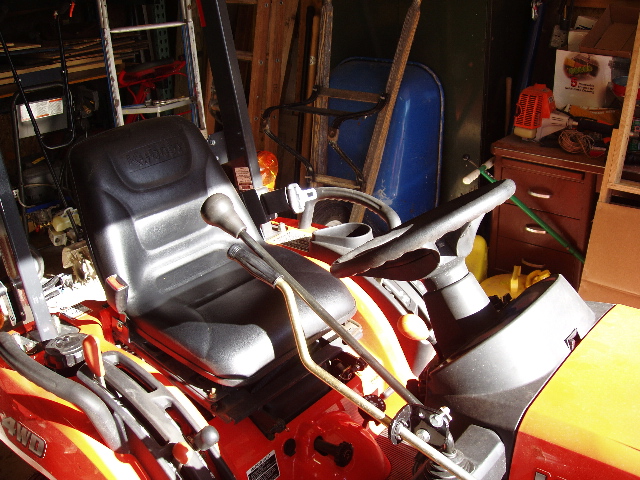

I did forget another issue with the new BX. The snowblower chute crank mount does not allow you to turn the crank unless the lever is in the float position.

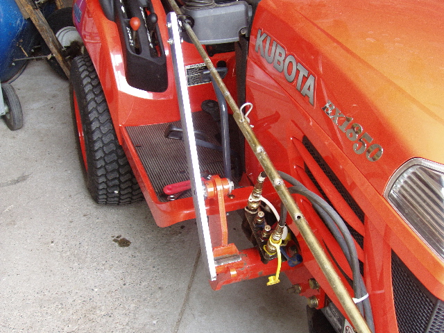

And my solution to that crappy piece of engineering.

No idea what youre talking about. I've removed my deck a dozen times for cleaning/blade sharpening...never had to jack up or lift my tractor do do it, and I have the new BX2350. You do have to wiggle the deck on the way out, but it's certainly not an inconvenience.

Read on back; I have an 1850 which has shorter tires. Both models share the same mower now. I'm sure it will clear the frame on a 2350 due to the taller tires.
