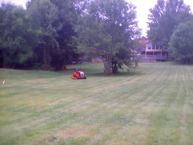

I've had very good service out of my "all in one" tractor solution. My BX23 has done all that I have tasked it with and the fully suspended 60" MMM finish cuts as well if not better than my previous dedicated lawn & garden mowers.
It will not produce a fast cut like a commercial grade ZTR nor will work full size farm implements like a farm tractor either but it does a pretty good job of finish mowing and has it own line of smaller implements to work a garden or upkeep an estate. And it does it all whilst being stingy on fuel.
I can change it from being a dedicated finish mower to a TLB and back in minutes without using any tools.
In my case the BX23 fits the bill.
Good luck
Volfandt
