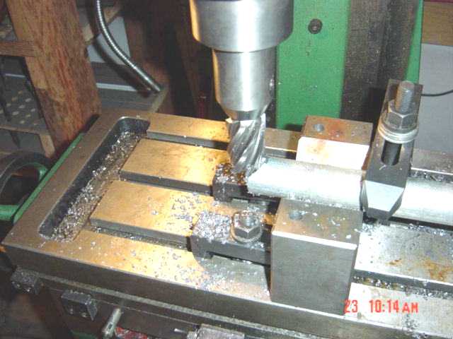

I've been very happy with my Grizzly drill press.
For larger holes I use annular cutters.

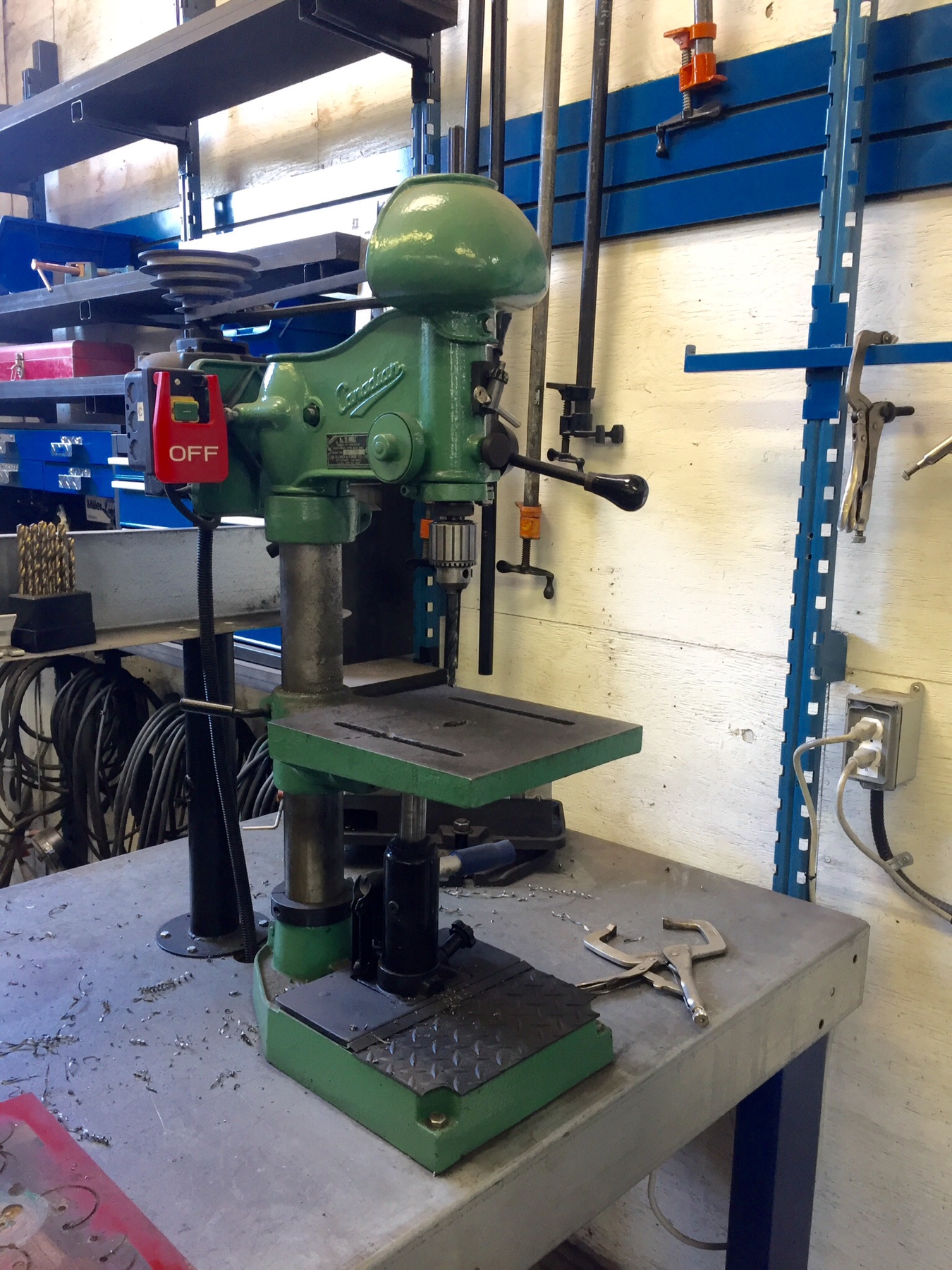

When it comes to "poor man tricks" I think everyone's previous comments have you covered.
Here's my first drill press my dad and I recovered and restored from an old barn on farm land we were renting in the 1950's.
It's the ONLY one I had in the shop for over 30 years. I've restored several other small machines since then, all older with heavier cast iron tables and guards.
Terry

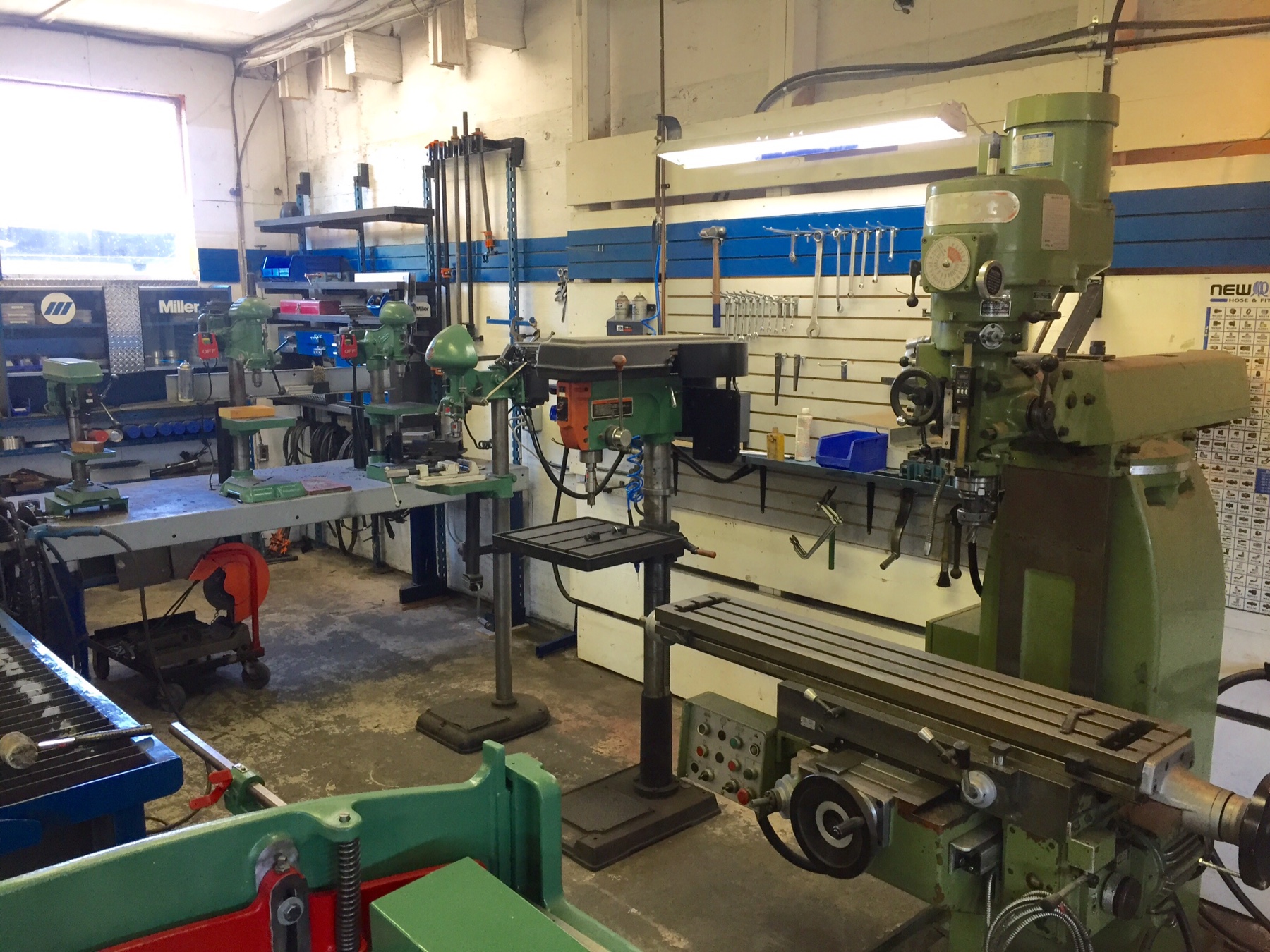

I like the old drill presses best. Well made. My father in law passed two onto me that he had picked up from his work as a machinist. One is an Atlas.
