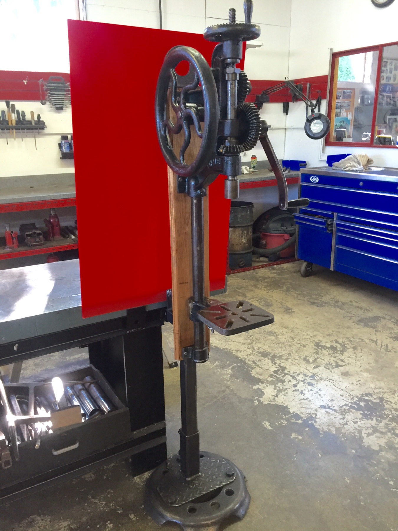

I have a hand crank from 1890 or so mounted on the wall.. It works but I like electric better.
Slow and easy, clamp your work down. -Holding it ......one of these days it will spin free and take a nice nick out of your finger!
For those that have never seen a hand crank drill press, here's mine. IMG_0172.JPG

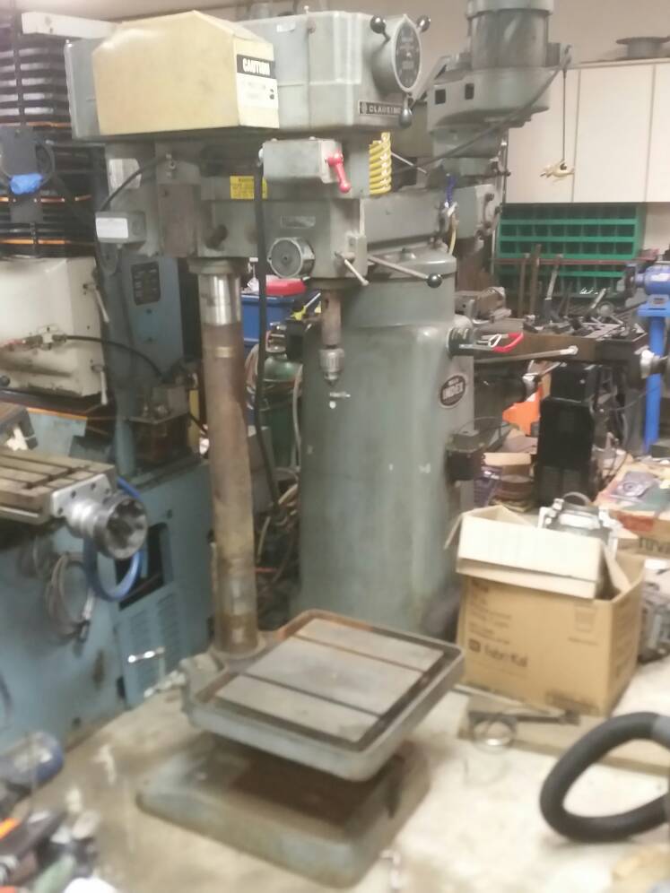

Here's my drill press and mill

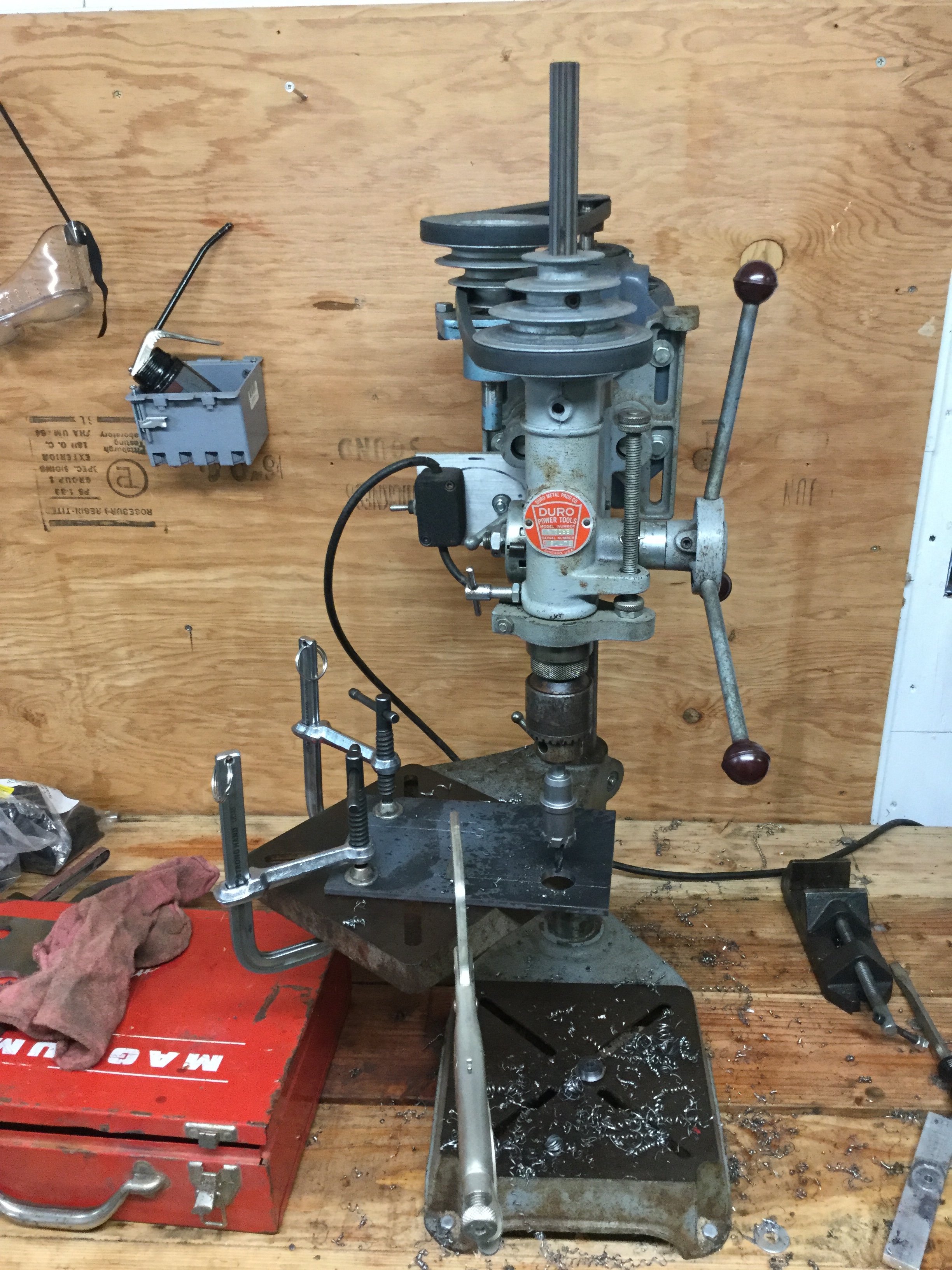

Clamps make for safer and better work.
Look closely at the photo you will see this little 60 year old Duro is cutting a 1" hole using an annular-style cutter with a pilot bit and black plumber's cutting oil.
Pretty much any press will do the job, a lot depends on the set up.

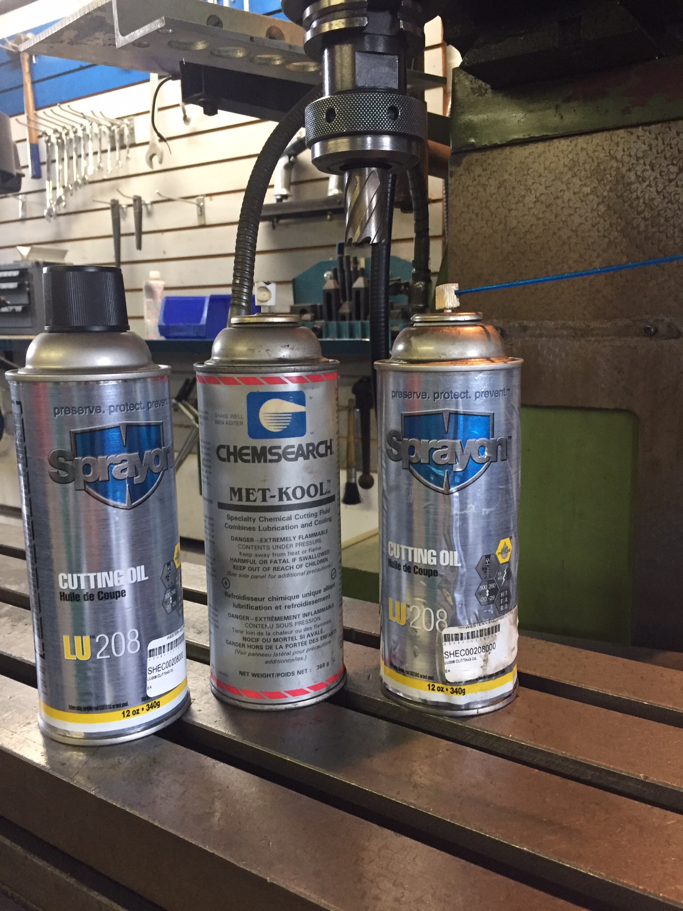

For cutting fluids I like these two:
The MET-KOOL is my fave but this is the last can from a full case I bought long ago. I keep it for those special cuts.
Chemsearch
