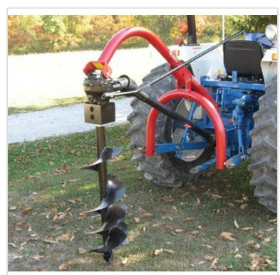

Where are you guys finding these 3 point hitch drill presses? :D
Bruce
:D:D:D
