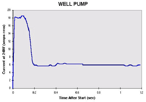

I am unaware of the test conditions; I obtained that at a generator power company website looking for starting current for the OP's 3hp pump. (I thought that for a submersible, his stated current seems low.)
I would say that your numbers are pretty logical with the differential being water column size. Inrush is momentary but real, hence the surge capacity on small(er) generators.

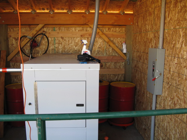

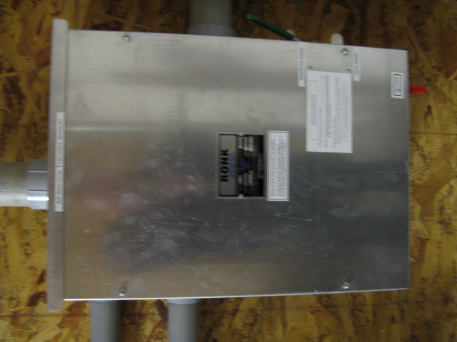

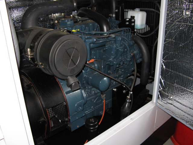

I run two separate systems depending on the duration of the outage. For one lasting a few hours, I use a Mitsubishi MGE6700REU Maximum Output 6,700; Rated Output 5,800. This runs, without trouble, 1hp 260 foot submersible, reefer, 2 freezers, lighting and door openers.
For multiple day/week outages I use a 45KW Kubota/Marelli Generator through 400 amp manual Tfer switch that can run everything at once (7 tons of Heat Pump included.)
Do you know the test conditions for that graph. The test I have done on my 3/4hp pump is that it draws a steady 25 amps before settleing down to around 6.5 amps. My 1hp drew 30 then down to 8. It just shows that every installation is different.
