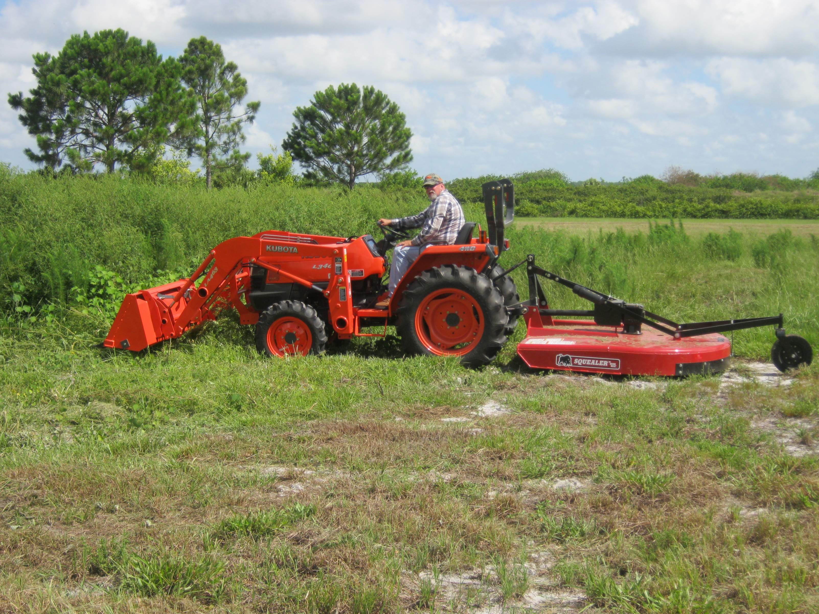

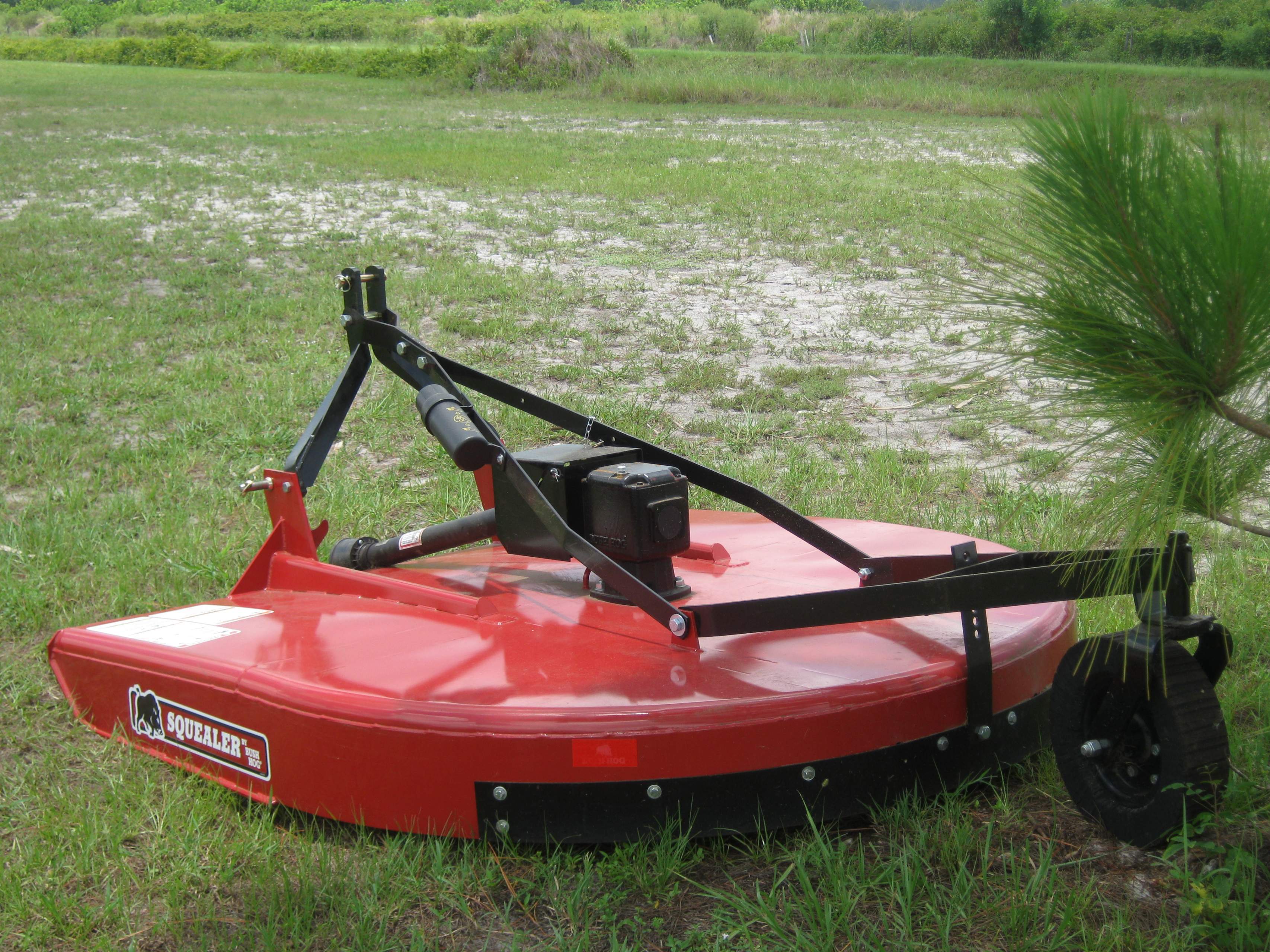

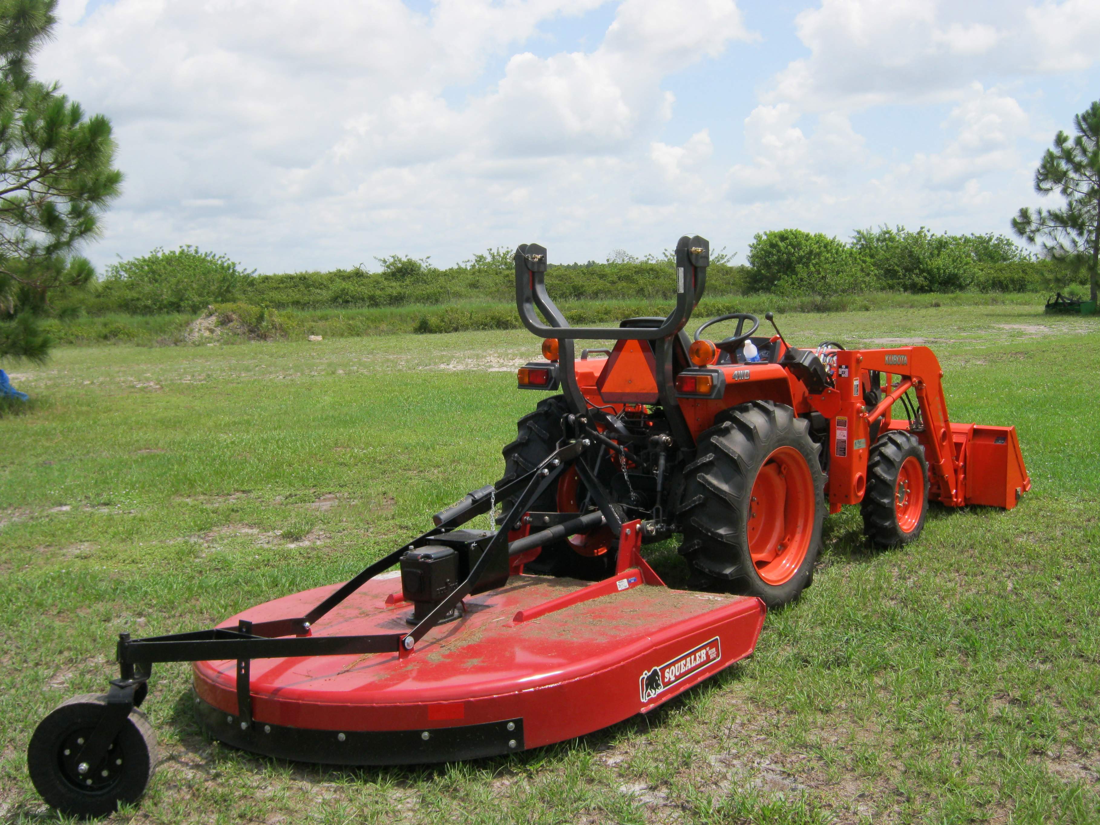

The Bush Hog squealer line is just a cheap entry level mower to compete with the King Kutter and other cheap mowers. Jump to a medium Duty Bush Hog and you will see they are built much better same with Woods, the medium duty is built much heavier and better then the light duty mowers.
Not saying it's super heavy duty,but for what it is the SQ172 comes with a 65 hp rated gear-box and weighs about 30 lb's more than the "pro"series King Krutter.
With all due respect:
You sure you don't have them confused with the bushhog RazorBack series ?
BTW:For what some might refer to as a cheap entry level bushhog IMHO I think(believe)Hawkline /International(red) not IH make a good hog for the money.
Boone
Boone
Nope, I didn't get them confused. The Squealer line has its place but it isn't built heavy enough for the OP's use.
