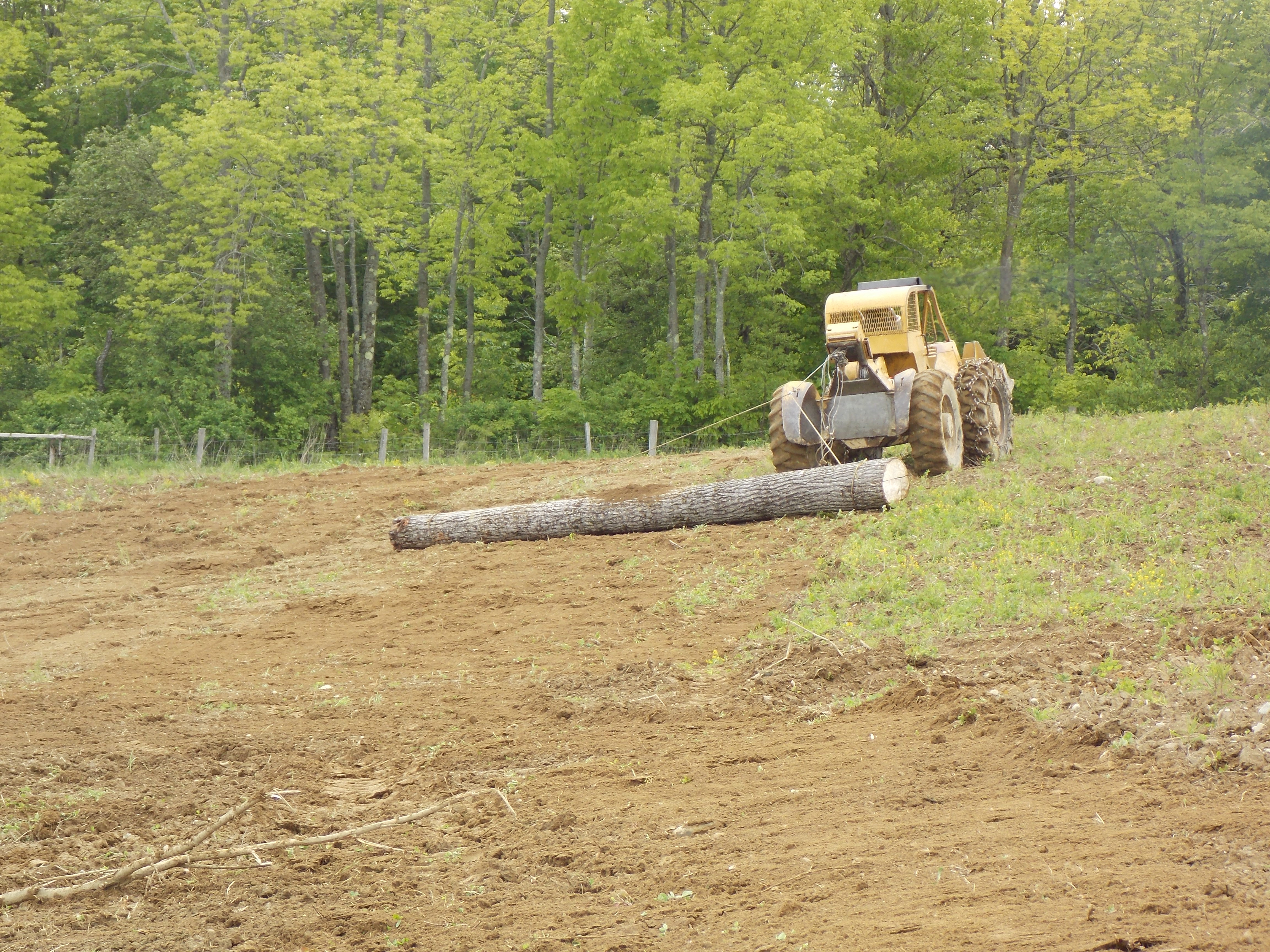

When I level fields, I land plow to make the soil as fluffy as deep as I can go (plow depth), then drag the biggest log I can across the field. The bigger, the more weight it has, and the longer, the flatter the field will be. The log also works well because it it is rounded so it pushes rocks down into the fluffed up soil (that is why you land plow as deep as you can).
I am using a 24 foot, 24 inch on the butt log in this picture, but I had the tractor (skidder) to do it. Just adjust the log size to what you can pull with what you got. A person can typically get a log free as well...free is betterer! (LOL)

There is no need to modify the log...
You grade, say North/South
Then grade NorthEast to Southwest (at an angle to the field)
The grade East/West
Then grade North/South
Rinse and repeat as necessary
It is a lot easier to pull the log at 10 mph a few times across the field then it takes to find steel to make a cutting edge that is not really required. Dragging in multiple directions spreads the soil from high to low spots.

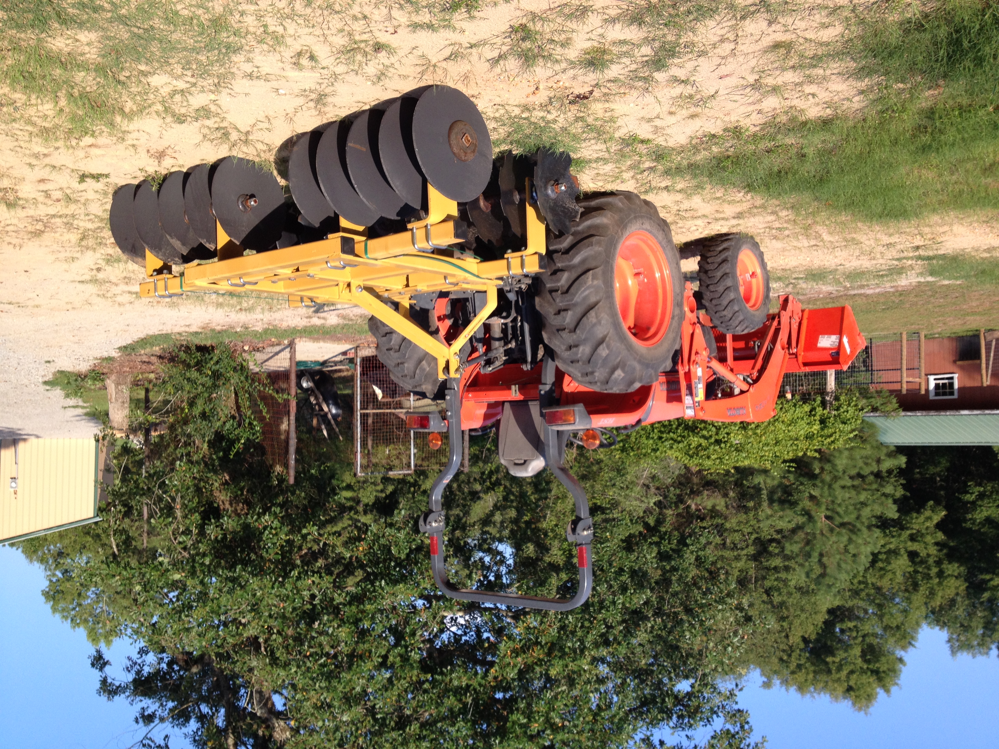

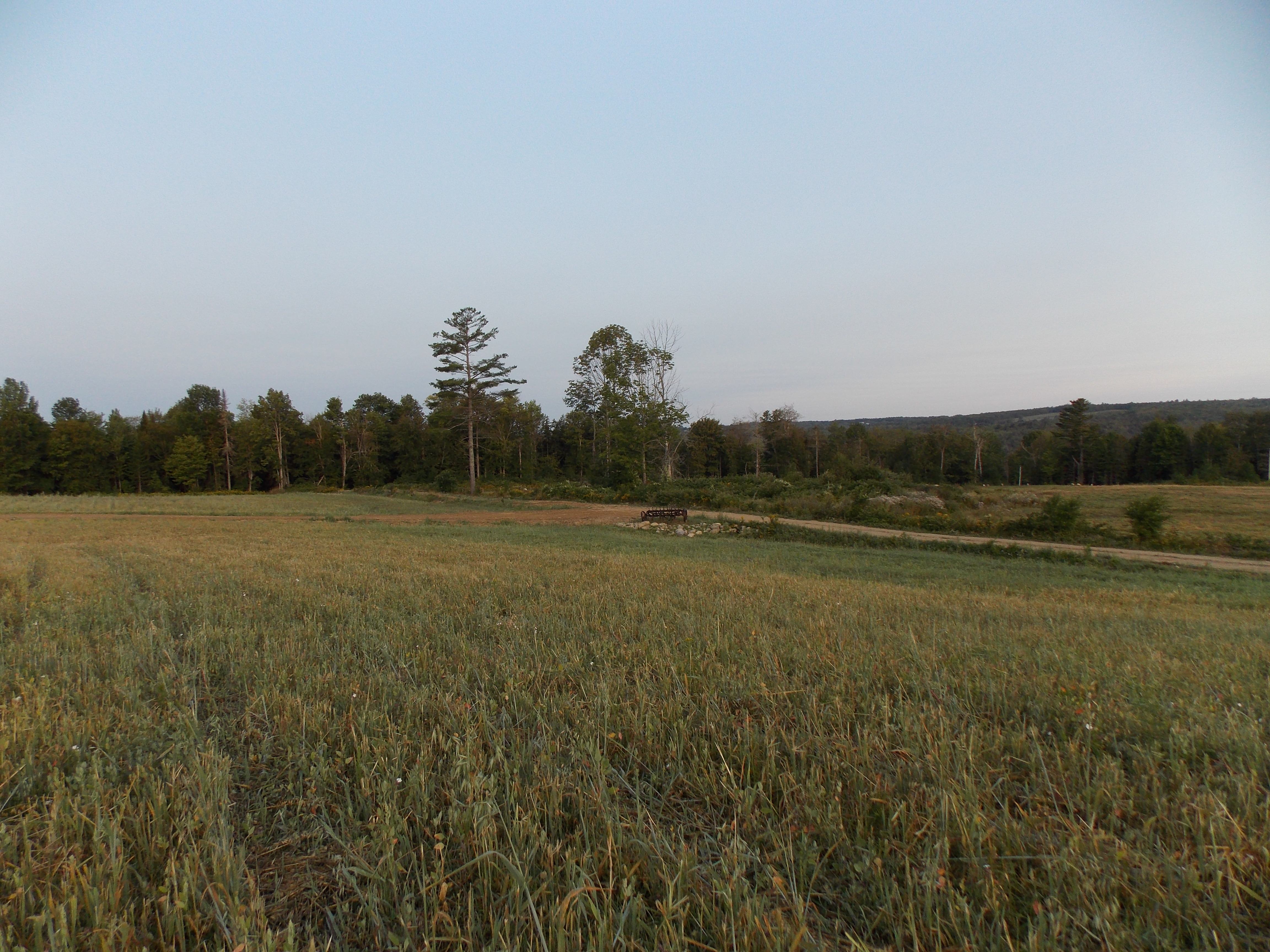

I'm thinking a disc is the perfect way to do what you are wanting to do

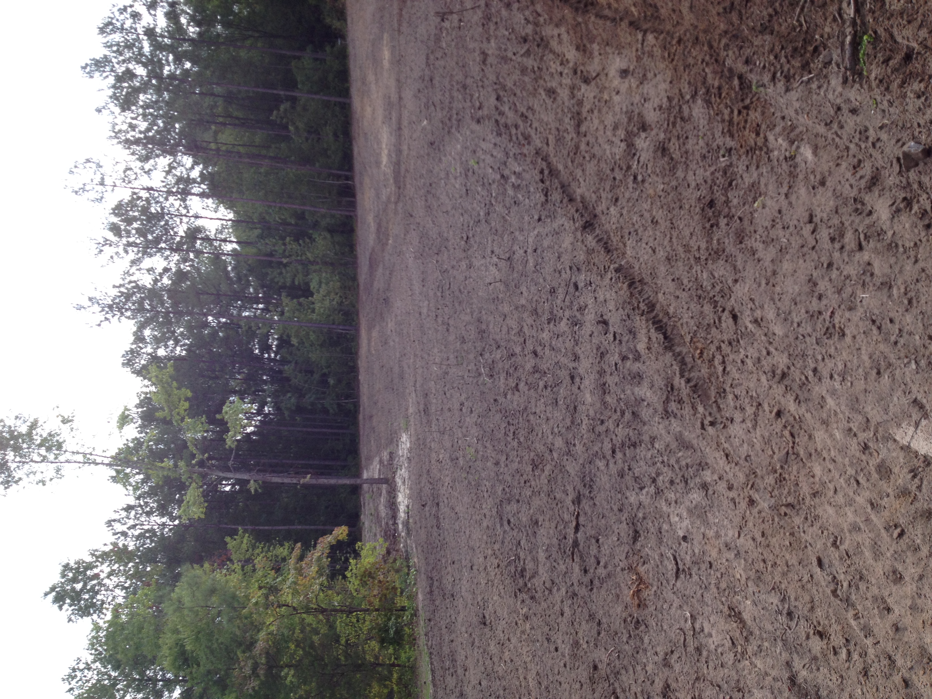

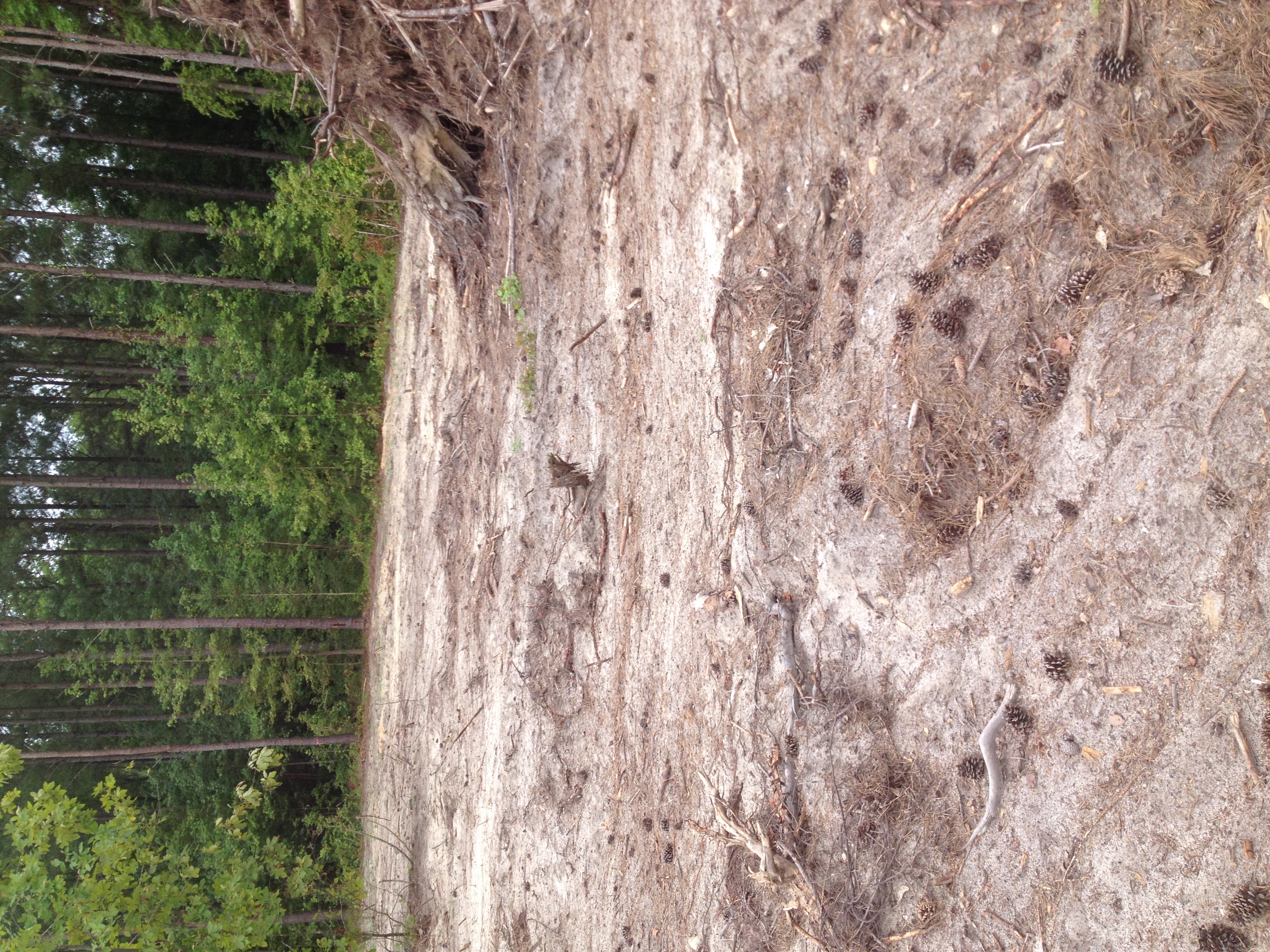

This is a before
And an after of the same field
And a 7' disc I got from TSC for about $1100.00
Sorry bout the picture configuration. (click on them and they should stand up right)
This field was all woods when I started, I had it cleared and then stumped and raked so it was pretty rough to begin with.
Then I took a 9' spike harrow to it to finish it off.

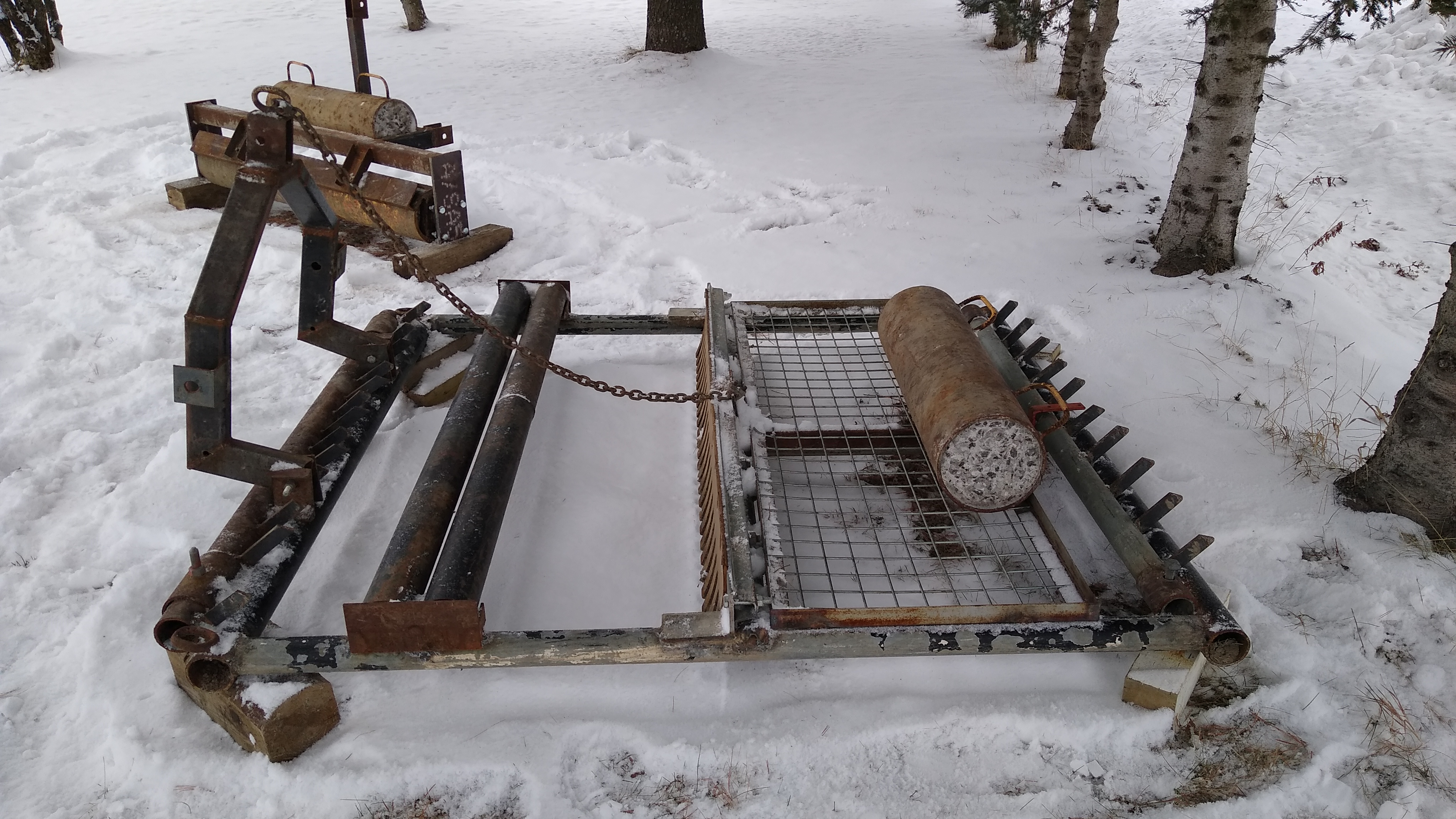

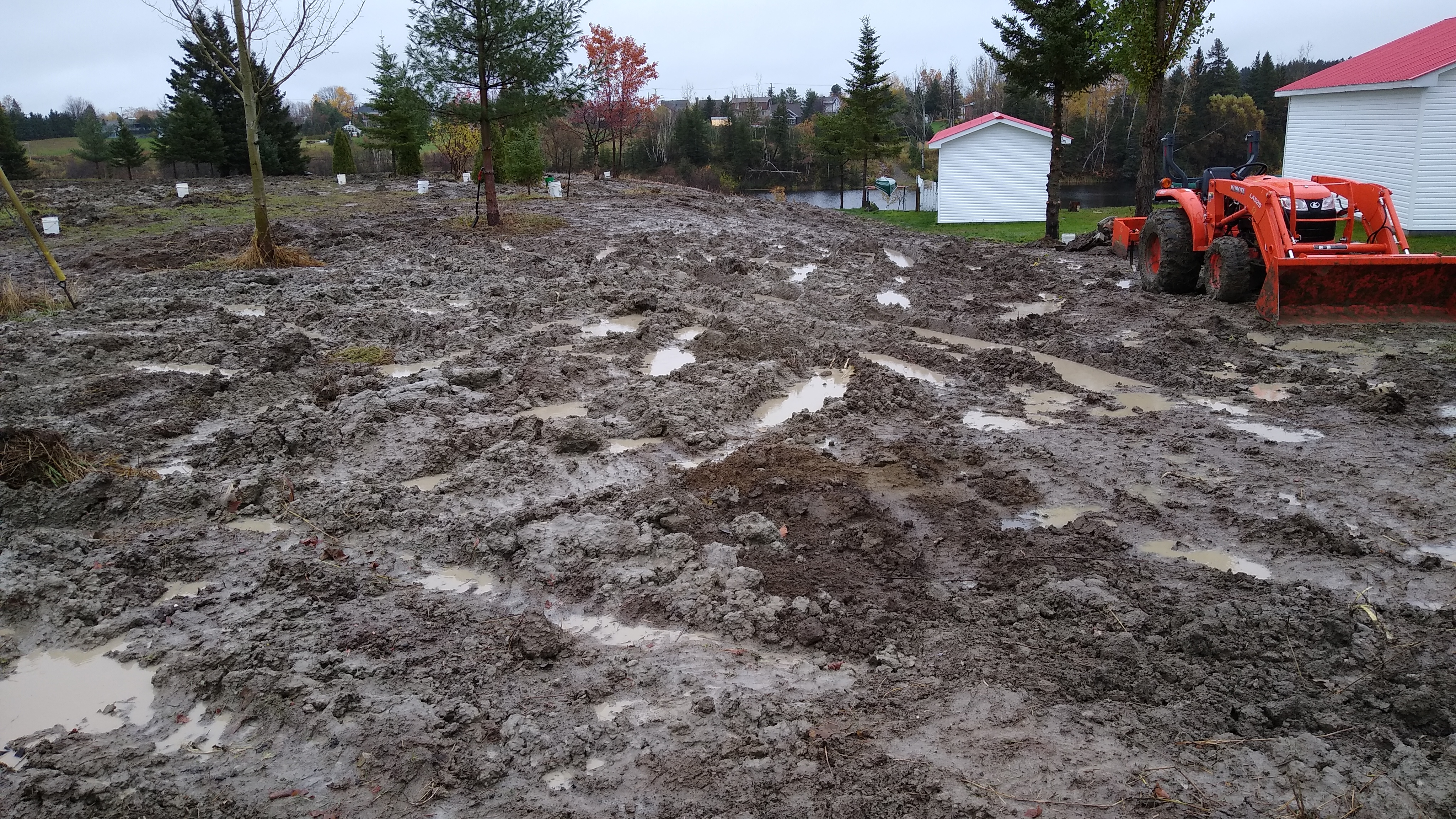

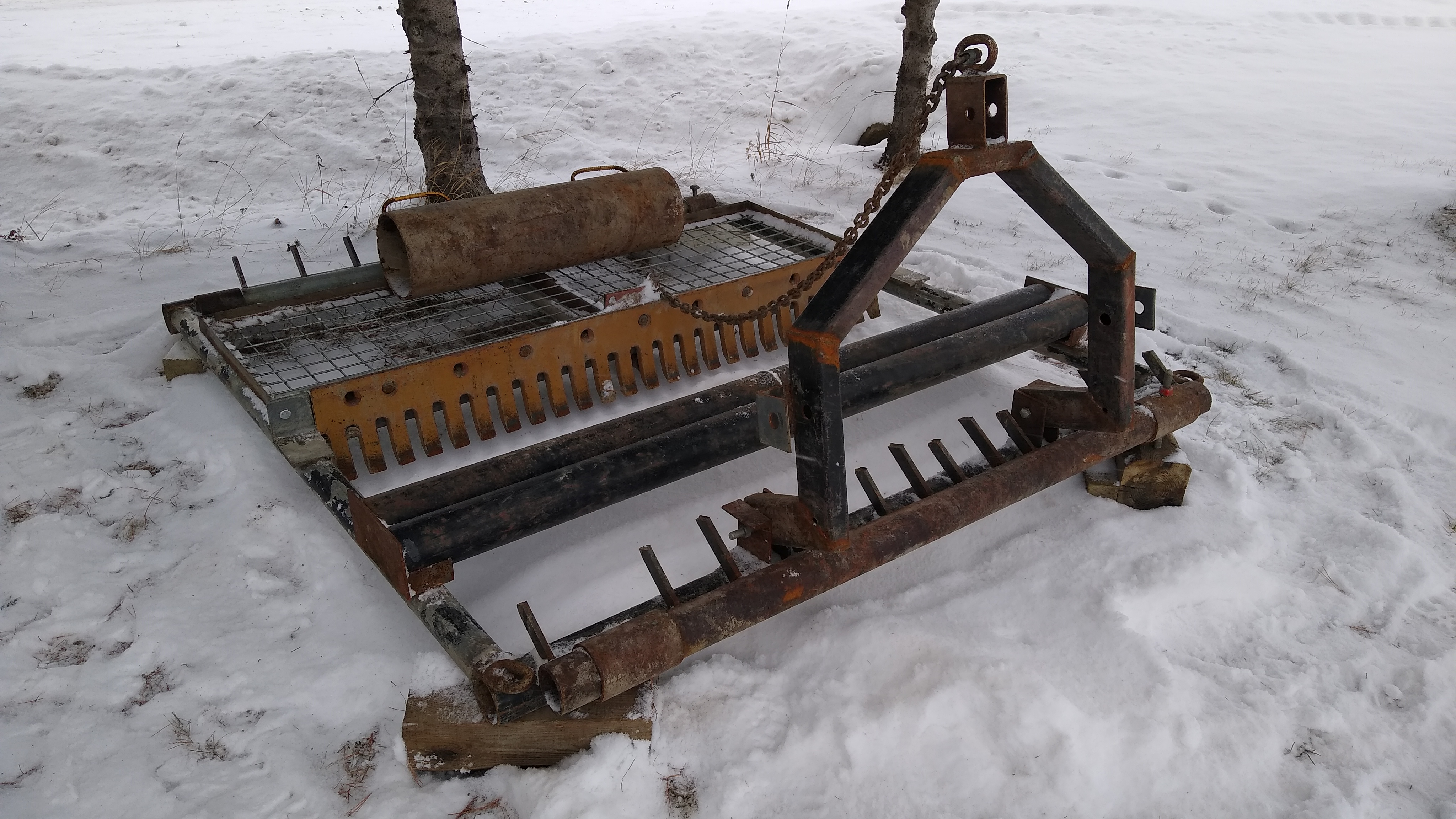

i build a drag grader with spike tooth 1/2'' X 1'' flat bar and leveled my field perfectly , cutting small roots from cherry tree removed, pulling rock to surface and roots also while filling the holes and removing bump. i started with a box scraper but after doing a lot of research over the net for a better solution for my need, I could'nt find anything close to what i builded. The result is amazing and i would like to share with others my experience in order to give some idea to others how to build a drag plane or drag grader. I also added a 200lbs weight in the back and another 200lbs weight in the front that i will try next summer. The blade and spike will be more agressive . dimension are 5' wide by 5 foot long and total weight with extra weight is approximatly 750lbs. the Grader blade serrated cost approx $140 cdn for 60'' 3/4'' X 8'' (73lbs).
this was builded for leveling 2 acres of old unused field for the past 20 years where it become almost a forest. Now i will do a couple of more passes in next coming may June 2021 before seeding grass. Once i will apply my seed i will roll it over with an Homemade roller 750LBS that i made also for my need. This attachment o found many idea over the net. Thank's to other for sharing with us your idea a passion to help us better in improving solution.IMG_20201020_103754413.jpgIMG_20201115_155742871.jpgIMG_20201122_094353553.jpgIMG_20201210_105959803.jpgIMG_20201210_110023563.jpg
see picture of land before and after using the Homemade drag grader
