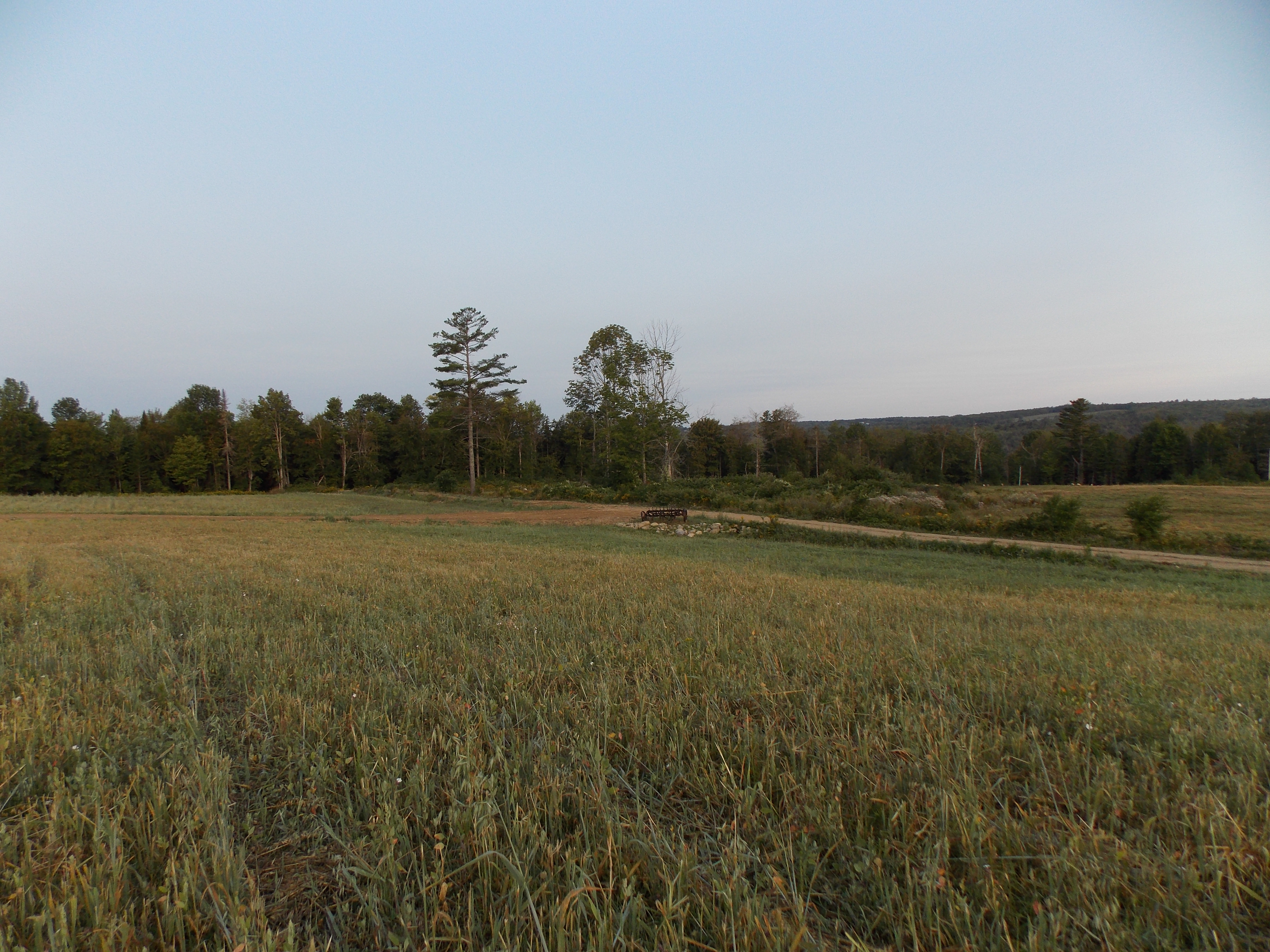

i have about 6 acres of field that has been used for farm produce for many years. If you drive over this field East to West or vise versa it is smooth. If your travel North to South or vice versa it is like a washboard. We now want to make this field back into a nice easy to mow smooth field. What would be the easiest tools to use to make this project go along the fastest. The field is all weeds right now. It needs to be broken up.The edges of the planted areas all need to be lowered and graded to blend into the previous planted area. I already have a box blade, grader blade, rock root bucket and a landscape rake. The edges of the planting areas have really good sod that is going to need to be busted up to taper the edges of the field where it is slightly sunken down. Would it be better to rototill the entire area and then smooth it all out with a grader scraper? I could also have my friend till the entire field with his huge land plow setup and then I could smooth it out using ????? I have been reading about the grader scrapers and think that may be the best tool to flatten the ground back out. Would the grader scraper be the best tool to use to smooth out an area like this? Would rototilling the field be better than running a land plow all over it. I could also use my box blade to rip the entire field. Hopefully somebody has already dealt with this issue and can give me some advice.
I will have to respectfully disagree with suggestions to use tillage implements to level the OP's field. I feel that at least some type of grading implement is needed to get the field back to level. This is based on my interpretation of the description of the problems.
I agree that there is a difference between making it smooth vs. level. Tillage equipment will make it smooth and diminish humps and furrows, (easy to mow), but general contours will remain. If you want to remove a hill or make something absolutely flat and level, then a large grader, land leveler or earth mover would be the tool of choice.

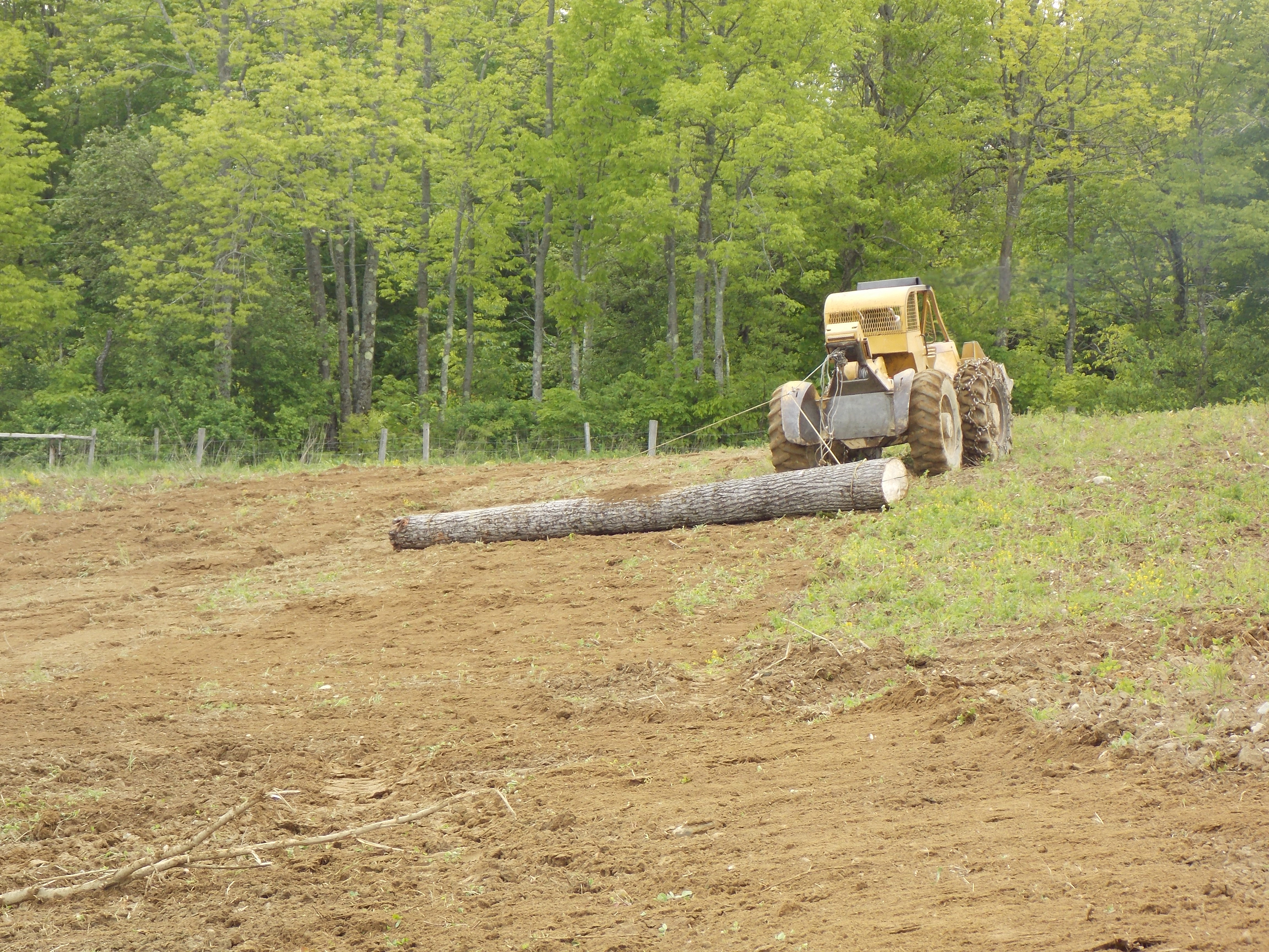

Using a disc harrow would be a HUGE mistake. They have cupped discs to bring soil UP, not down, and that is what you want. You get some leveling with a disc harrow, but you end up picking rocks after every pass to get the job done.
I HATE PICKING ROCKS!
When I level fields, I land plow to make the soil as fluffy as deep as I can go (plow depth), then drag the biggest log I can across the field. The bigger, the more weight it has, and the longer, the flatter the field will be. The log also works well because it it is rounded so it pushes rocks down into the fluffed up soil (that is why you land plow as deep as you can).
I am using a 24 foot, 24 inch on the butt log in this picture, but I had the tractor (skidder) to do it. Just adjust the log size to what you can pull with what you got. A person can typically get a log free as well...free is betterer! (LOL)
