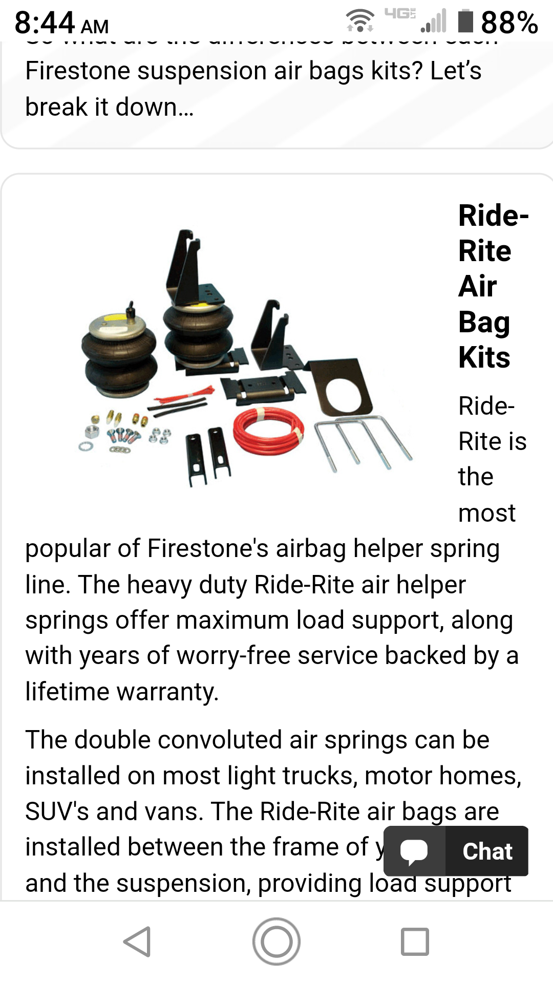

One of the main purposes of air bags is to maintain proper vehicle level. Timbre s do not do this.
   / What is the best way to level truck when towing? #55
Isn't that what op asked about initially?

   / What is the best way to level truck when towing? #59
He surely did. Since then he’s gotten all kind of recommendations that do nothing for truck being level.
Like I said a few times I'll take these and I currently use them, standalone no onboard compressor decent quality, most are bolt in, fairly straightforward install, they work great for taking the squat out of my truck from my experience with them. Ride has also improved unloaded imo.
