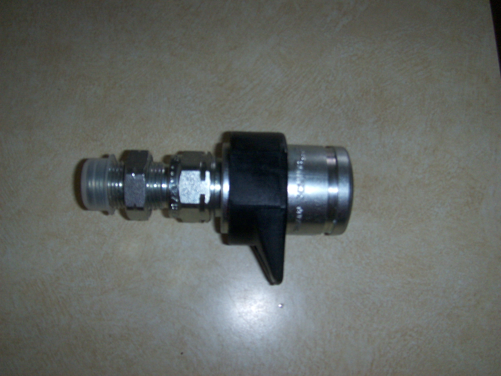

   / what is the best way to mount inline flush face quick disconnects? #15
David, have you actually seen JIC or ORFC QDs? :confused3: I have only seen NPT or ORB myself. ;)
Here's one from JD. It has a built in bulkhead fitting and the end is male ORFS
   / what is the best way to mount inline flush face quick disconnects? #16
Nice. ORFS, ORB, or JIC are all great, esp compared to lousy NPT.
BTW, my no-brand male QD above leaks slowly at the poppet, since new. :-(
