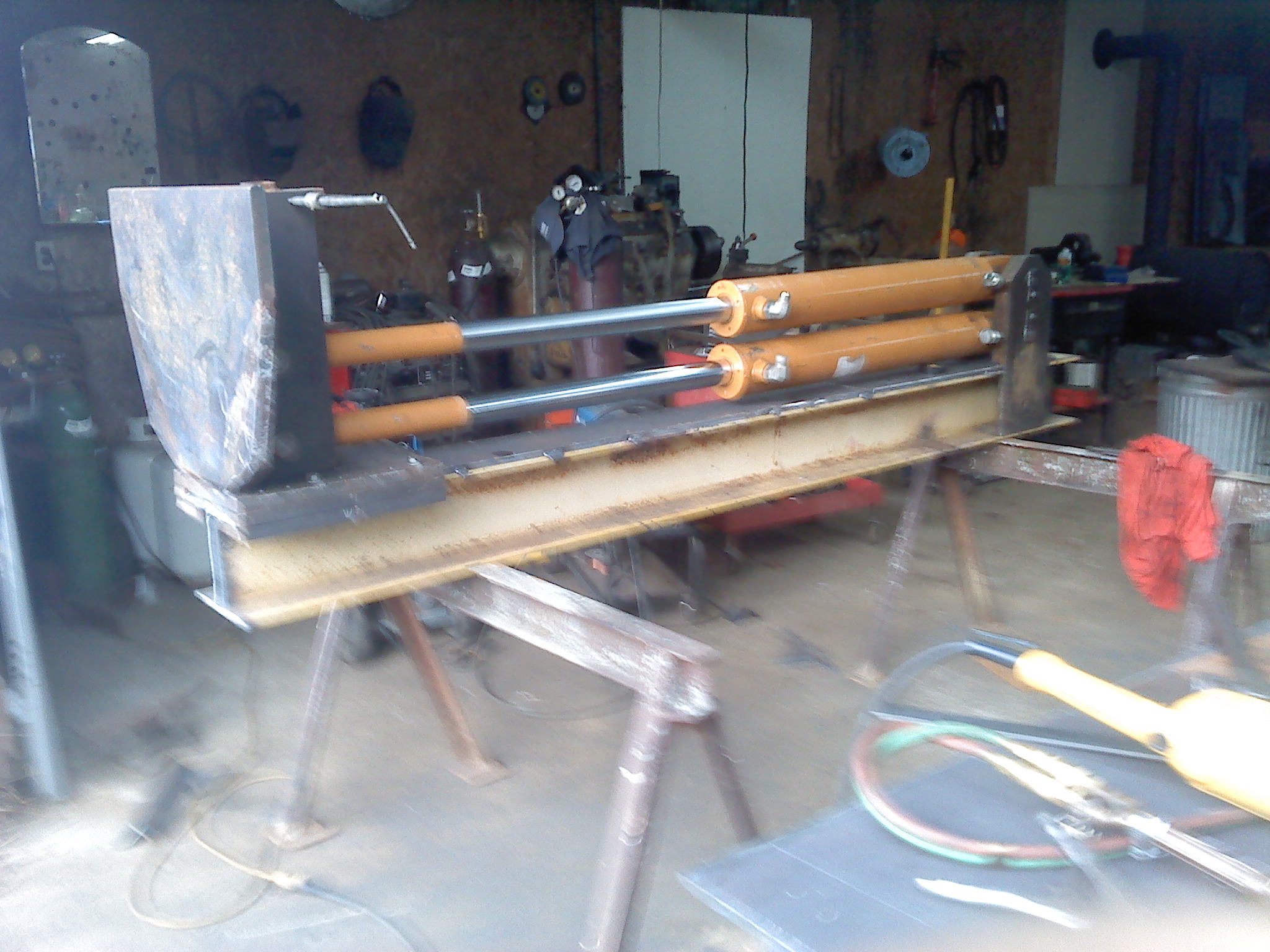

Multi split wedges require lots of force. My curret splitter has a 6way adjustable wedge and a 5in bore cyl. it will pretty much split anything I can put on it, includeing knots and forks. The big problem with a box wedge like the one you posted is wood jamming in the wedge. I fyou are wonting sq splits, I would suggest taking a look at the tempest wood splitters. Tempest EF-3 Wood Splitter - YouTube, they split wood in both directions and you end up with sq splits.

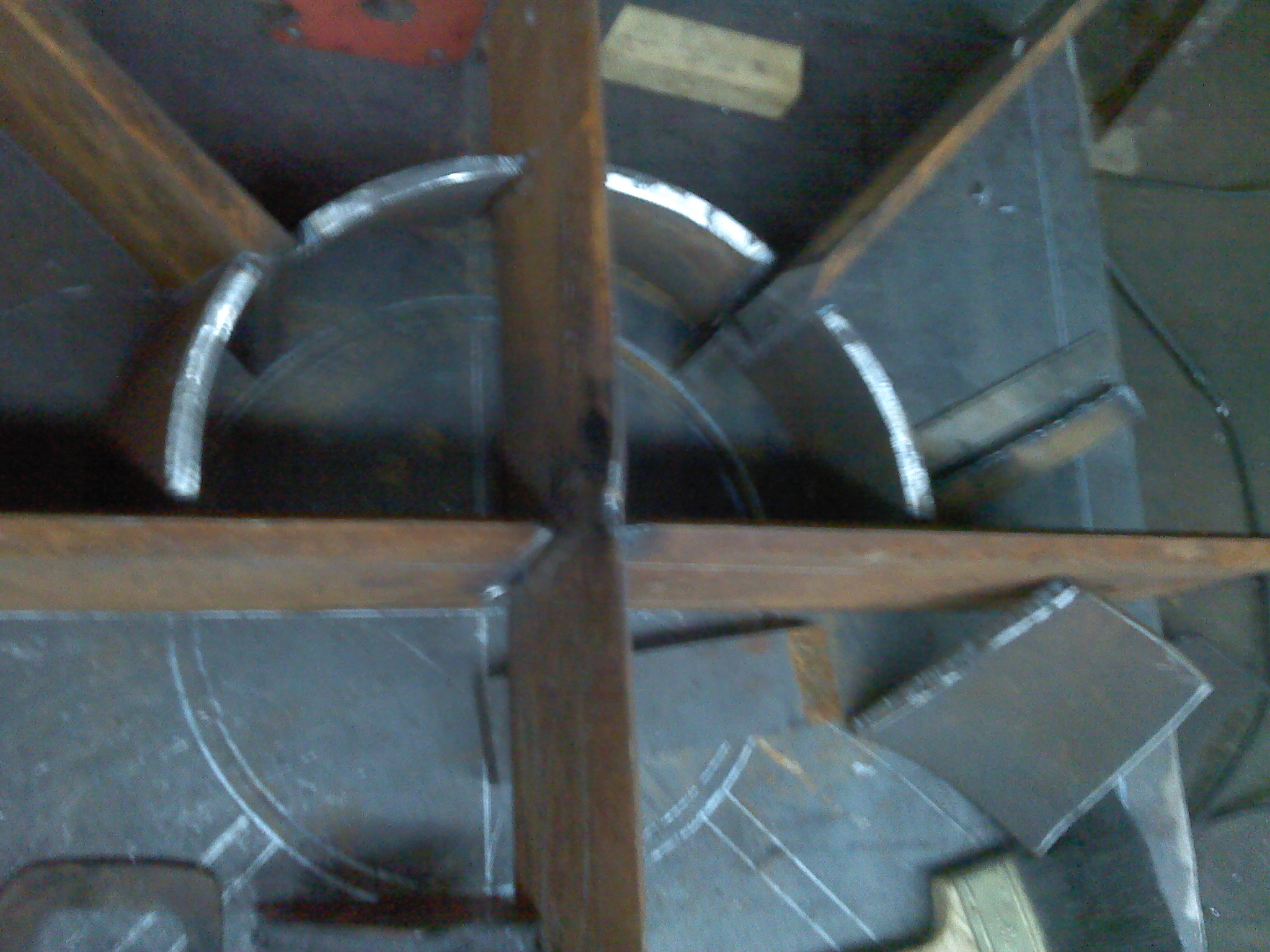

Th processor I started a couple of years go, but havent finished due to health reasons, uses twin 4.5in bore cyl..1210151640.jpg and a 12way circle wedge.1214151754.jpg Capable of 30in dia rounds. The wedge will be height adjustable so I can center on the rounds and hopefully not end up with a bunch of splinters.. wish I had it finished since I have taken several years to round up parts and spent a bunch of money. Looks lake this last surgery will probably put me in retirement so maybe I can get back to the build in a few more months.

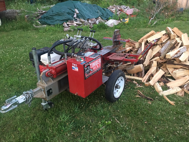

I've got a Timberwolf as well, love it!
