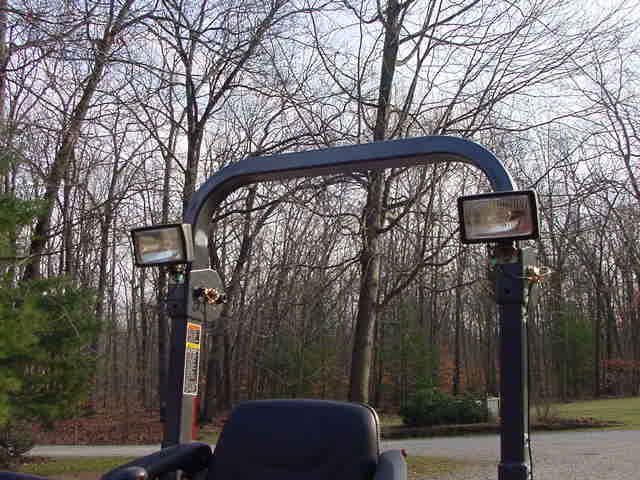

I cut mine off for the exact reasons, of course the ROPs police on here had a hairy fit. It's my tractor and I figured up and shorter was better than folded down and shorter.
