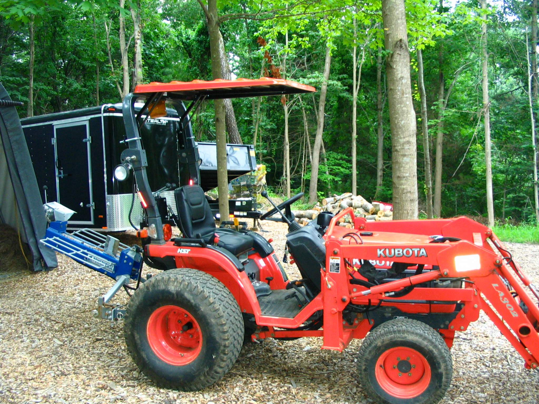

Well after seeing I would not be the only one to modify my ROPS, I took the portaband to it and removed 3" from the upper half, Re drilled and welded the hinges back in place. Just need to get some touch up paint... Primed for now..All with only 3 road sodas....:D
Improves the overall appearence as the ROPS just looked odd at the original height, and more importantly save me from repairing my garage trim and portable garage roll up door...:D

Pretty easy job ain't it??? ;)Now it is the height of the fixed ROPS.:cool:
