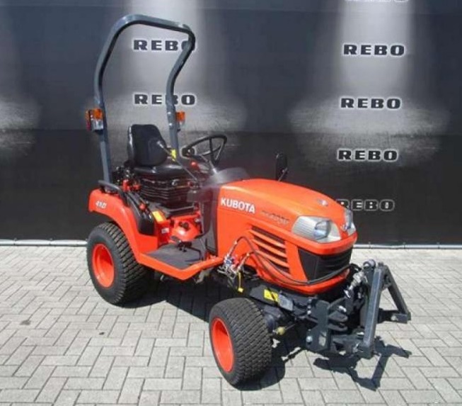

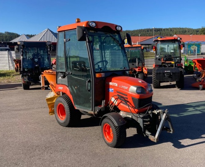

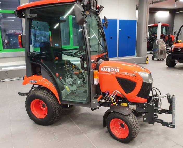

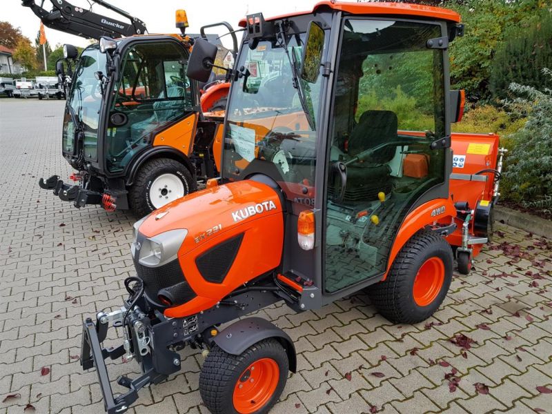

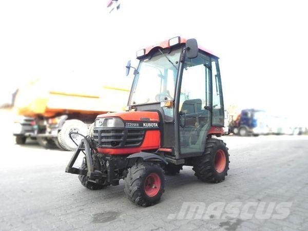

Here are some Kubota BX tractors with front hitch.
kubota-bx2200d.jpg bxfront403486.jpg BX-front92376.jpg bxfront-494764.jpg bx-397.jpg

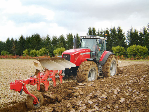

3pt at the front can do work
   / What is the smallest machine with a front category-1 3-point hitch and PTO #16
Yes, that's the point. That photo is of a big tractor, probably high hp & full time 4wd, with big driving tires & likely has extra weight in the front.
You were origninally asking about front 3pts on small tractors. A small tractor is better at pulling than pushing.
