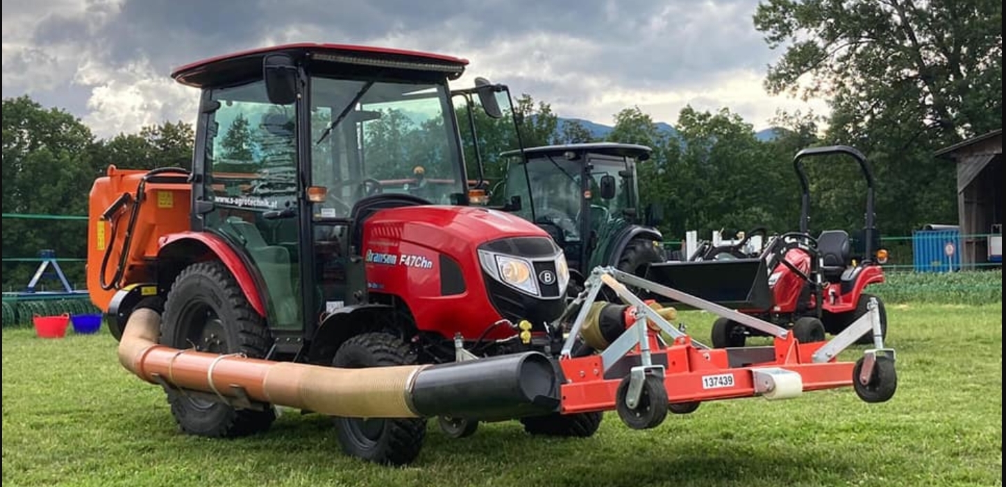

I wouldn't want to deal with the dust from a rototiller, front mowers and some other attachments . Not everyone wants the expense or inconvenience of a cab. There are already front skid steer ground attachments for some items.
A cab Kubota with front flail mower would be nice only if you have very large areas.
Looking at this photo who would buy such a beast?
   / What is the smallest machine with a front category-1 3-point hitch and PTO #28
Usually municipalities use those types of equipment. Very common in countries like Netherlands, Germany and a few more, where they invest a lot in keeping everything nice and neat.
