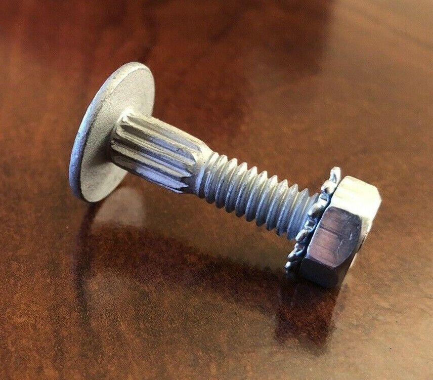

Because a carriage bolt puts me in the same predicament - having to make a square hole. If I really had to, I suppose I could move my press out in to the middle of the shop, rig up a hoist to get it in, etc...but if I can make do with a regular hex bolt, life would be a lot easier.
   / What kind of box blade did I just buy? #32
If you drill a round hole of a certain size you can easily pull a carriage bolt into it with the nut and have something 'semi pressed' although not as strong as a splined design or a real square hole. But ive found most of the time when using impacts that even if the other side is not held all that tight, it usually wont turn as you're tightening because it's being pulled down onto the face of the hole so tightly. So even a 'semi pressed' carriage bolt is probably fine for many uses. You can also tack weld the head to the outside too, in which case you'd just be using your round hole as a 'locator' and not care about the barely-biting corners on the square.
