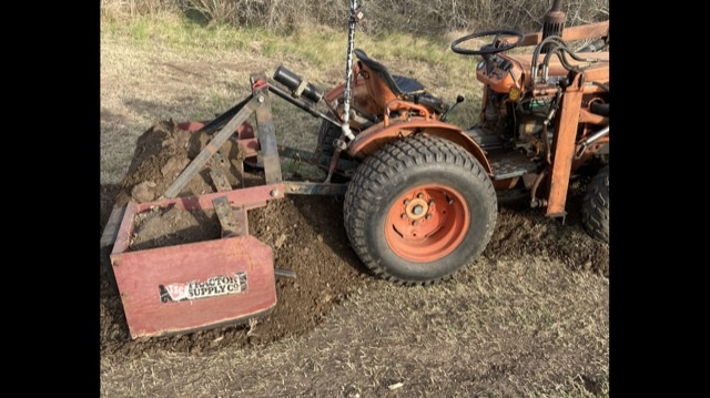

Its slow going and very dependent on technique.. for example in the below pic the box is full and pushing a column of dirt that extends almost between the rear wheels, BUT the box is tilted all the way to the rear via the power top link, and the 3pt is not in float, it’s lifting some of the weight, just not enough to lift the box and let the dort fall out. You can see how much is spilling around the sides, some but not much. I can also put a lod in the bucket to increase front wheel traction if needed.. I cant pull a full box at all in 2wd..
Anyway, i just like to share my techniques and optimism but most times a bigger machine would still make the work way faster and easier, cant argue that! 😂
