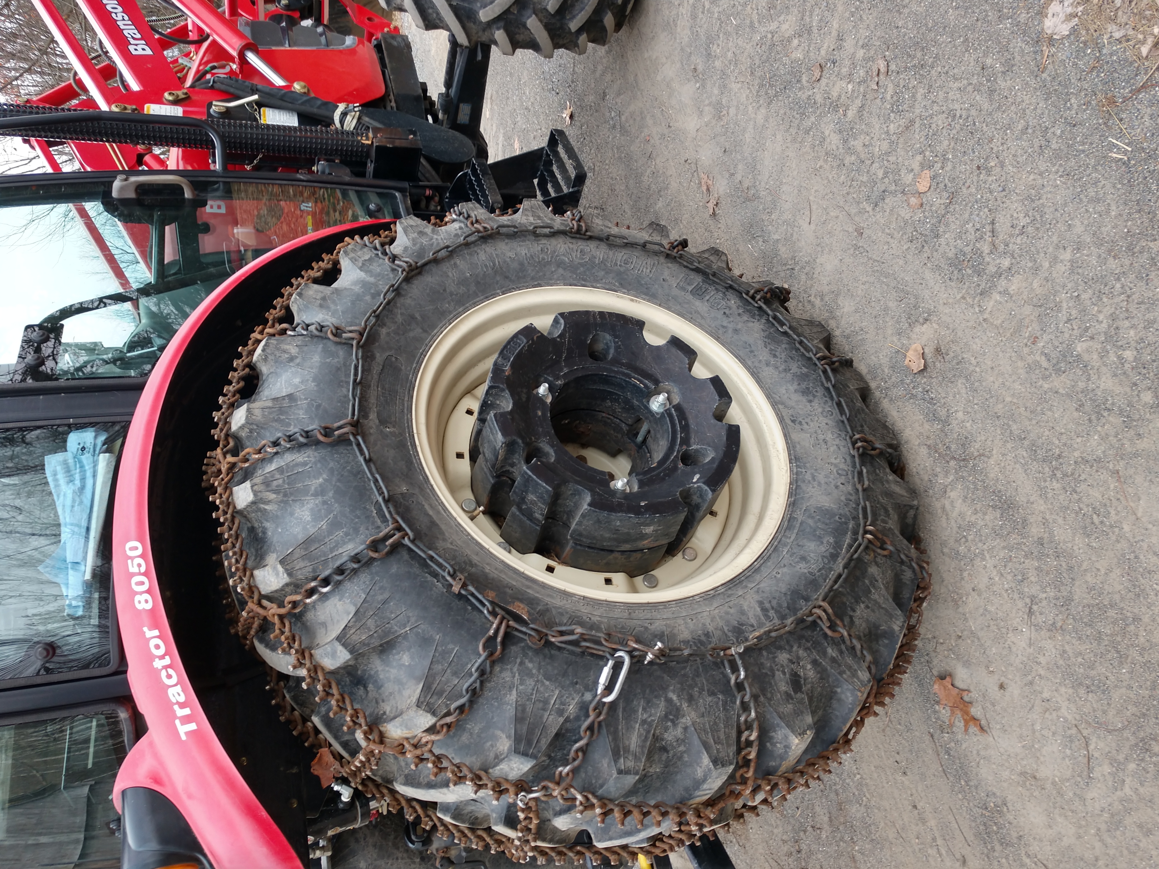

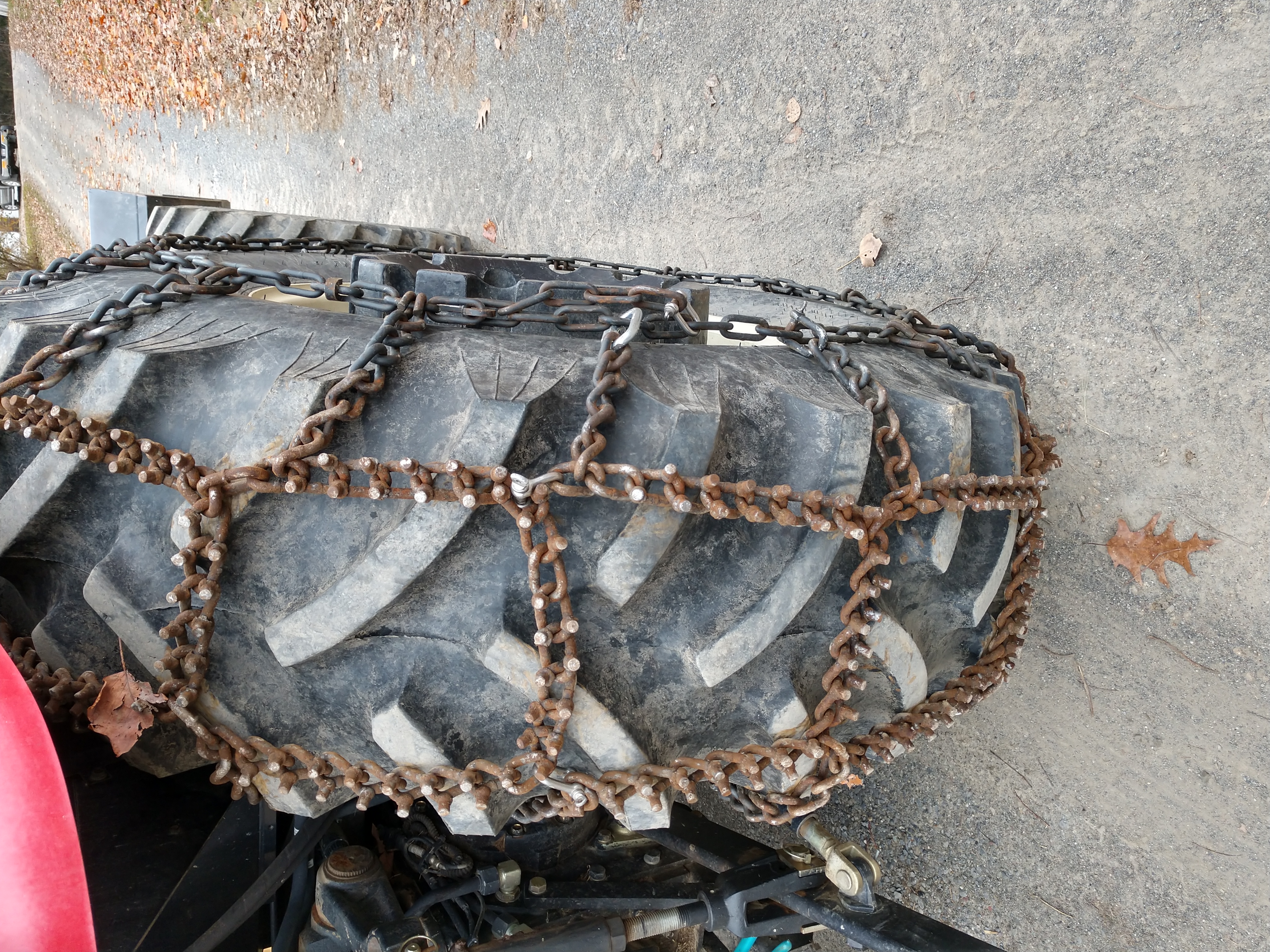

   / What kind of shackles to use to hold chains on? #3
Where do you use them on the chain? Picture?
   / What kind of shackles to use to hold chains on? #4
I use the D ring shackles usually SS, threaded.
If you can enlarge the pictures the shackes show up good.
The first pic has 3 visible about 9 o'clock on the tire,
the second has 4 about center,
the last pic has one about 3 o'clock on the tire.

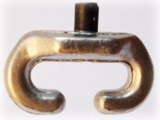

A plug coupling. Hmm. Never used one. Are they easy enough to drive the pin out? They'd have to be removed once a year.
   / What kind of shackles to use to hold chains on? #8
It's from those that make Trygg chains, I do believe those chains are sold in the US
TRYGG Kjetting
Does anyone know if the pin in these can be easily hammered out with a punch, just as it went in?
