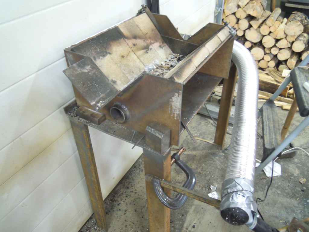

I'm making a forge based on the Whitlock design and I'm using this pipe for the internal air flow selector. I used the unfinished forge to heat up the pipe to burn off any chemicals or coatings on the pipe but was amazed that the coating burnt but still did not flake off even at around 1600* F. I couldn't even scrape it off after that much heat. I will end up having to use the grinder to get it off.

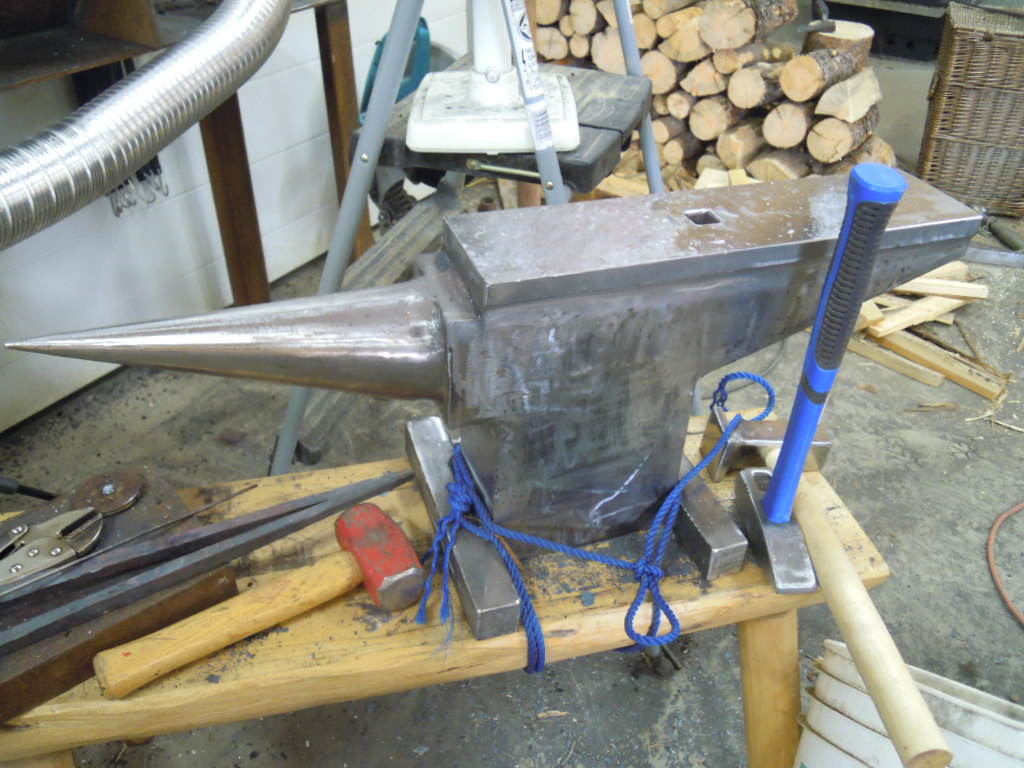

I've used the forge a few times already without the air flow selector but I think it will be better with one. I'm in the process of making my first set of tongs using my newly completed anvil. Man anvil making is time consuming. If I remember I'll get a pic of the anvil and forge tomorrow.

Here are pics of the anvil and forge. The anvil is made up of pieces of 1 1/2" mild steel plate welded together, with a 3/4" piece of AR500 for the top plate / face.
   / What Kind of Steel Pipe Do I Have? #14
Since I was wrong in the first one I won't venture to guess but I sure do like your anvil! Nice job.

Dragoneggs, thanks for the compliment on the anvil. When I started making it I thought it wouldn't take long. Man was I wrong. But I'm happy with the way it turned out. It's pretty heavy at 155 Lbs I don't want to move it around any more than needed. Going to have to make permanent base for it. The wooden bench it's sitting on now moves around when I'm hammering on it.
   / What Kind of Steel Pipe Do I Have? #19
Hilbilly your anvil looks awesome! Nice work.
