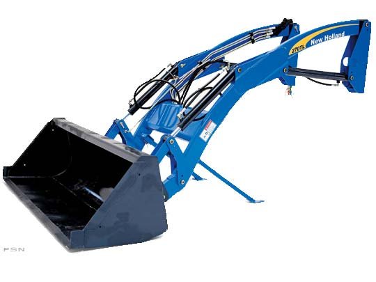

I found this online of a 3910 with a 270tl loader.
It can certainly be done, I have seen quite a few of the CASE IH L360 being adapted to older farm tractors. Depending on the price it may be worth trying it.
Vanoostrums in NS was selling a bunch of NOS CIH loaders for that did not fit any current tractor, new loader for $2k something. I've seen a few mounted on well used older tractors.

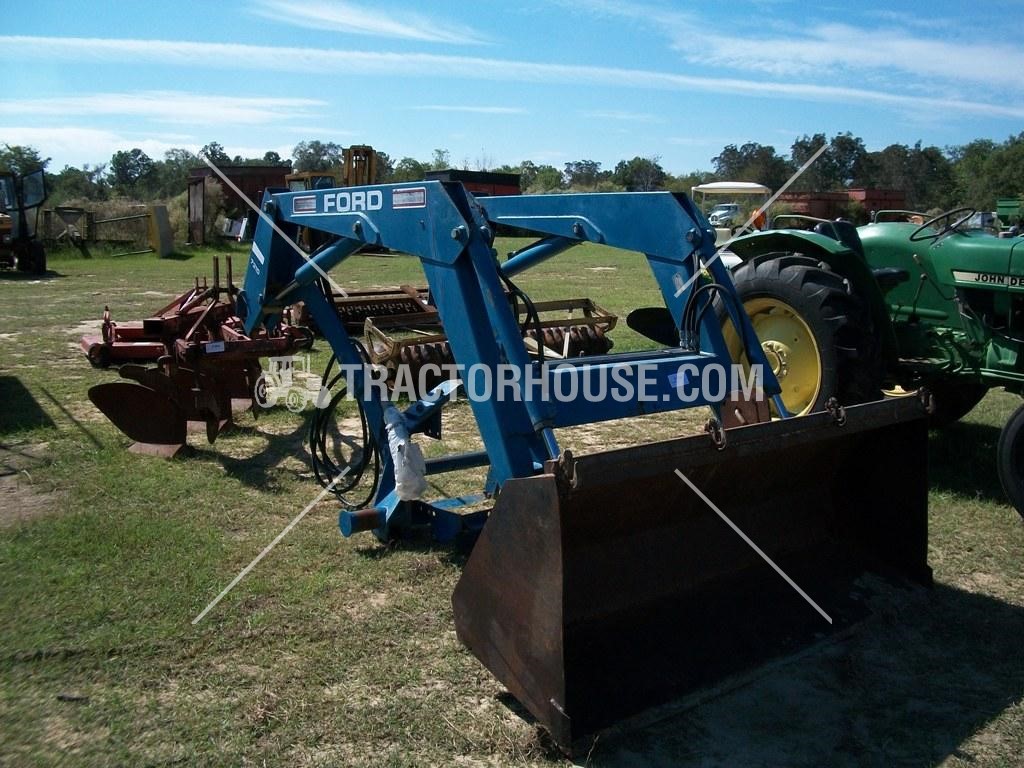

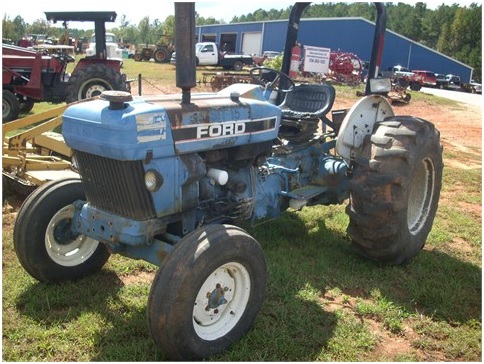

I don't mind buying it but the problem is how do I know that it will fit. And I have bought from Burtons before.
I can get a good deal on Ford 270TL loader but I am not sure that will fit or that a 7310 would fit for that matter.

Why do you think a 7310 would fit on 1993 Ford 3930 Tractor. View attachment 396419
View attachment 396420View attachment 396421
Here are two 3930's with 7310 loaders, one 2wd one FWA.
1994 New Holland 3930 Tractors | JOE WELCH EQUIPMENT CALEDONIA, MN #39301465
1997 New Holland 3930 Tractors | Farm Sales & Service EAGLEVILLE, TN
The REAL issue is not if a 7310 will fit a 3930, but if the MOUNTS to fit a 7310 TO a 3930 are available. The 7310 fit a lot of Ford/NH tractors, I ran a TL100 that had a 7310 loader, mounts were not the same as the 7310 loader on a 5030 on the same farm.

Well, this is a Ford 7310 loader. And you are sure this will fit a 1993 Ford 45 HP Diesel Tractor?
I appreciate your due diligence on this matter.
   / What Loader will fit a 1993 Ford 3930 45 HP Diesel Tractor #15

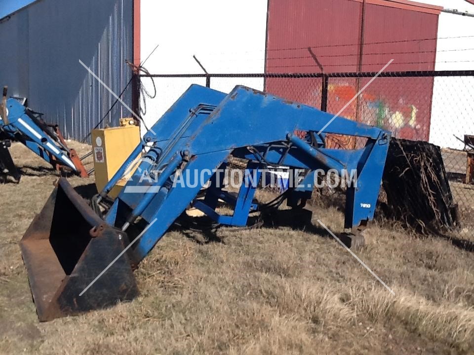

You will have to ask the seller what mounts come with it and what model of tractor it came off. Appears from the photo that a set of mounts come with it, but the question is, for what tractor. You will need to measure and look at it in person to be sure. As I mentioned, the 7310 could be had with different mounting kits for different tractors.

First thing I see is that you need an adapter bracket for the tractor to accept the loader. The bracket will bolt to your frame in some fashion to support the loader. Without that the thing in the picture is useless to you. I bought one years ago from Koyker Mfg. (Koyker Manufacturing) for my JD. It was delivered to the house and was very reasonably priced containing everything needed to install. Plus it was made for that tractor, not some kind of gee I hope this will work. With you not having an adaptor, I think your best bet would be to look elsewhere. As I recall I did have to go to TSC and get a dual spool control and hoses for it. Then you would have to see on your tractor where to mount the control and possibly fabricate a mounting bracket. I don't see a set of controls with the one in your picture either.
