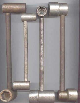

Got a few more pieces. These socket head wrenches and also some T-handle nutdrivers too!
DFB
