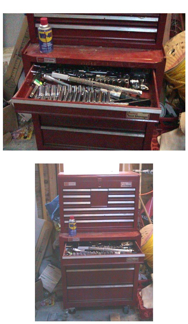

I bought a bottom of the line, on sale, Sears roll around chest in about 1983.
It has handled the weight from as many tools as I have put in it. The problem is that it is now far too small. While the chest is full I have other tools stored around the garage.
I can't comment on the current quality of the Sears chests, but 20 years ago the low end chests were a great value.
Ed
