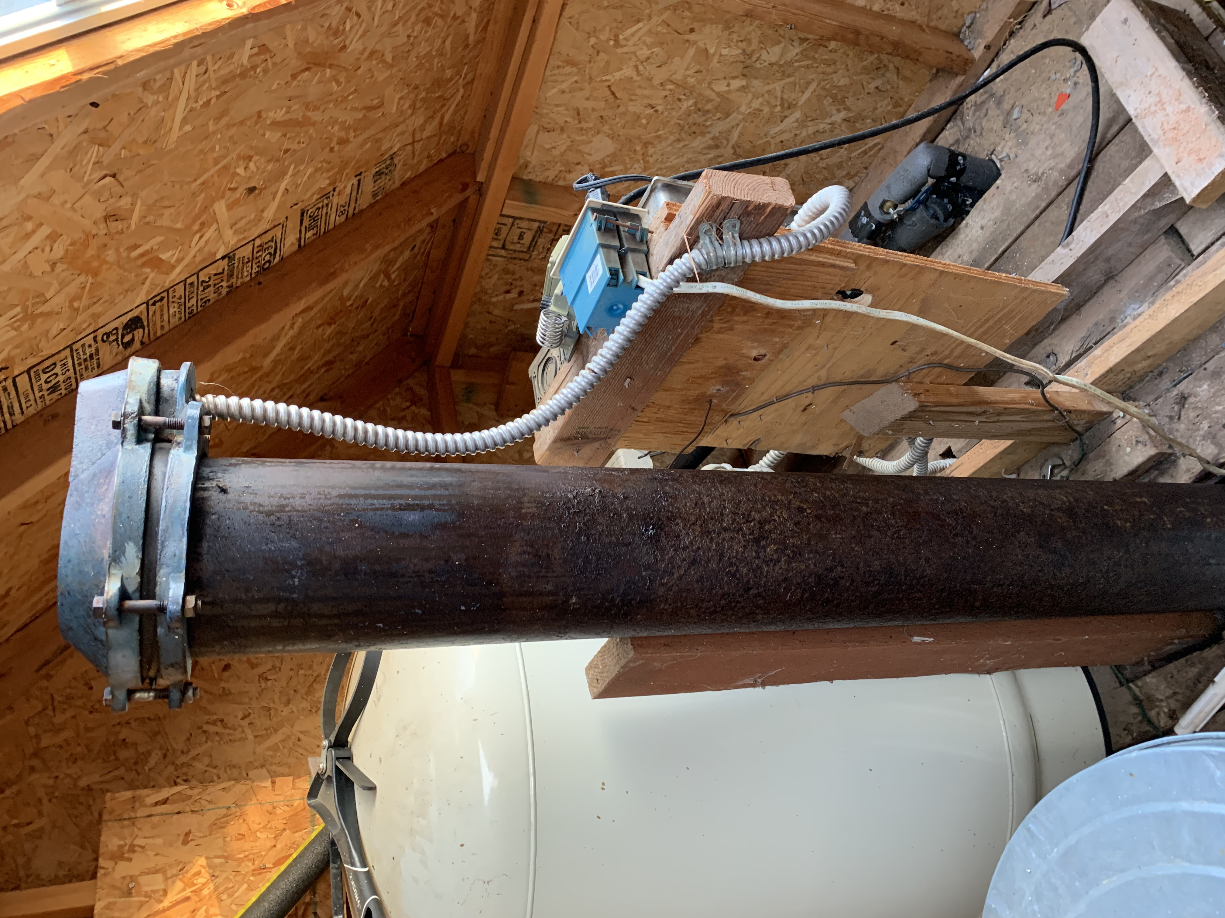

Time to rebuild the pump house. The current one had a rotting greenhouse attached to it and I tore that out and enclosed the well components for winter. The goal is to rebuild it either as one or two buildings so that we can can have a nice clean room with a freezer and prep area on one side of things. The well is 25 years old with the pump in the casing and no issues. I've talked to 2 people this summer in other parts of the county that had to have their well lined. No clue if these things will ever be needed on ours, but I want to build a structure that whatever maintenance can be done won't disturb the freezer room if possible.
I remember a thread where people put a concrete floor in the pump house. Can that bite a guy in the butt if work needs to be done? Does a big truck ever have to get to my well head IE if they ever have to put a liner in? We were going to call the folks that did the well inspection when we bought the place, but they are no longer. Thanks for your thoughts.

Very likely someday you will need a big truck to back up to the well and do some work. Working through a trap door in the roof of a well house is a pain. Even worse when the well is in the middle or far side of the slab. I prefer the well be outside of the main well house. I build a little dig leg off the side of the well house to cover the well. If the hole between the well house and dog leg is a foot or so large, the heat from the well house will still keep the well head from freezing. It is much easier for the hoist truck to work on a well that is not under a roof.

This is how pretty much every well around here is done. I would not want concrete around my well head. If the clamps connecting line to the pitiless adaptor fail it would be a mess

As you read the replies, you should note the location of people making them because the weather will affect the answer. I'm farther south than anyone so far and I do not have a pitless adapter. It does freeze here from time to time, about once every other year. I do have concrete all the way around the well head. The pipe comes up out of the well about 6", makes a 90* turn to run horizontal to the pressure tank.
When my well was put in, the driller said to be sure he can get his truck to the well head for repairs if need be. Otherwise, it will be much more expensive.

I made my pump house with a removable roof and the ability to lean the whole structure on to one side, exposing the well head. People always see the eye bolt on top of the roof apex and say something about teletubbies. :) Turns out this was not really needed unless I had to redrill the well. Knock on wood, hasn't needed that. Had to replace the pump a few years ago, 190 feet, and used Poly tube which I could feed through the door way. Did this entirely by myself with very little difficulty. Would have been a breeze with two people. :)

Well head at least two feet above surrounding ground. Ground sloped away from well head in all directions. Good NSF sanitary seal on the top of the well head. Pitless adapter coming out of well casing - 6 feet below ground level. Supply line and power line running to the basement - buried at six foot depth. Pressure tank and all necessary controls located in the basement.
Then build whatever kind of building you want but keep it at least 25 feet away from the well head.

Good points about not HAVING to keep everything together. I dunno in my situation what would be improved my relocating everything. It will all get redone for sure when the time comes. I don't need much freeze protection, but it is required. It is encouraging to know that if a well can be relined or a new pump that the roof may not need to come off. Though in thinking about it, it will get a metal roof anyways. I could basically build one long building, wall off the well from the rest. Maybe sister the 2 dividing joists and should the roof and one wall have to come off the well side, it could. Though the walls will be Hardie plank , so it best be short one. It has a basic 10" sand filter. I may need to improve upon that. We love our water, but apparently it makes the toilets funky... Thanks for the CSV info. I found it quite interesting.
