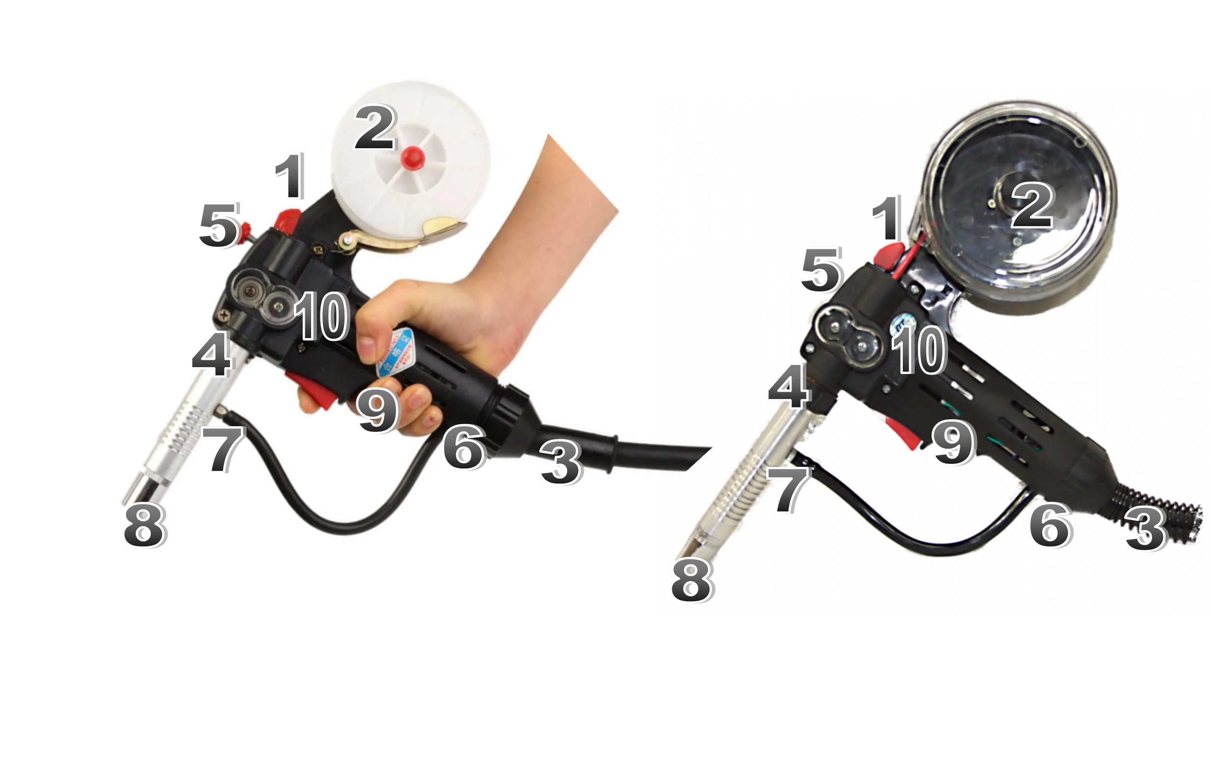

Now to the question of the spool gun etc. that has been stirred up. I've taken the liberty of pulling comparative pictures from both our site and from this "bang good?" site.
I've found 10 (actually more, but the page was getting too cluttered) sample differences. I've tried to make a fair comparison here. Bang Good on left. Everlast one right.
1) Start by looking at the button and its shape. The smooth, longer ergonomic shape of the release button makes things just a little nicer on the Everlast.
2) The aforementioned spool holder versus the Rewind spool of the Bang good. Also note the curious lack of the jump liner on the bang good. You can see the PTFE jump liner on the Everlast. This helps feeding. Equal?
3) Strain relief. Look at the Heavy duty spring strain relief on the Everlast compared to a light rubber outer boot on the bang good. I can tell you from experience that these rubber boots split with age.
4) Gun barrel. The gun barrel on the Everlast screws on and off. The Bang good does not. And it is shorter than the Everlast. The Everlast can support a swan neck. Bang Good? Who knows?
5) The thumb screw on the bang good presumably holds the cover down. The Everlast clips down and is held in place by the clipping mechanism.
6) The handle capture nut on the Everlast seats and meets the handle. The bang good has a measureable gap and who knows why?
7) The gas line and nozzle. The Everlast features a larger, heavier gas nipple, which means it allows more air flow due to a larger internal diameter and offers better sealing with the more pronounced ridges. The gas lines are different too. The Everlast IIRC is a PVC type. The bang good looks like vacuum line used on automobiles.
8) The gas nozzles are visibly different, the Everlast with a taper, the bang good is straight. Who knows if they are interchangeable or the same quality?
9) The trigger "bump" gard. The Everlast extends much further out to help prevent accidental triggering of the spool and gun. Anyone like to get accidentally flashed when your spool gun slips and catches on the edge of the table on the trigger?
10) The drive rolls. Look at how the Everlast drive rolls are held neatly aligned and captured. Bang Good? Nah...we don't need that.
And the final remark about it is that this is listed as a 3 meter gun. Well, that is 10 ft, or roughly in that neighbor hood. Our guns are actually 25 ft. Gun cable costs money. Wonder why that guy was trying to add cable to his online purchase? This is why he was trying to get "parts" and support to extend his gun to "25 ft." You'll also find that the gun cable is not the quality of the Everlast. There is a big difference up close.
Now, I can go on and talk the drive motor quality difference etc but I won't. But I can tell you the process we go through when we are selecting components and accessories for our units. You can see something and assume it is from the same place or similar. But it isn't.
