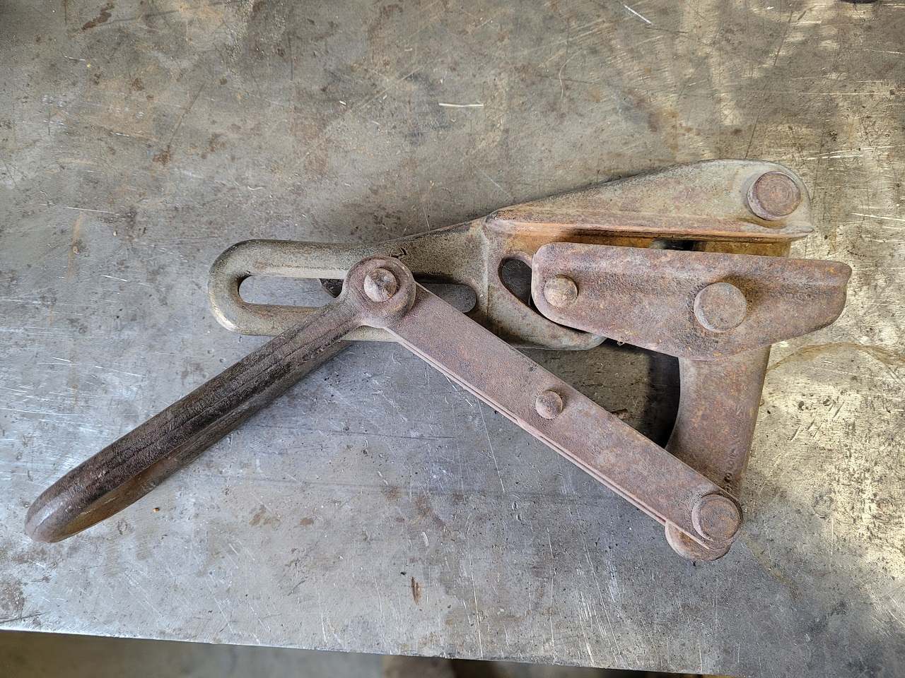

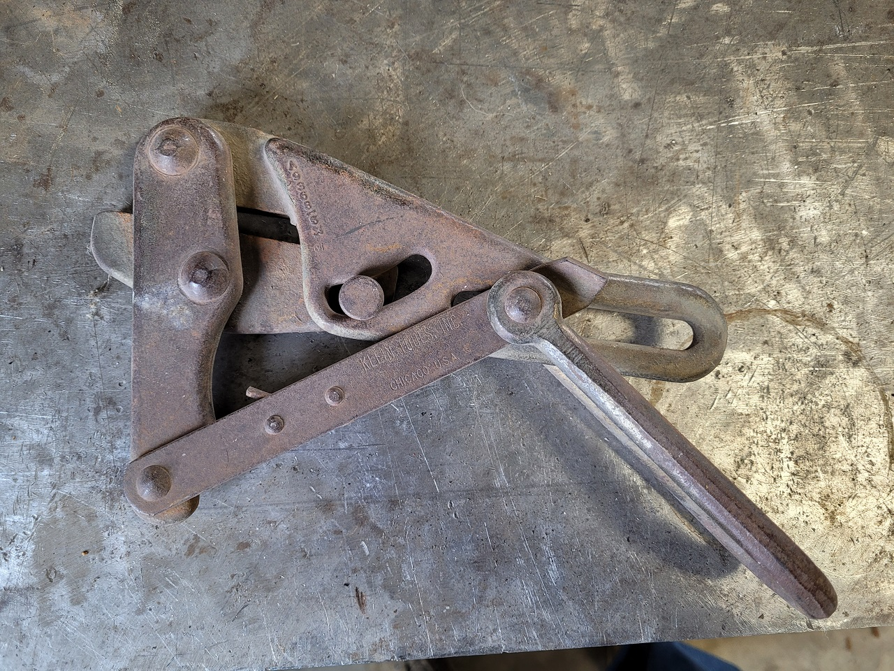

John Deere 4520
Dad used them on the farm and I forget what for and how.
I know they “slide” open and then grip something.

I have several of those laying around that dad collected. That's a single use item for sure.
/ What might this be? #5
Cable puller
I have 2 in my truck
The garage door industry uses those quite a bit
/ What might this be? #6
If you found it on a farm, they were pulling barbed wire with it.
Some people use them to pull woven wire fence, but, you need several of them,
I have one, it is connected to a sledge hammer handle, hook it to the fence wire, pry around a post.
/ What might this be? #7
Yep, use them all the time for wire pulling and fence repair.

/ What might this be? #9
I've had this one for years. Don't remember where I got it. Probably a farm sale.

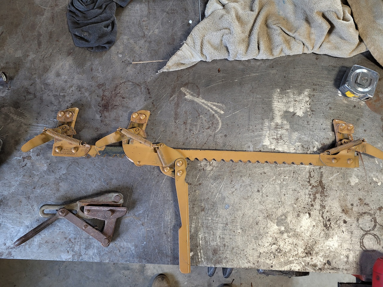

Fasten a come along to it and you have a fence wire stretcher.
/ What might this be? #10
Here's a more modern version that works great to tighten and shorten fence wire.
/ What might this be? #11
Yep, cable puller!
Another of my yard finds and, YES, I've used it 5/6 times even once to tighten a sagging power line for a client.
Can also serve to place tin roofing B4 attaching. LOL, works better than vice grips.
Think it was another of my $1.00 or so, garage sale buys.

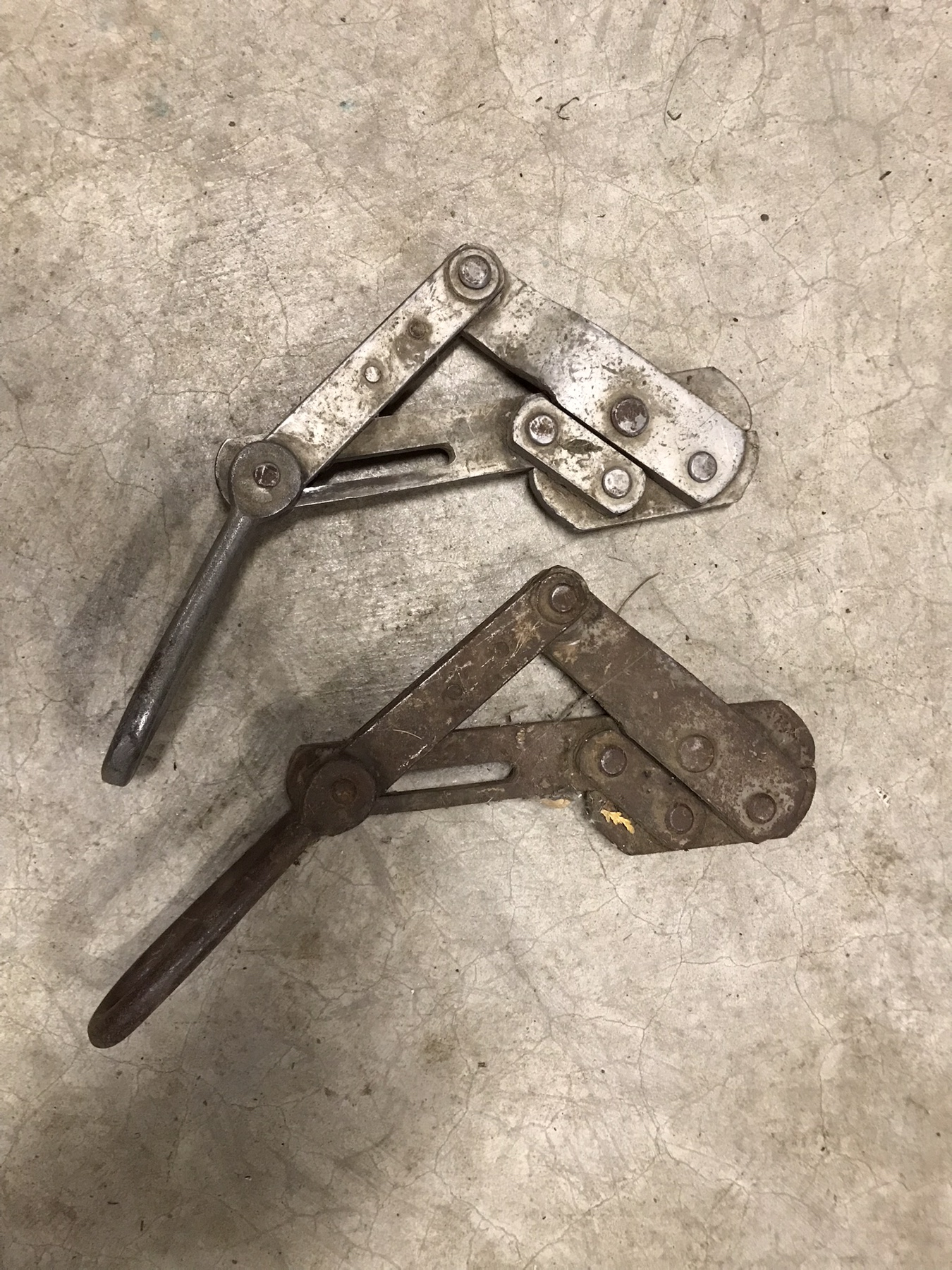

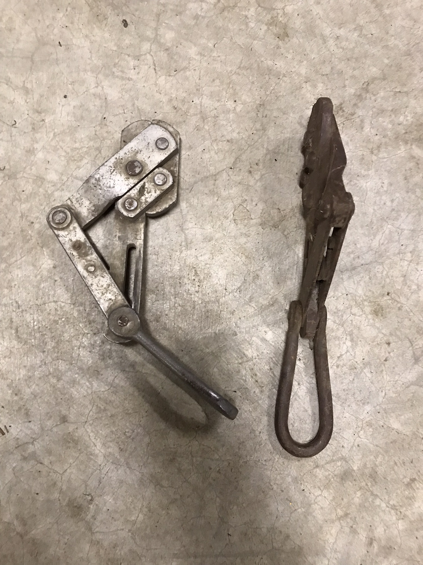

Ive had one for years that was my grandfathers. He used it to pull wire while he worked in the communications sector of the railroad. This was when they still used the poles and wires along the tracks. He retired about the time they phased that branch out due to using radio communications.
My son used it to put up his zip line in the woods.

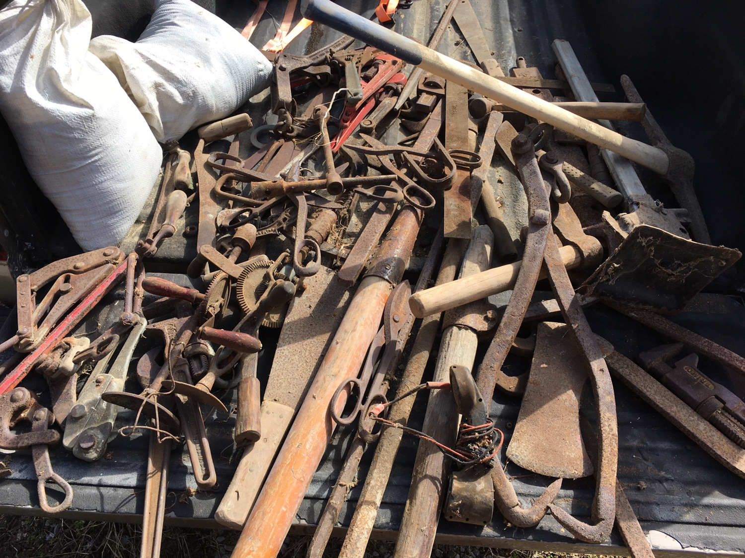

I am currently cleaning out the barn of my great grandfather and great uncle. Hasn’t been touched since 1986. If you look in the lower left of the pic you’ll see about 5 of them. Different sizes and styles. This is just one of the loads Ive pulled so far.
/ What might this be? #14
It’s A temporary grip to pull up utility wire using a chain hoist or rope blocks attached, most are made by Klein or Buckingham. Different sizes and jaws inside for different wire., Copper,steel, aluminum, poly covered. Us lineman use them everyday and nothing much has changed on them in the last 50 years it seems if you clean them up the should have the wire sizes stamped In them somewhere

Lots of memories. My great grandfather passed when I was 12. I remember him well, he was a bridge foreman for the railroad. Some of them will be wall hangers. A lot will be fixed and used.
Nothing had made in China wrote on it

I've got one of the small ones, like in the bottom left of Alan's pic above. It has teeth in it for grabbing bare tension wire for fencing. I think the ones with the long smooth jaws would be for pulling electrical, so it won't damage the insulation or strands.
