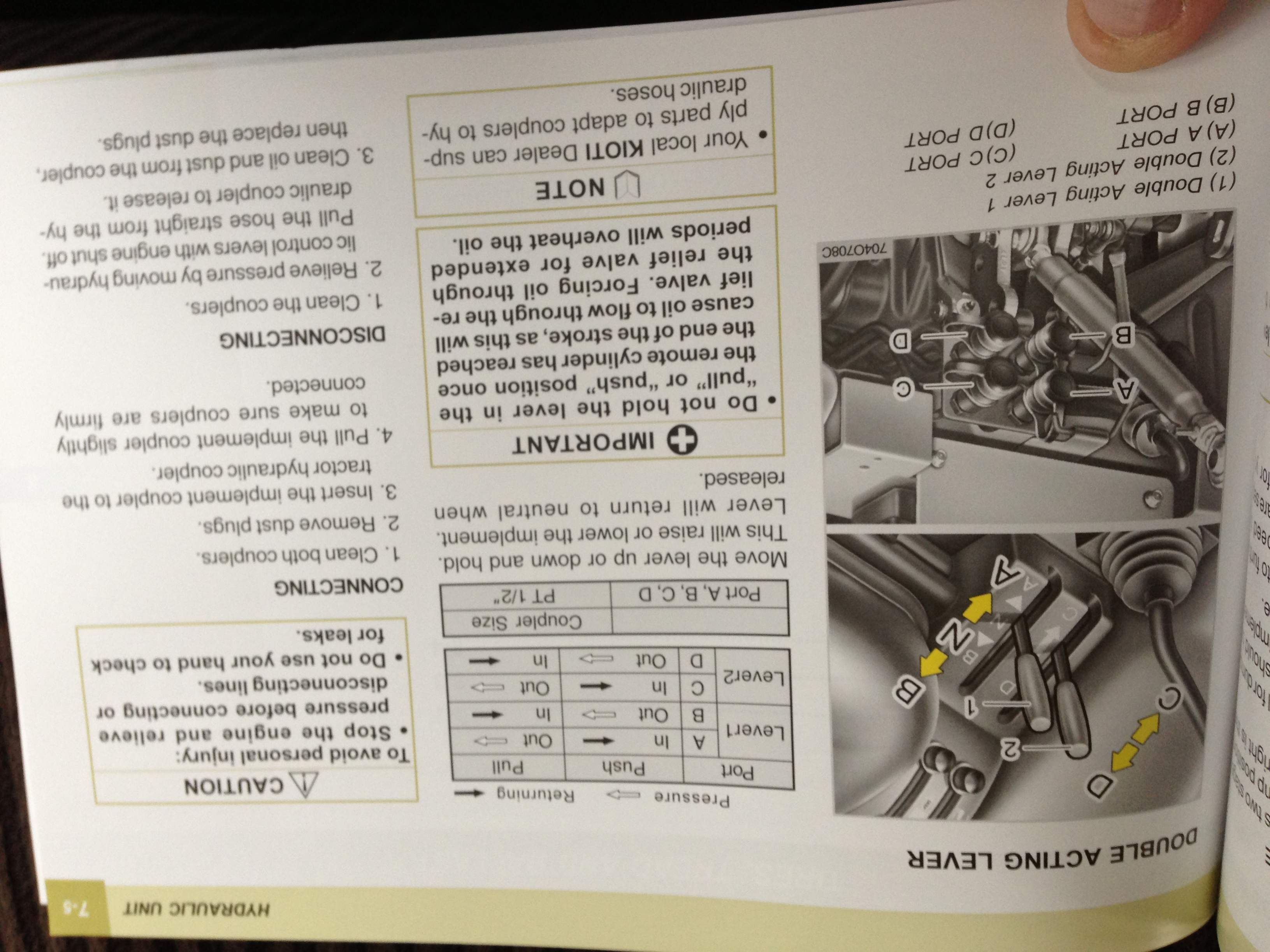

Here is a picture from my manual about the remote levers. In the illustration it doesn't show the float on the "c and d" lever (I have it). It also says the levers go back to neutral when releasing them. Only my c and d lever returns on its own. A and b lever stays in the position until pulled back

Might be certain years?
