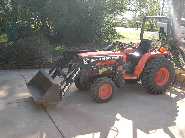

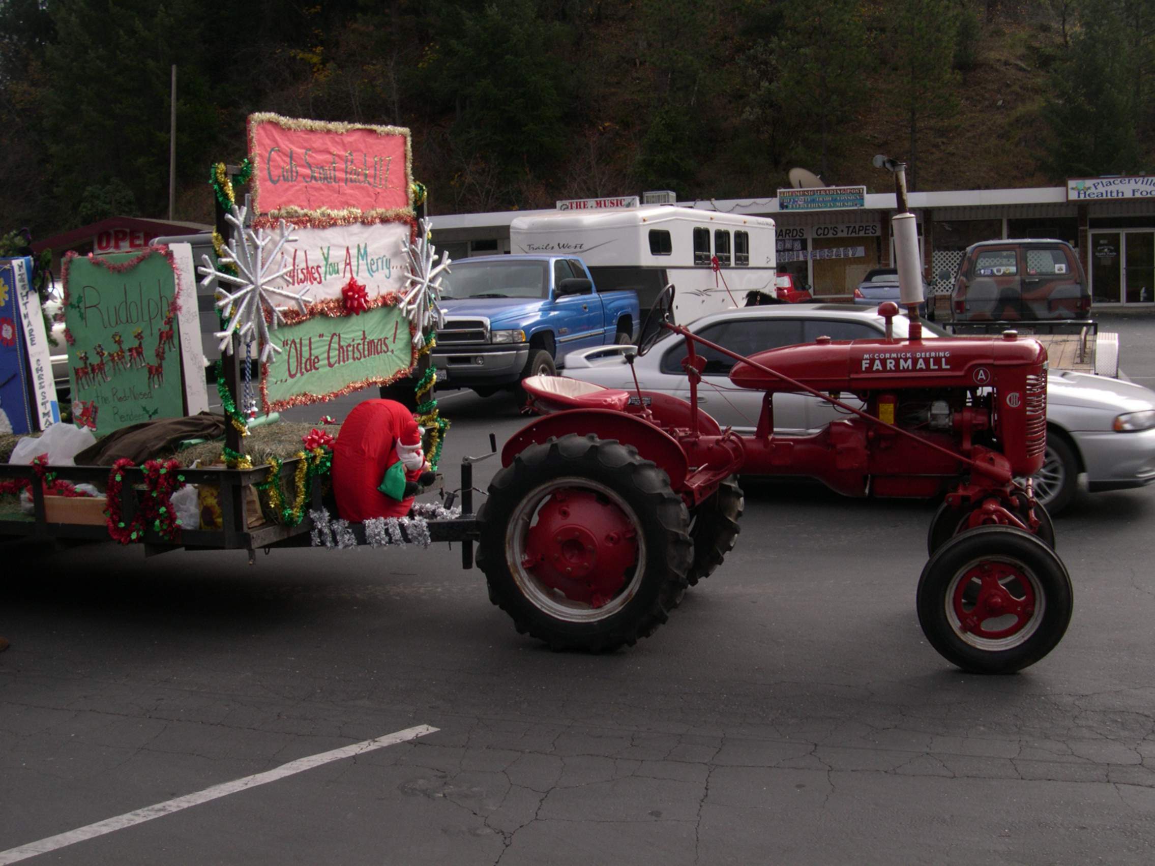

Gas can last a long time. My comparison would be the 1941 Farmall A, and Kubota B8200 I used to have. Both were in the 20hp range, and had similar torque curves.
The Farmall motor was about 2x the displacement of the Kubota diesel(113ci vs ~56.6ci from memory).
The Farmall motor red-lined at about 1600rpm(again, from fuzzy memory)
The Farmall motor used more gas per work unit.
After having that old tractor though, I bet that low rpm low compression motor would run forever, if maintained properly.
The biggest thing that stood out to me with that tractor was the 2x displacement vs the diesel.

<img src="http://www.tractorbynet.com/forums/attachment.php?attachmentid=291196"/><img src="http://www.tractorbynet.com/forums/attachment.php?attachmentid=291195"/>
I just love those old Farmall's.
