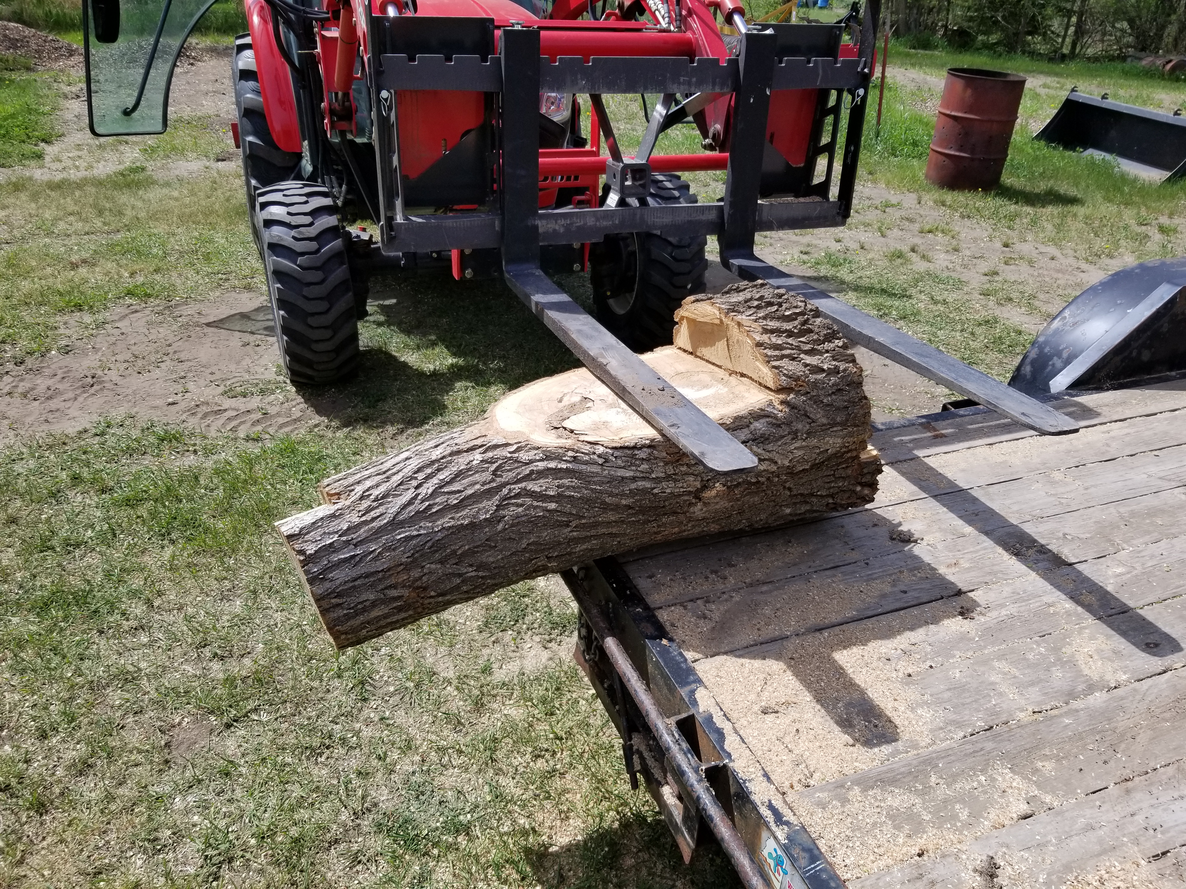

Lou is right. There are so many options to choose from for forks. My strongest recommendation is to go with a dedicated set of the SSQA forks, and not the clamp on bucket forks. I started off trying to be cheap with the clamp on forks, even though my dealer, and many good folks on TBN tried to talk me out of it. They were right. The clamp ons are just terrible, and only if you were stuck with a pin on bucket would you even want to consider them.
SSQA mount gives you the freedom to pick a proper fork set, and you'll be much happier that way.

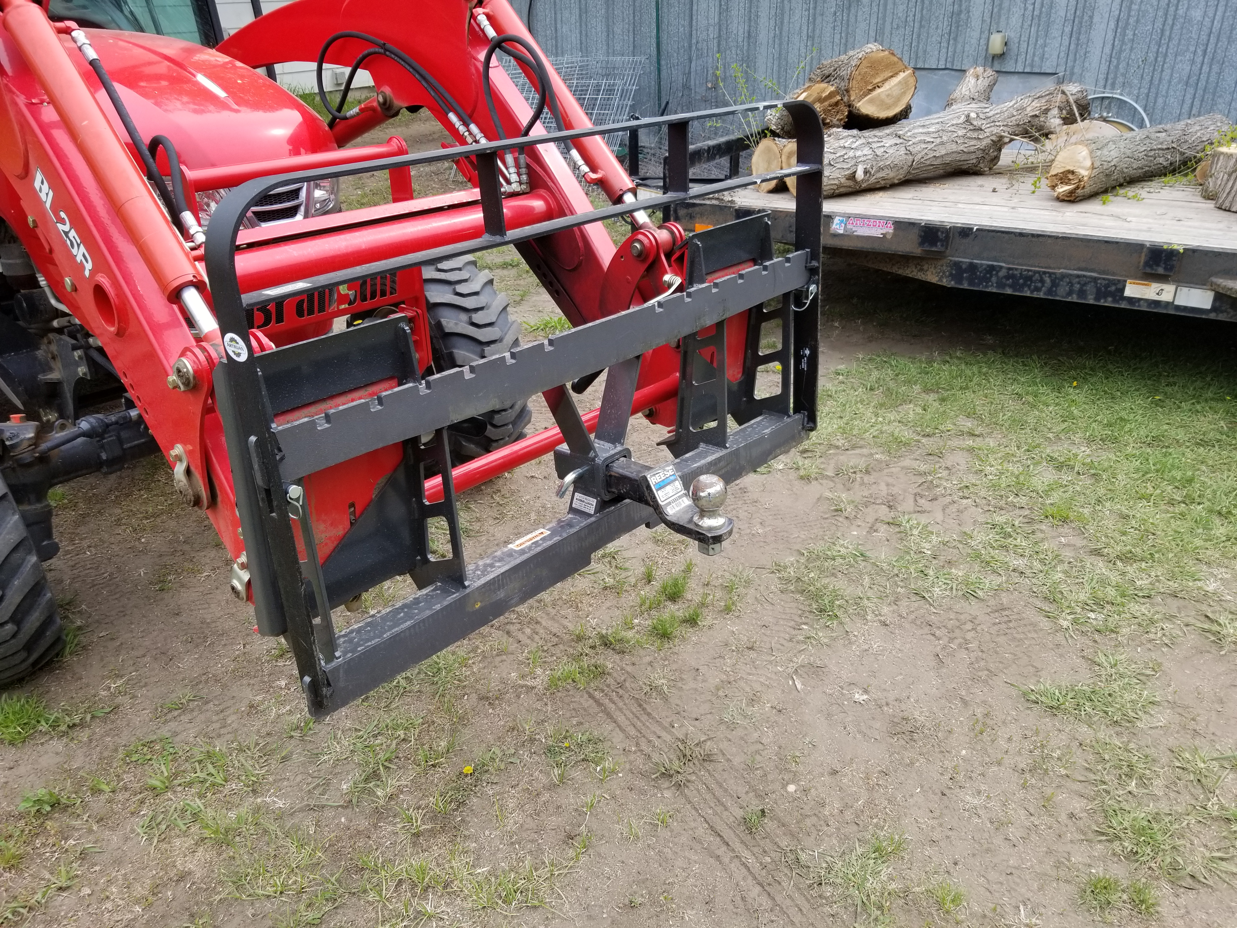

I went with the Artillian setup, but I was really interested in their modular frame system that lets you add other attachments down the line. Like a grapple or stump bucket. It's certainly not the cheapest option (by far), but I liked the idea of the added versatility. Due to the lift capacity on my FEL, I went with the 3000 pound rated frame and 48" heavy forks.
I use mine for all manner of things that don't involve pallets.
The 3000 lb frame comes with a receiver hitch tube welded into the center of the frame. I use mine to move trailers, but Cougsfan (member here) suggested that if I flip the ball over on the hitch, it will make it easier to see the hitch to line up the connection. I still have to try that.

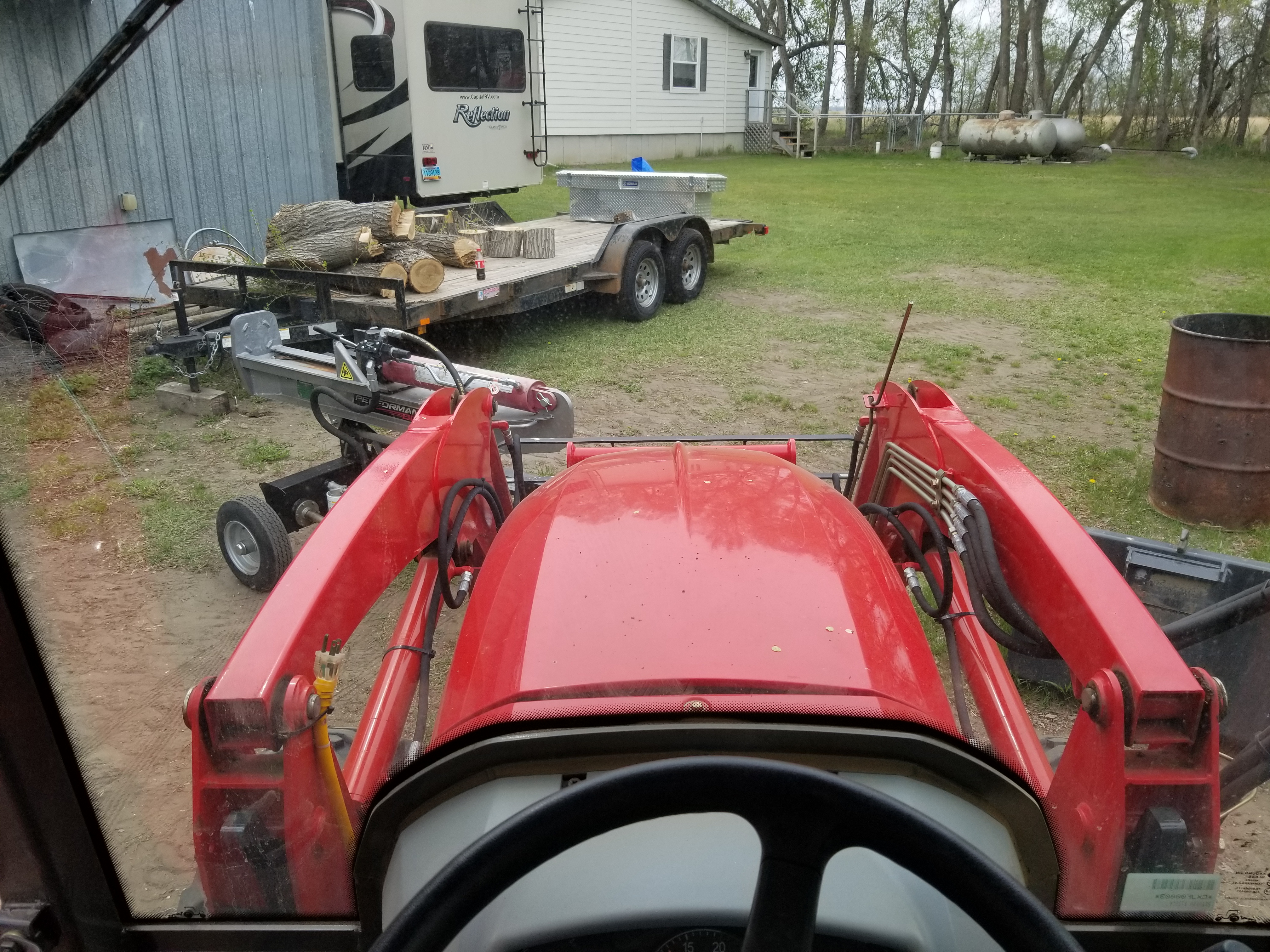

And this is the view from the driver's seat when trying to line up the shot into the hitch (without flipping the ball mount over)
