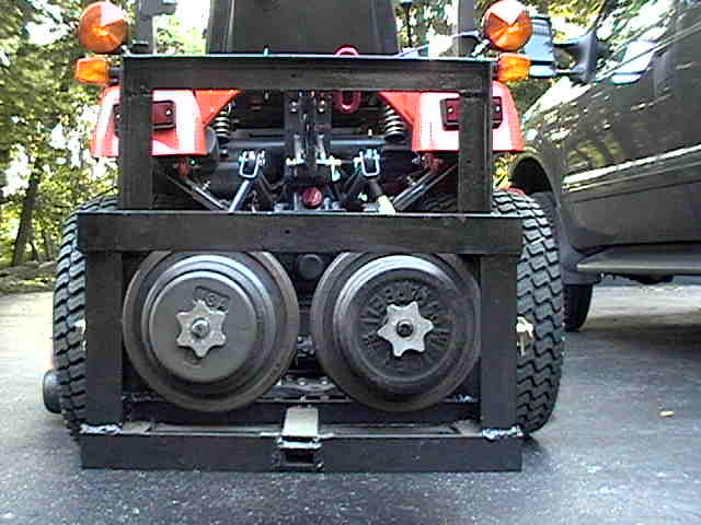

I use a 3 pt box on my 1500. That way it's easier to remove it and the FEL when I'm cutting the grass. Here's what I made out of some angle iron I had laying around. The weights and the rods they slide onto were picked up real cheap at a garage sale.

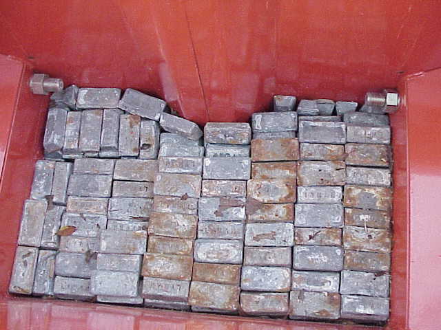

I have bar tires filled with Rim-guard (beet juice) and today I mounted the Kubota weight box. When I sold my old tractor I gave the guy the weight box, but removed the weights... I had to find a place to put them, so I put all 500 of them into the Kubota box. I think that I have sufficient weight back there for any front end load... 506 bars X 1.25# = 632.5 lbs. Feels strange not having the backhoe on the tractor. /forums/images/graemlins/ooo.gif
