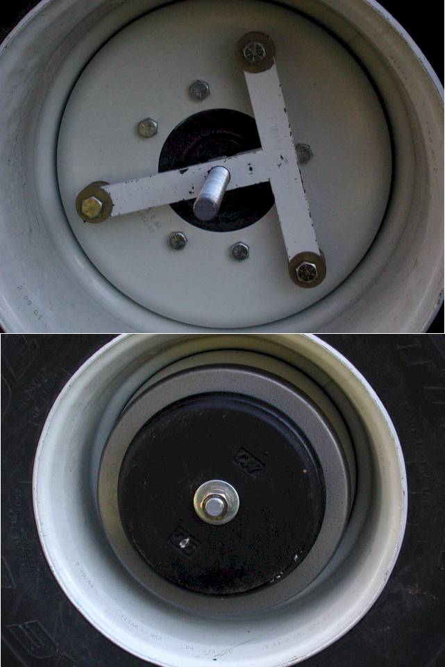

Accordionman good for you. You made a set of weights and saved some bucks to boot. Do you have a picture of the set that we can see? I would like to see what a tractor that is pumping iron, looks like. /forums/images/graemlins/wink.gif
   / What rear weights do you have? #18
Here's what I use on my New Holland TC25D. Another TBNer, 5030, aka Daryl Davis, welded up the brackets. The R4 wheel for my tractor is a bit unusual in that it only has 3 accessory attachment holes. The New Holland Ag tire wheel has four holes, as do most others.
I bought four 50 pound weights at Dicks Sporting Goods, added in four 25 pound weights I already had, for a total of 150 pounds on each rear wheel, the maximum New Holland recommended. Made a huge difference in traction for plowing snow and made using the FEL much safer.

Mike that a real nice piece of work. It also makes better sense to me as you can quickly and easily add or subtract weight from your rear axle as the need dictates. /forums/images/graemlins/cool.gif
I'm curious though, since you do not use liquid ballast in the tires do you use any type of tire sealant to keep yourself from getting flat tires in the field?
   / What rear weights do you have? #20
<font color="blue"> do you use any type of tire sealant to keep yourself from getting flat tires in the field? </font>
Nope. I have not had a chance to use them in the field, since I put them on, after I brush hogged for the last time this fall. When I put the weights on, I increased the air pressure to near the top of the recommended range.
