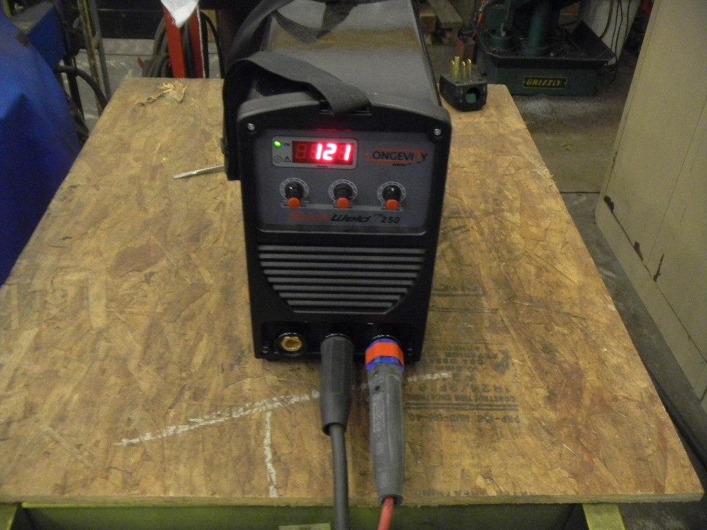

I have an Everlast PA-200, and I have run one of the members here Longevity Stickweld 250. I also have a Lincoln V350-Pro. All inverters, I would suggest Everlast PA-300, or Longevity's Stickweld 250 because both have adjustable hot start, and arc force like my Lincoln V350-Pro. Even though I'm a hobbyist, I' am a little old school, these inverters just amaze me with the control they have over the puddle.:cool2:
