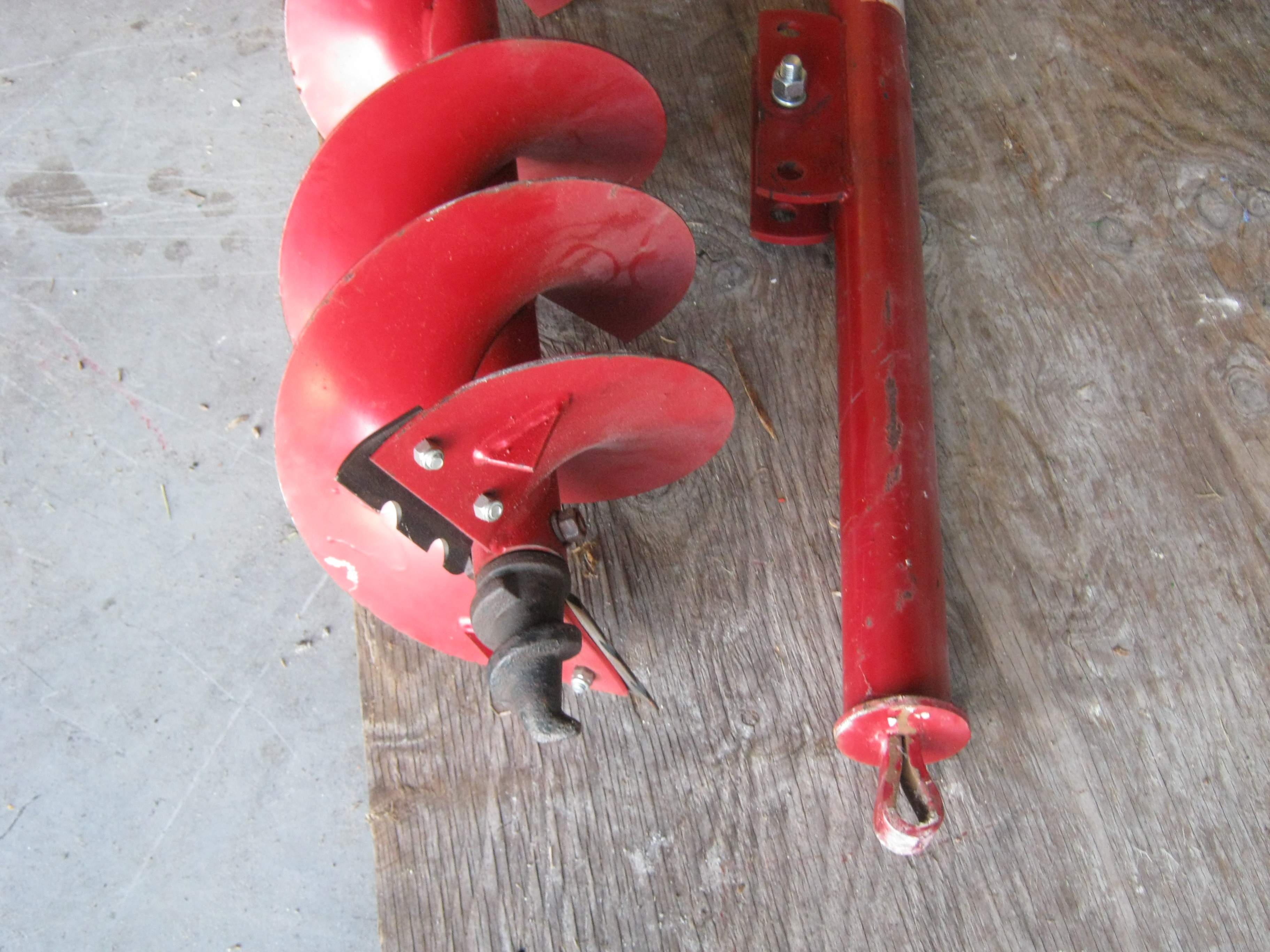

   / What size auger do you use? #16
12" for me also
