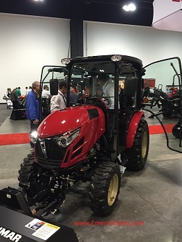

Check out the Yanmar YT235. One of the nicest cabs on the market. Mid PTO to power a front blower, three range HST, cruise control, auto throttle, really nice machine.

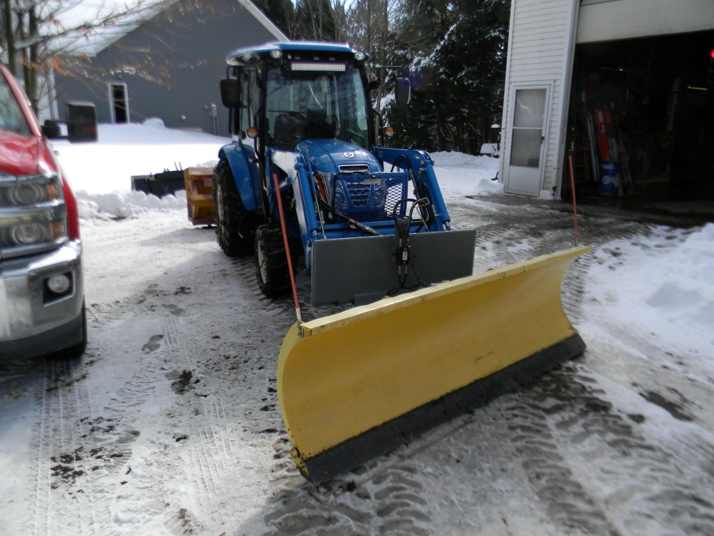

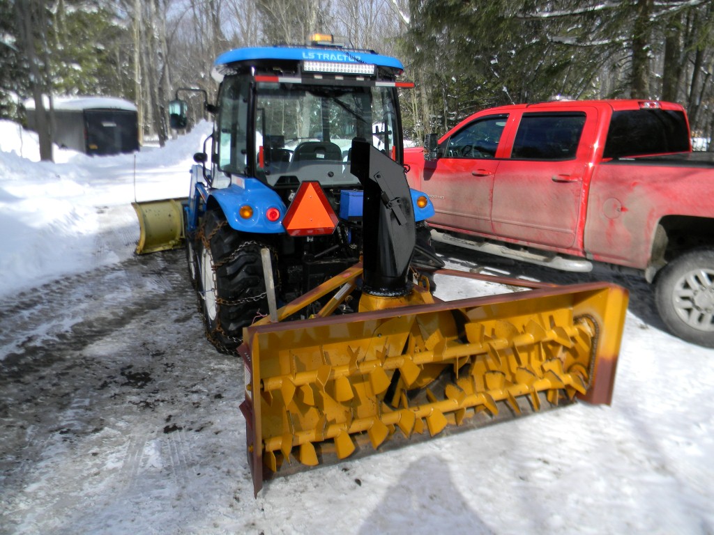

I will be looking for a cab tractor in the 30-35 HP range with low hrs to mount a front snow blower & 6' blade in the winter and a 5 or 6 rear finish mower or bush hog to maintain an over size lawn/foodplot. Any suggestions on blower size and/or tractors ? Want to stay away from newer tractors with def fluid. Driveway is approx. 1700 feet long and I will be retired so I will be in no hurry. Right now I use my truck but do not want to beat on a truck when I get my next one with the drifting. Snow blower and rear blade will be my best bet. A cup of coffee,just a sweatshirt and tunes playing is the desired effect .LOL
First of all, I hope you're going to have pants on with that sweatshirt and coffee. LOL
For blower size, general rule of thumb is you need 5HP per foot of width so attachments will usually be in the 6-7' range.
I don't know what your budget is but take a look at NEW LS and Kioti brand tractors. LS sells a front blower, not sure but imagine most others do also. I don't think I've ever seen a used tractor with front blower for sale. Front blowers are expensive.

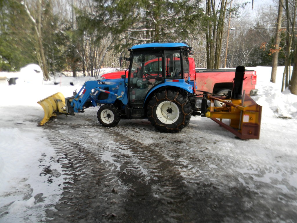

I've been very happy with my 36HP cabbed LS XR3037HC. Easily plow and blow snow with my coffee, tunes, and FULLY CLOTHED but no jacket or gloves needed. I run a used 7 1/2' truck plow on front and a 7' Lorenz double auger blower on the rear.
